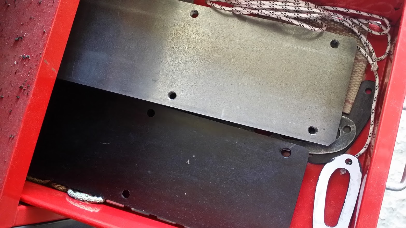

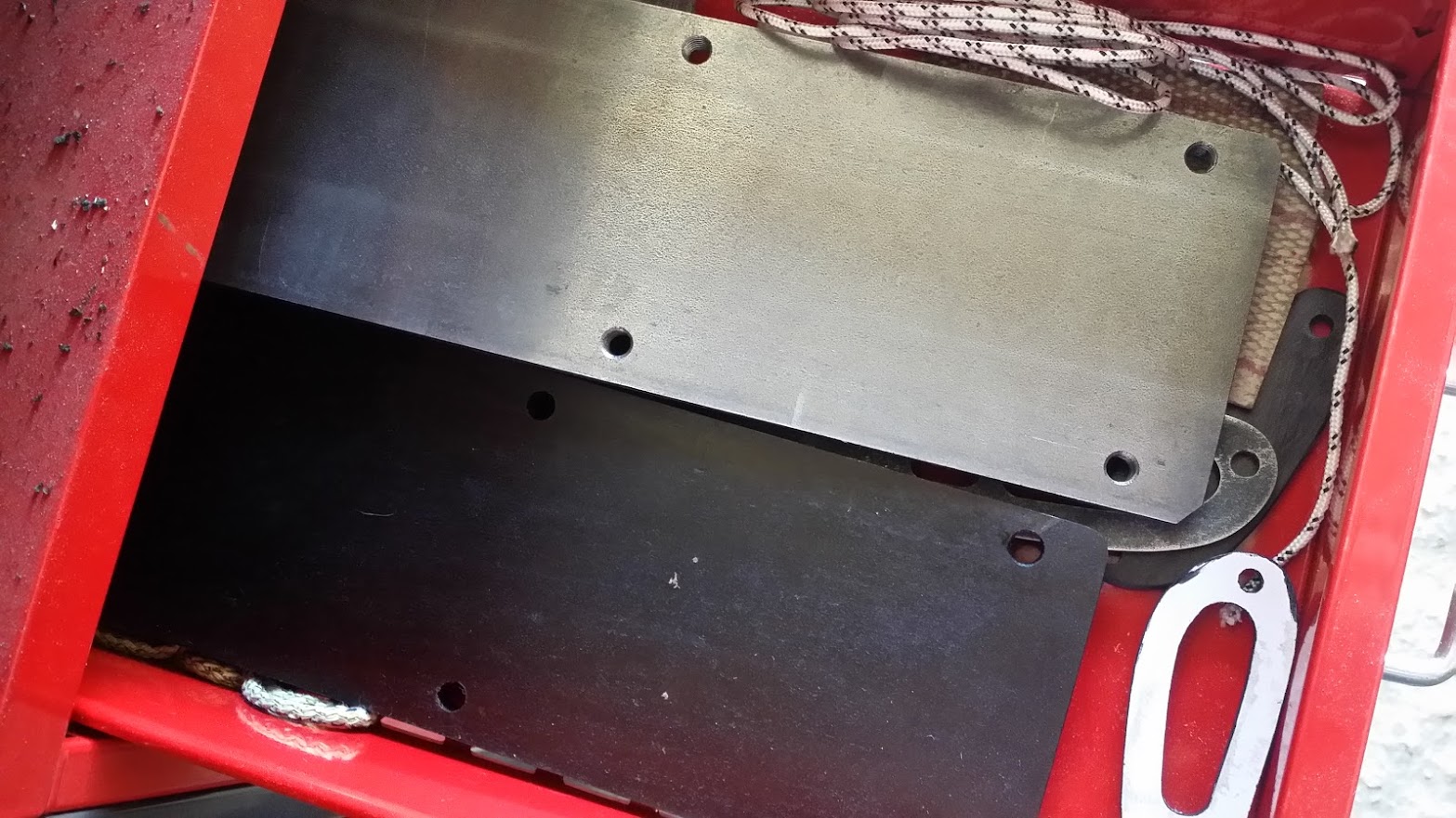

    Quote Originally Posted by toomast View Post
    What do you mean by that?
    There is a way to treat low carb steel / mild steel/ . You heat it at 315C, keep it there a couple of minutes, thin oxide layer forms in black, then you brush it with some oil and it goes even blacker. Result is much tougher part, even if not a high carbon steel. Black oxide layer is not real anti rust though it gives some protection
    bellow you could compare bare cold drawn steel bar and treated.
Name:	cold drawn steel.jpg

    Interesting. What is the "official" name of this process?
