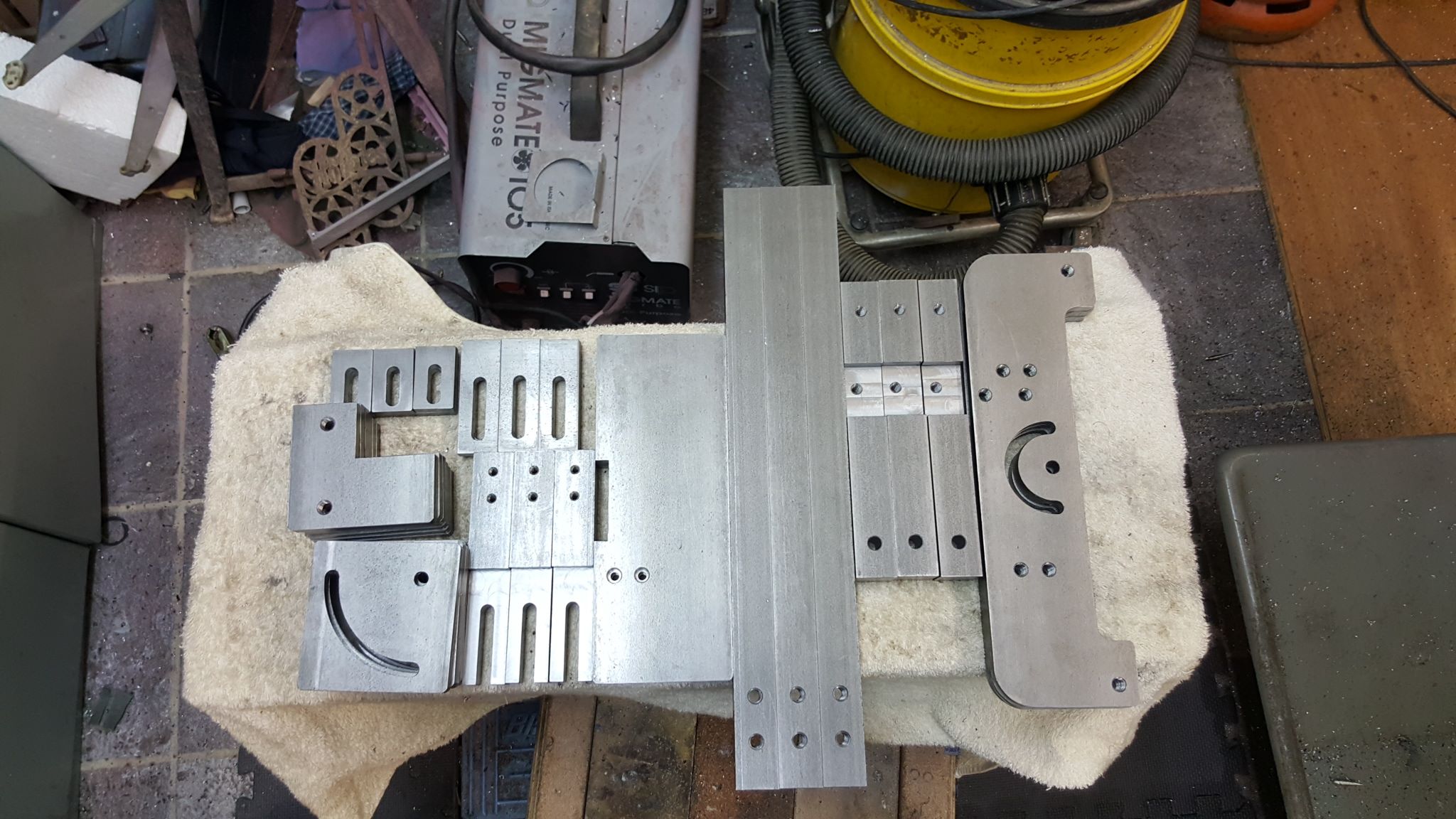

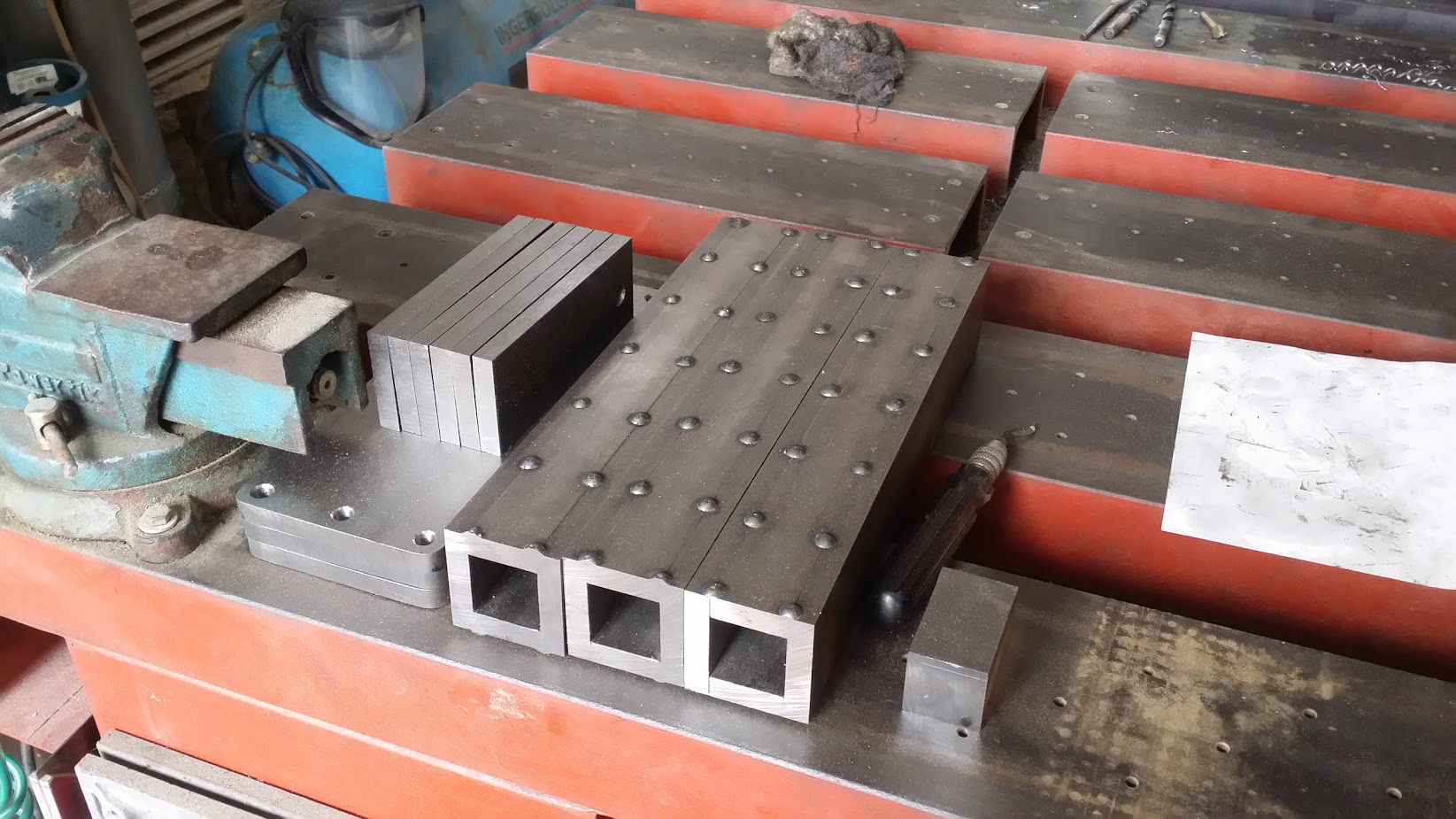

    Some update with pictures. I am actually making 3 machines, one for me, one for Jeff/ fellow forum member and friend, that lives around/ and one for sale. I think of that as prototyping :-)
    Cut the steel and made some pieces:

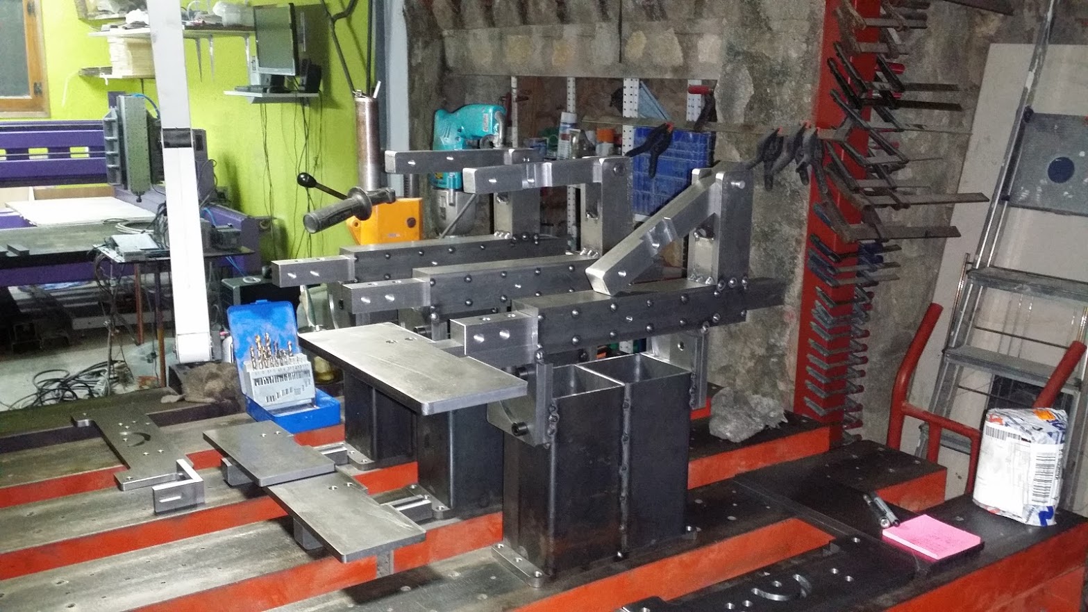

    Jeff cut the main pieces ,that had to be precise, on the mill. In future all will be plasma cut on my machine but as i still have not finished it...
Name:	belt grinder 50x2000 parts.jpg

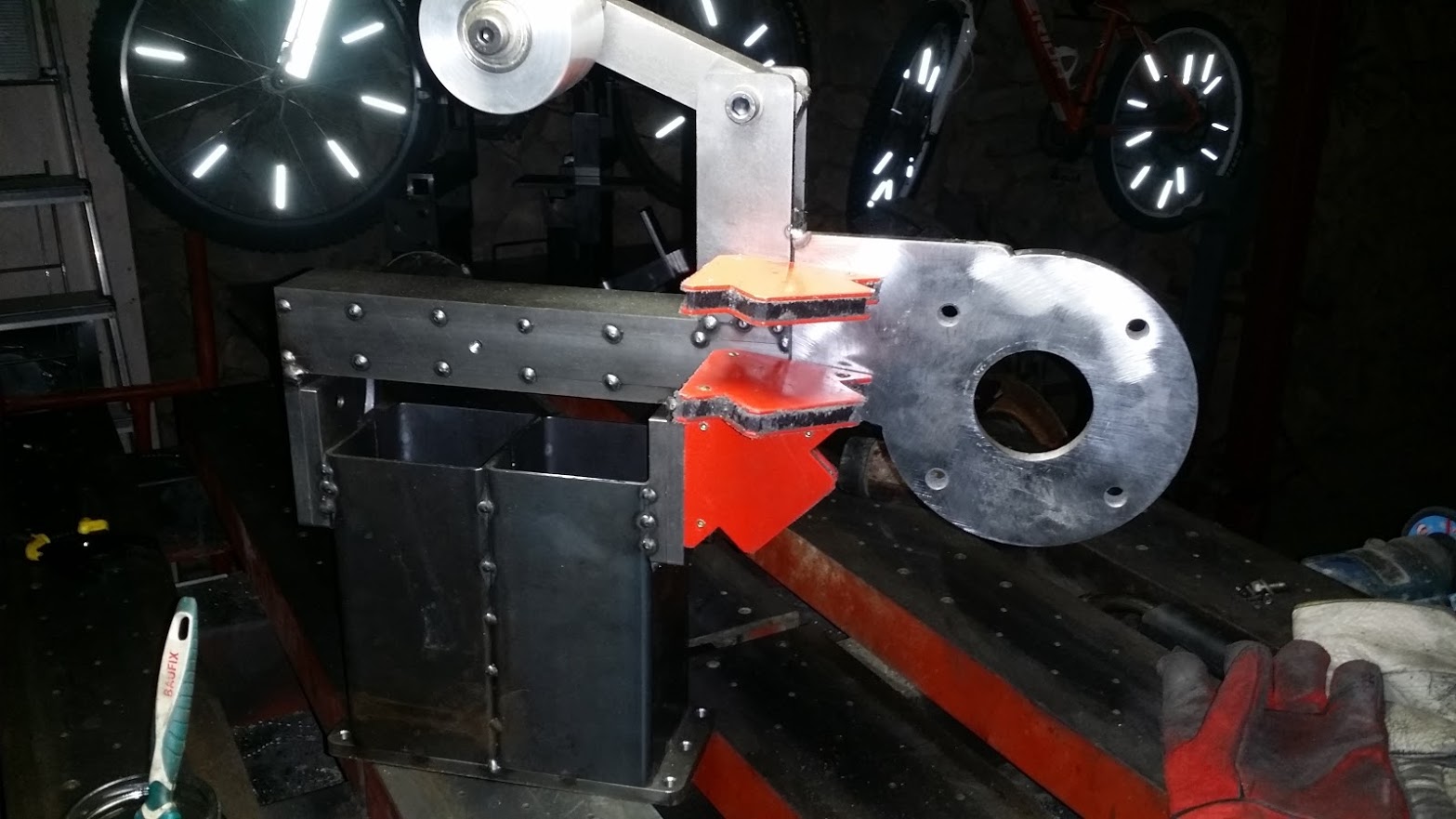

    So i started assembling this and that, welding , sanding and squaring:
Name:	belt sander diy.jpg
Name:	diy belt grinder.jpg

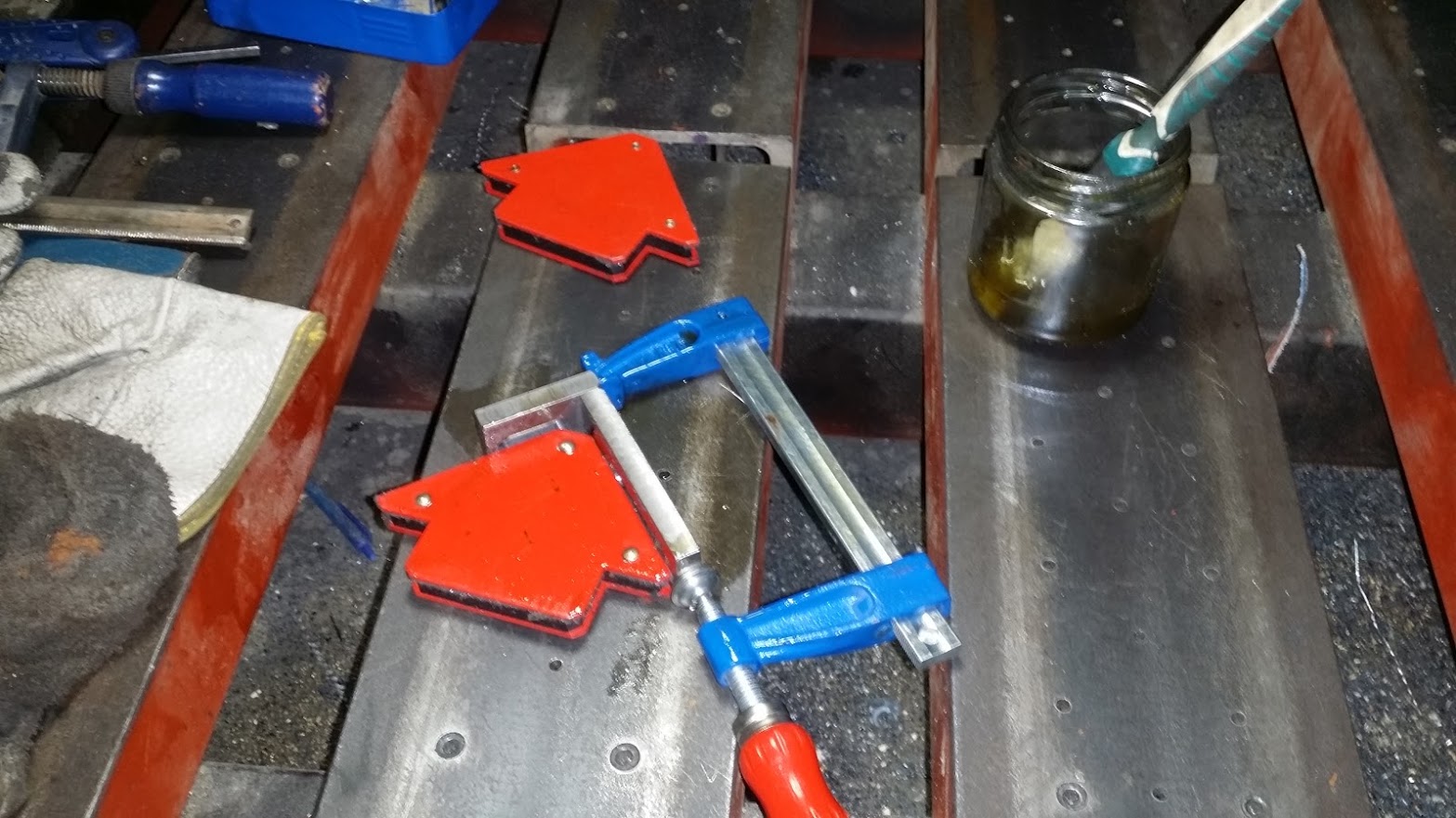

    people go at restaurant Saturday night , instead 22.00h i was still welding brackets yesterday. Yeah, i was using olive oil for protection of surfaces when welding, drilling and threading, so it smelled like in restaurant around here

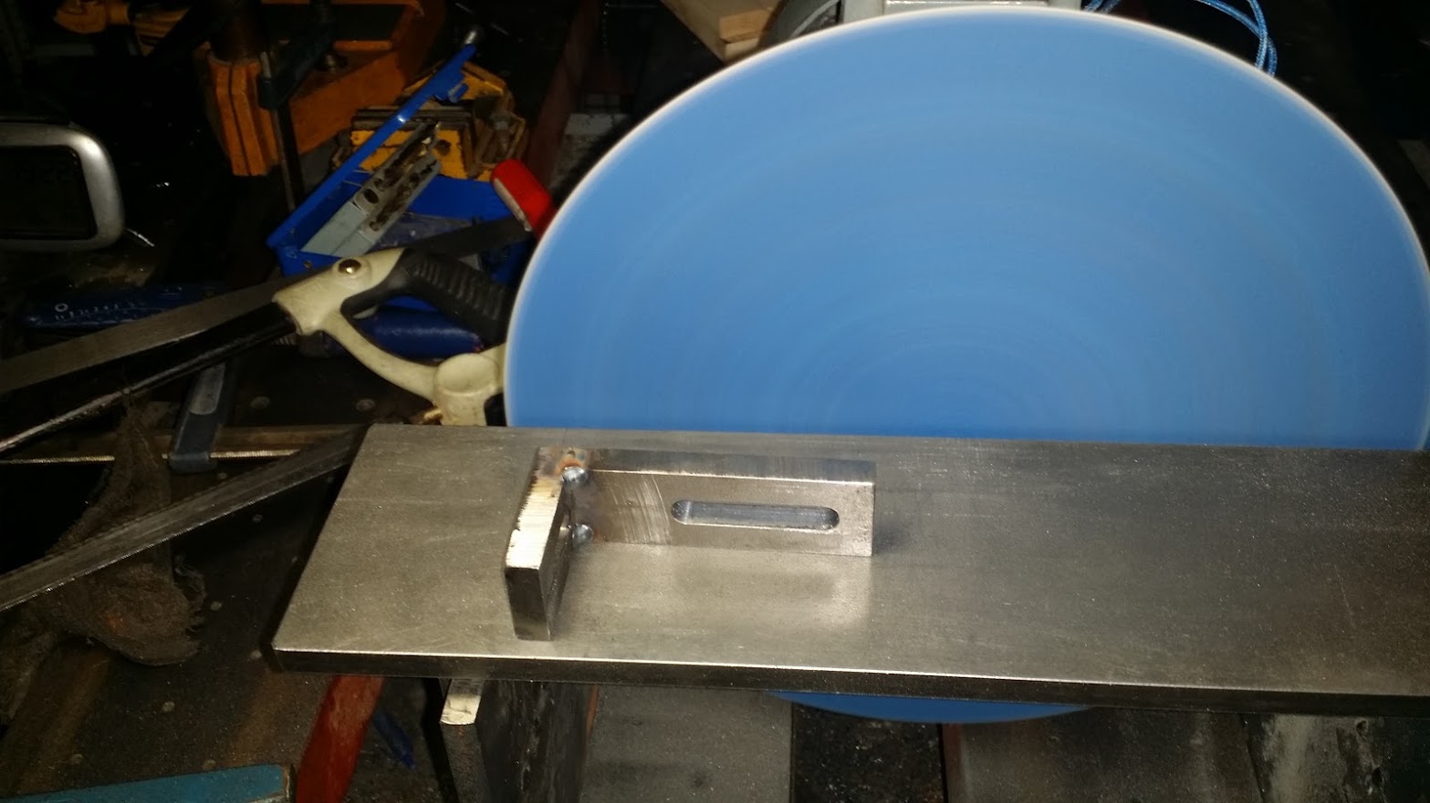

    sanding the bracket on my diy 12" disc sander made from 12" diamond disc welded to the pulley and 0.75kw motor.
Name:	bracket belt grinder.jpg

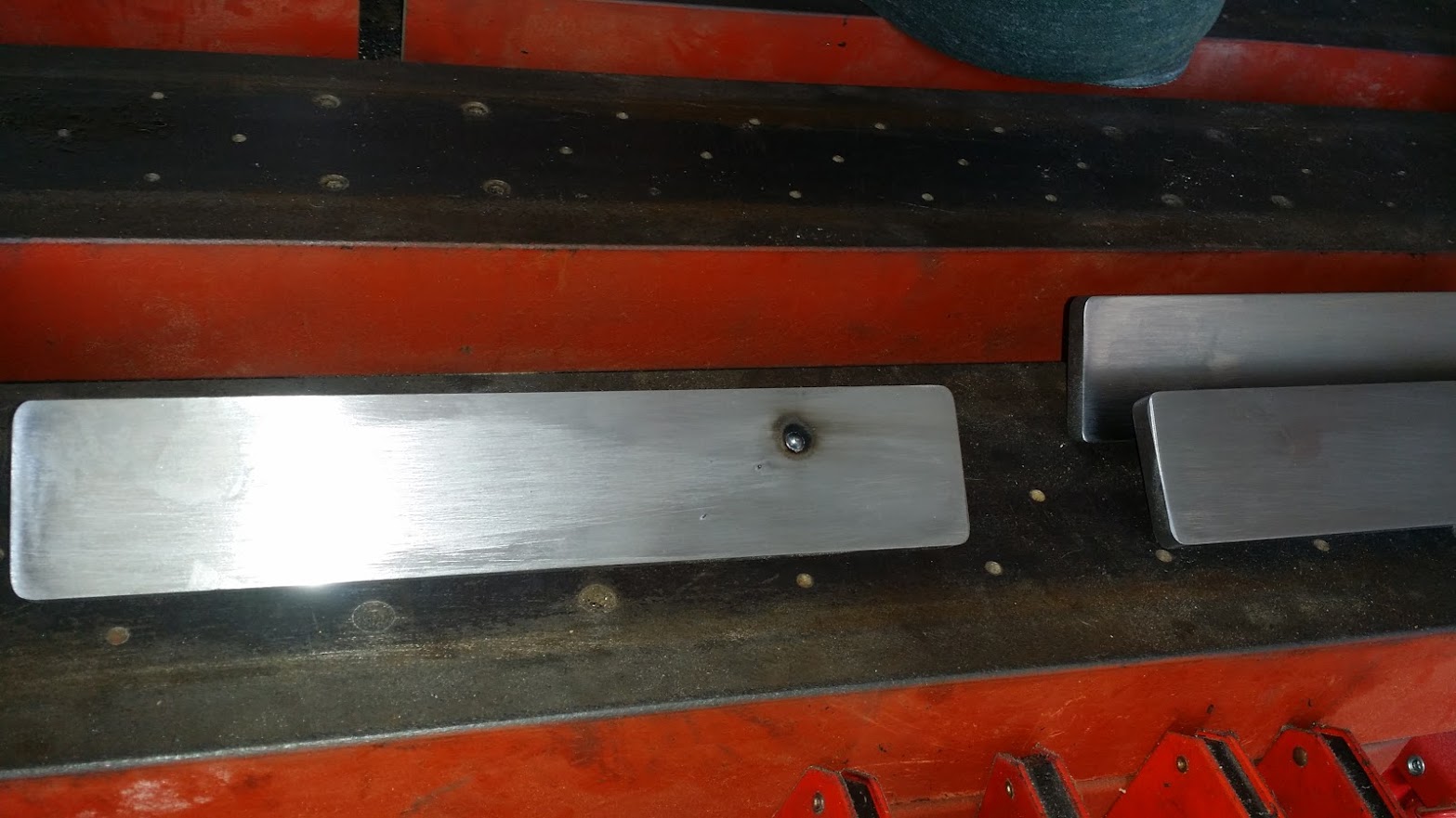

    the plate that goes on the bracket has 2 screws each, one side only, at the other side i sanded the weld and welded again until pits disappeared. not to speak of that even threaded the hole before welding, as i want all to be very precise
Name:	bolts, face plate.jpg

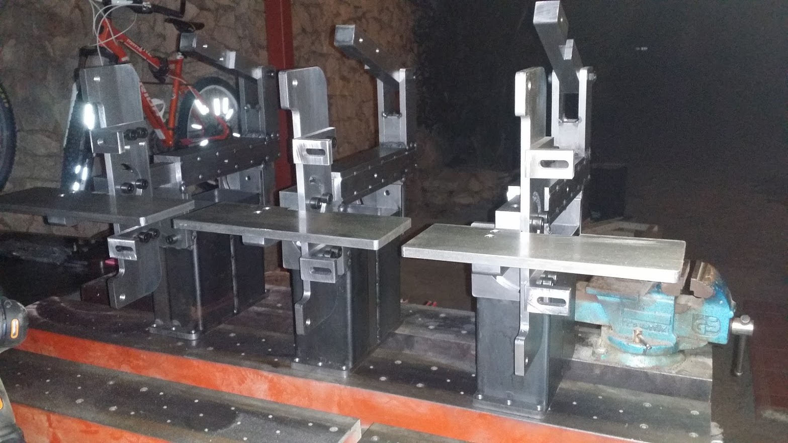

    The machines without the face plates and the pulleys. tomorrow jeff wil bring me the pulleys, bearings and so, so only thing left is motor mounts . Both motors are 3 phase with VFD.
Name:	machines belt grinder prototypes.jpg

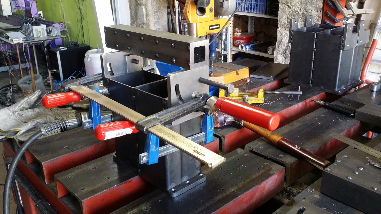

    OK, some more:

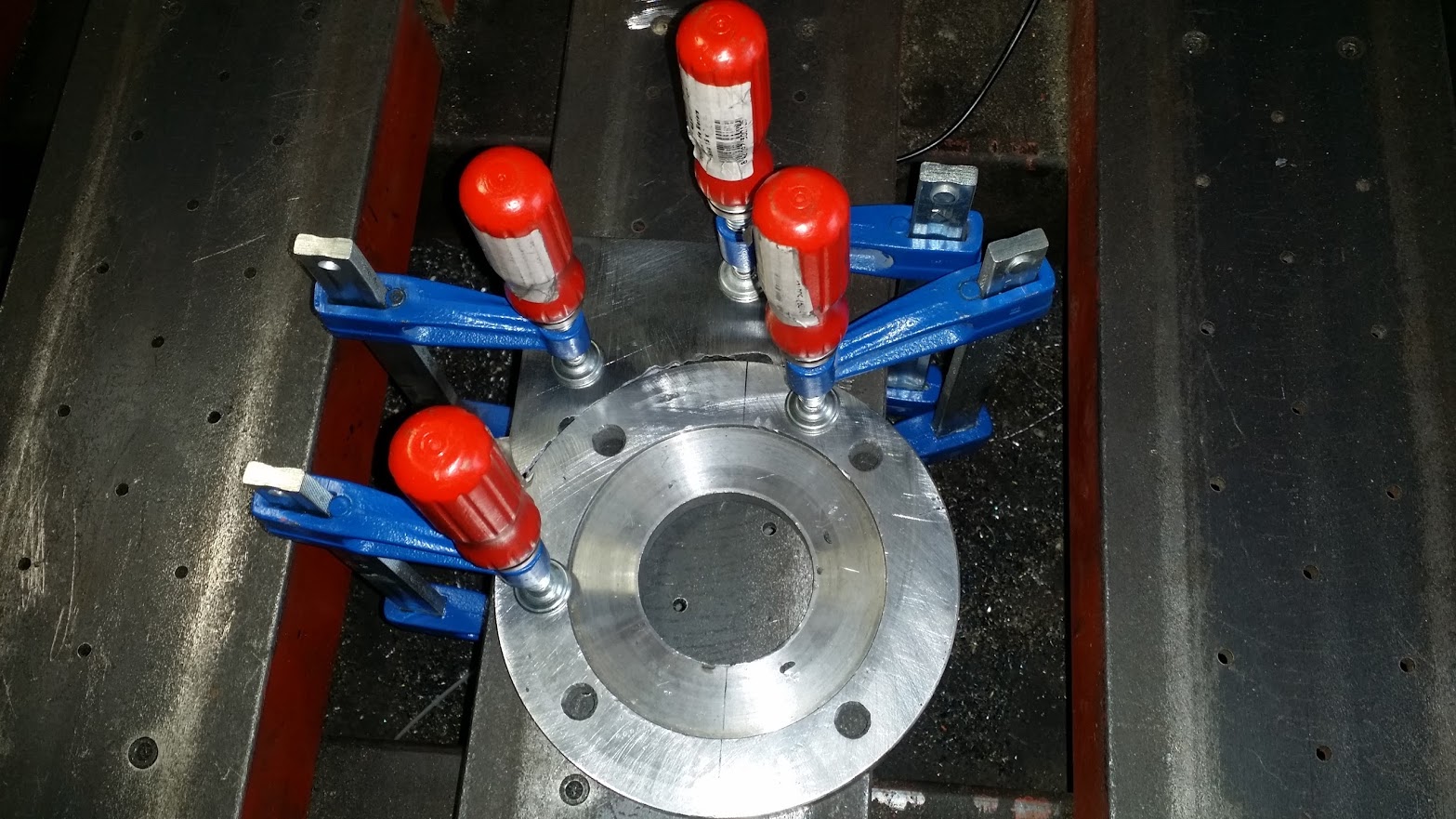

    Welding the motor mount bracket that i cut from the original machine, as i savaged the motor from the junk yard. Clamped both pieces to the table first and then to a bar, then welded very carefully so not to distort the piece, as all wheels must be on one surface flat, otherwise belt will want to go left or right.
    This is or ideally must be a very precise machine. First to be functional at all, then to be quiet and free of vibrations.

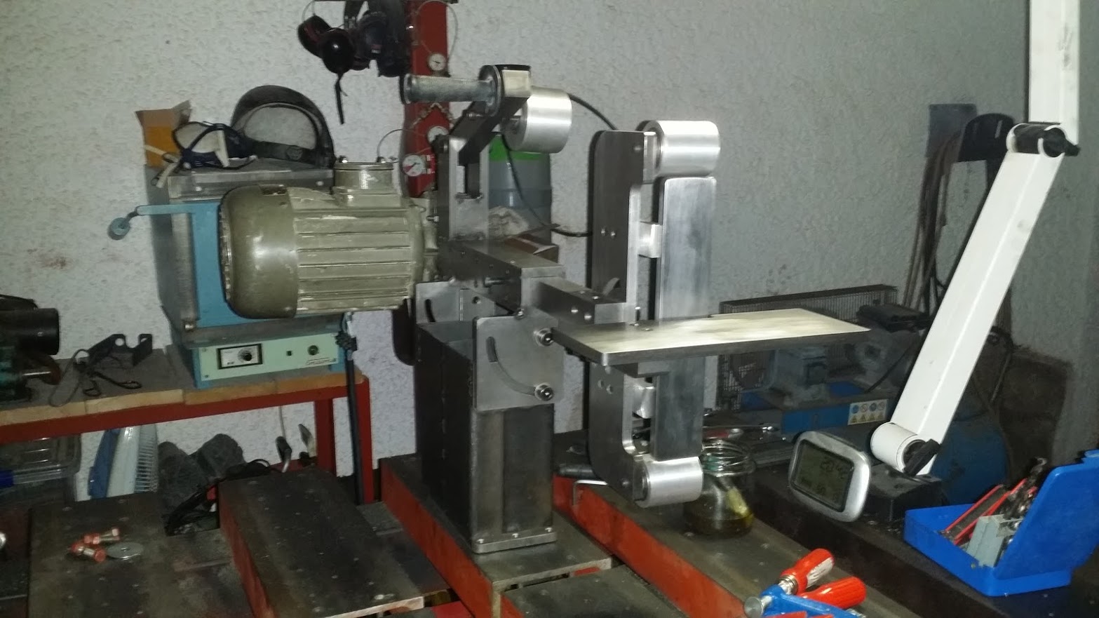

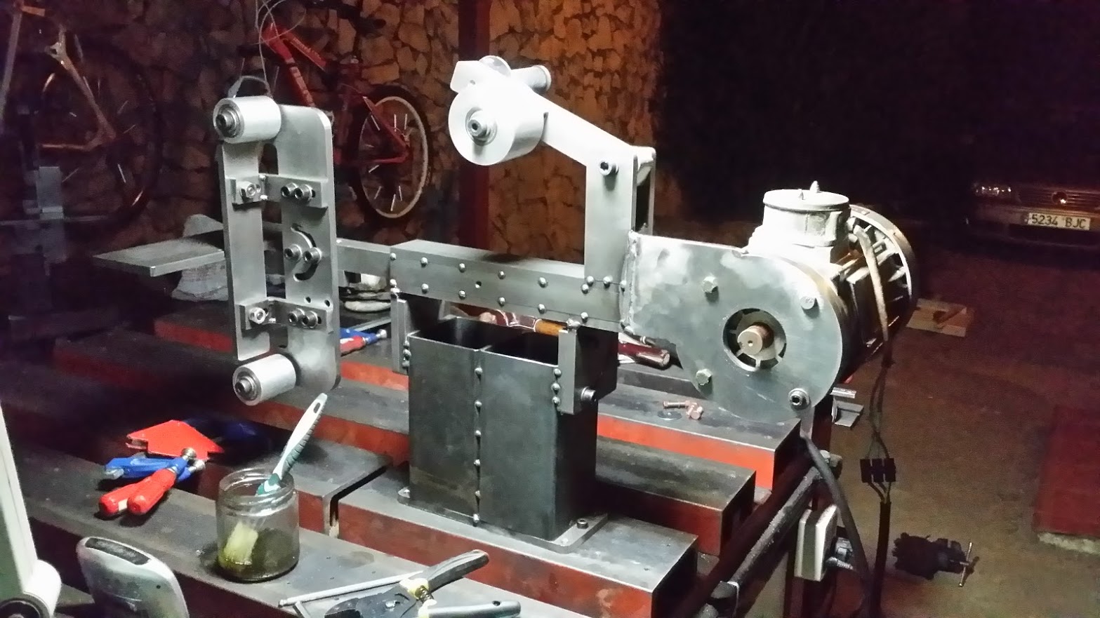

    The belt grinder is meant to be used with using minimum 1.5kw 3 phase 4 pole motor and VFD. Now i had 3kw motor and in the same size and frame,plus Siemens 3kw VFD, so can you guess what happened :-)
Name:	belt grinder  50x2000 prototype.jpg
ID:	17532 Click image for larger version.
Name:	belt grinder  50x2000 prototype fromt.jpg
    Now as i dont have physical grinder to see in real life, judge or copy from, some things are not clear, so instead of finishing all 3 machines i will leave it here and start trying this one to see how it works.
    For example:
    -welding the bracket made so that the tooling arm could not pass through further from the end of the square cage, and according to my calcs there is no need to. The motor bracket and motor are there as i put them there for the reason of when 1.5kw motor its easy to flip machine to horizontal. It could be made more compact but then it must be much higher, so some decisions have to be made for future ones.

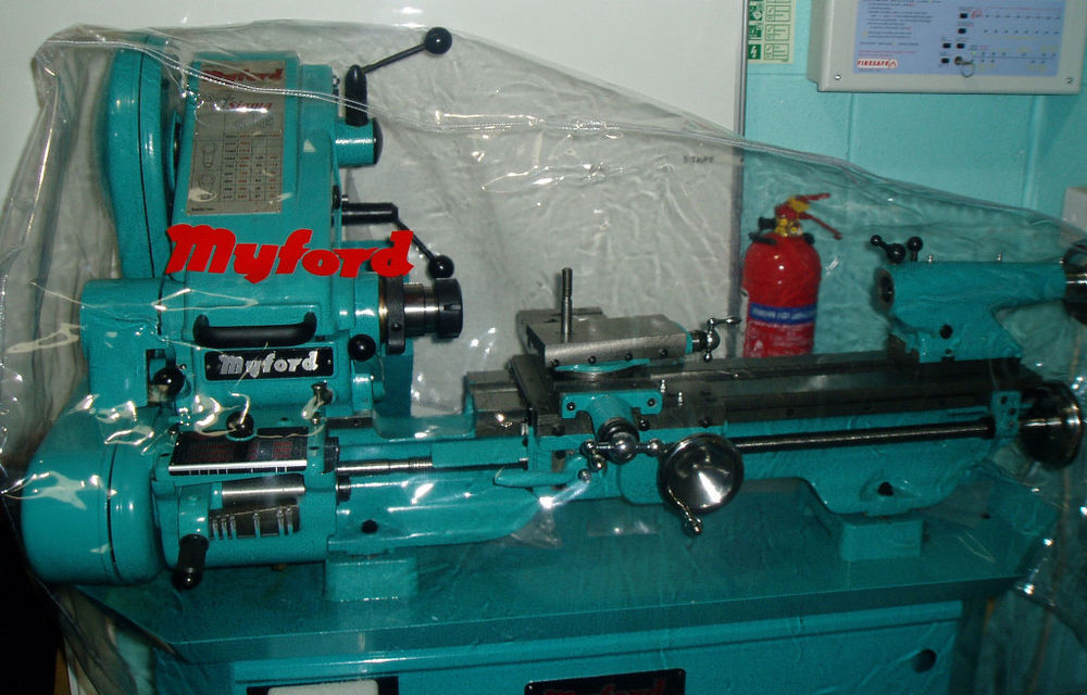

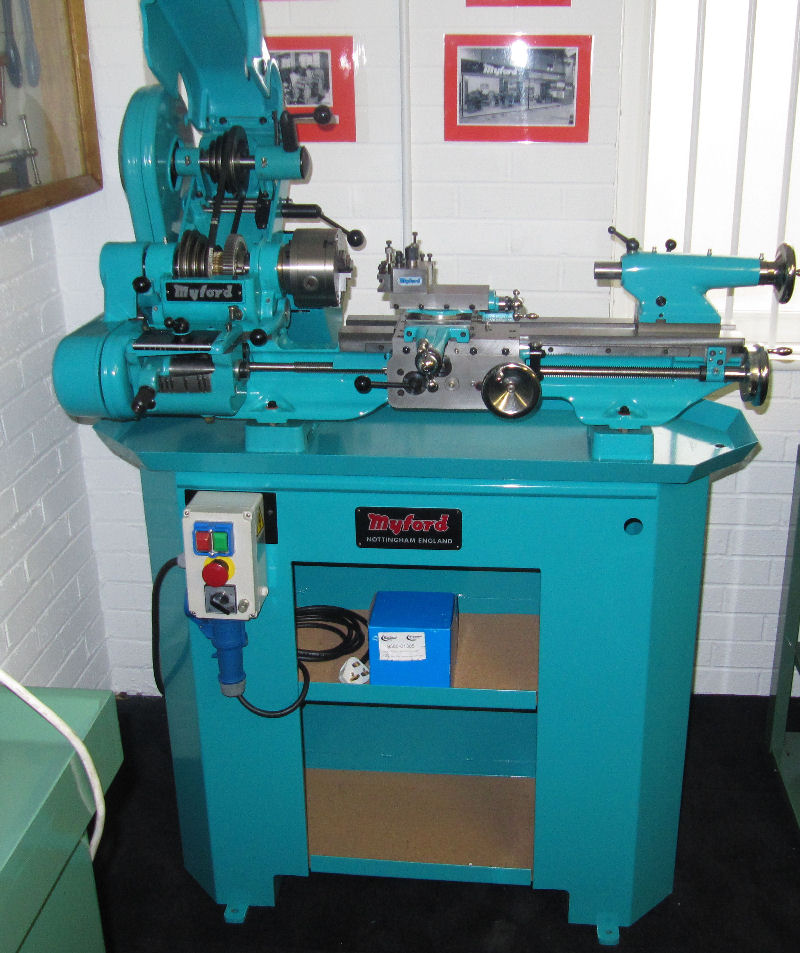

    The paint. Probably industrial epoxy as its the best i could do here. The color is clear though as Jeff like that color, so i decided i would not insist on strange colors. It would be the aquamarine of Myfords and Bridgeport. Does any body know the exact color name or code?
    Asking cause on all pictures they look to have different color/ poor white balance on camera/ . The second one seems right to me on my color calibrated monitor.
    So any hint on the color?
