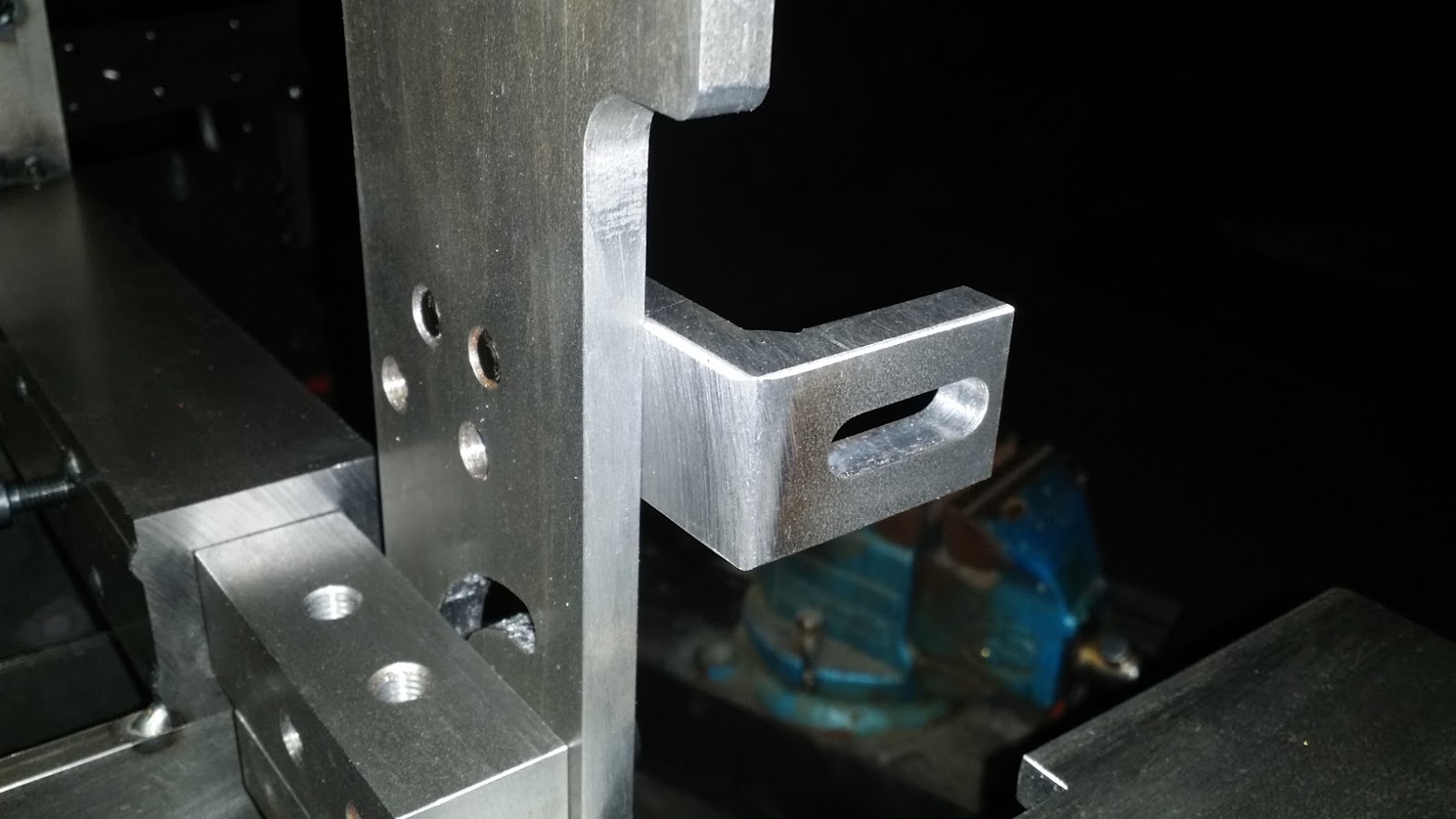

    Welding the motor mount bracket that i cut from the original machine, as i savaged the motor from the junk yard. Clamped both pieces to the table first and then to a bar, then welded very carefully so not to distort the piece, as all wheels must be on one surface flat, otherwise belt will want to go left or right.
    This is or ideally must be a very precise machine. First to be functional at all, then to be quiet and free of vibrations.
