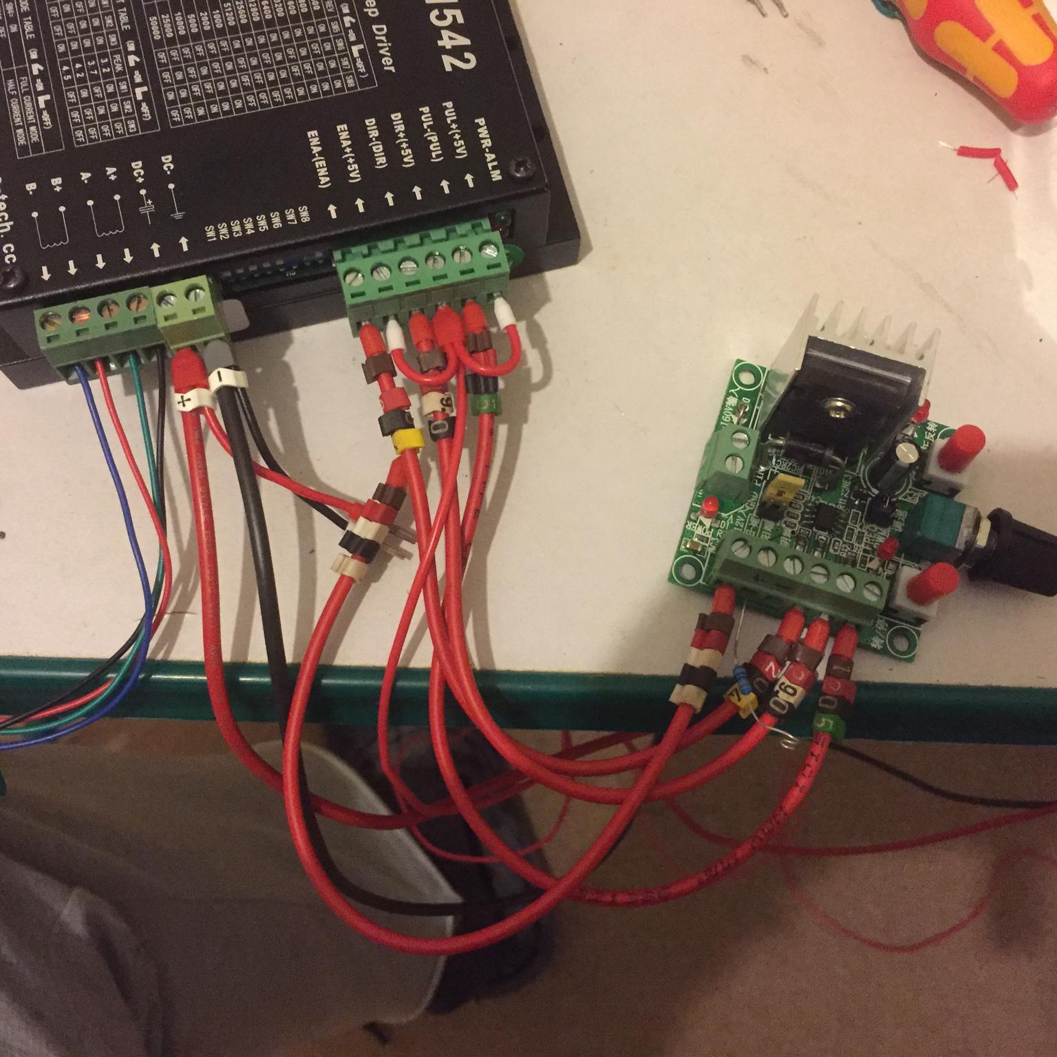

    I've got generator module and stepper driver connected with two power source 24v(driver) and 5v(generator) like in the picture
    I use PUL-, DIR-, and ENB-, 3 cables connected to the M542 driver
    In this setup I should join all pluses together and connect to common anode(+)
    I do not why but everything works without this cable - common anode(+).
    I am confuse here. I send only positive signals to the module
    I can change direction of the motor (DIR) and switch on/off the motor (ENA)
    Not the same situation if I use only PUL+ DIR+ ENB + without common cathode this time(-).
    Without common cathode I can only run one direction (like having only PUL+ and (-)cathode or PUL- and (+)anode two cables connected)
    I can have on/off function (ENA, because module send HI signal and disable(off) the driver.
    I know that signal I get is PWM square wave, multimeter allows to check polarity of such a signal (all + or -)
    Can anyone explain how this works please, many should benefit too.
    System got all function start/stops using ENA and Direction using DIR all done by 3 cable connected to (-) without having common anode(+)

    You only need pulse and direction signals, when step pulses are applied with a direction signal also applied the motor will run in the opposite direction to that in which it runs without the direction signal.

    Thanks magicniner, that part I understand.
    I modified my first post as wasn't clear.
    DIR signal Hi 5v change motor direction, same Hi signal 5V on ENA input disable drive (so system can ran without ENA as LOW signal is needed to run, but we loose on/off function)
    My question was why everything works when PUL- DIR- ENA- are connected without common anode(+)
    but when using only PUL+ DIR+ ENA+ without common cathode only ENA function works (start/stop) direction switch switching everything off as has missing common cathode(-). When cathode is connected all works as should.

    Hi Tom3
    the M542 stepper drive enable is a negative logic input
    the driver is enabled by no input to the enable terminals !
    (+EN &-EN being at the same voltage or left disconnected )
    do you have a link to the instructions for the pulse generator ?
    its not obvious from the picture the function of the terminals you have connected to the stepper driver
    since the M542 driver +ENABLE , +PULSE & +DIRECTION terminals are linked they should be connected to +5V from the pulse generator
    grounding the -ENABLE will DISABLE the driver
    John
    PS
    now I can see and edit my first post

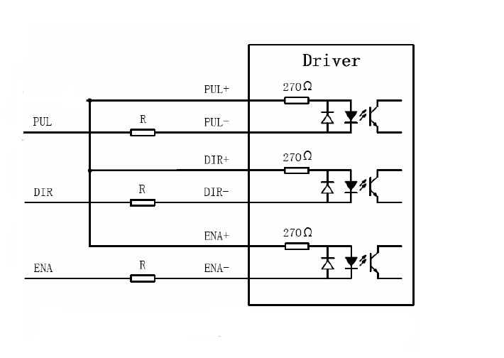

    the stepper driver opto isolator LED's have a diode in inverse parallel
    with the three positive terminals linked
    if the - direction is at a logic 1 (+5V) for example
    the - enable and - step inputs will appear to work until the - direction is switched to logic 0 (0V)
Name:	opto isolator inputs.jpg
