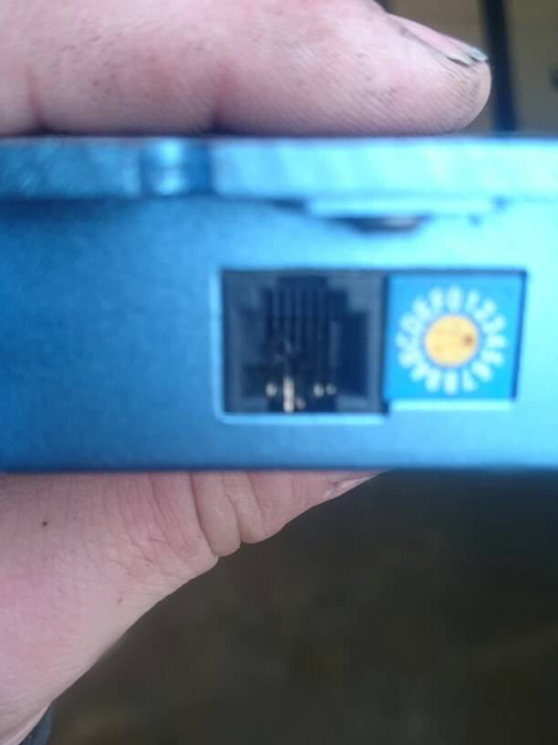

    The first one has no visual damage but no power to motor
    The second is damaged from plugging the rs232 cable that I burnt plugging in the first 1 whilst powered on and has now pulled the pins out the socket of the second
    Thought 2 psu's for 4 drivers was ideal if not I will need one with 4 outputs won't I??

    Yes the green light is on all drives
    The motor does not hold when powered on and is easily turned as if no power is there
    I will post a pic of the drives in about 10-15 mins Just on way to workshop now

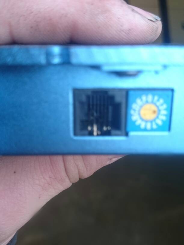

    Quote Originally Posted by Lewywri89 View Post
    Sent from my D6503 using Tapatalk
    The pic is too much out of focus to see it. Also there might be a fuse in the other drive
    If i soldered a new port on would this help or do you think the internal circuit will be goosed?
