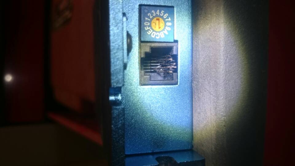

    Thinking about this and there should be no way that should have happened to burn the plug up like that. I would check that there is not a potential difference between the case on the drive and the pc.
  3. #33

  4. #34
    I had it running the other day but so slow it was barley noticeable
    But since I plugged in the software cable in when it was on one drive wouldn't work
    Then I didn't notice the cable pins were burnt until I plugged into the next drive and couldn't unplug it
    The port on the first drive however looks fine
    Sent from my D6503 using Tapatalk

    Sorry but you are not making a lot of sense. It is difficult to know what is actually wrong. You need to do methodically one step at a time and give clear answers.
    So do any axis work if so which one and does it move the correct commanded distance?
    Have you checked if there is a PD between the drive case and the PC because putting the protune plug in should not have caused a burn up.?
    Try and get just one axis working first.

    Sorry I should of said I had all axis moving via pc keyboard and was very slow
    Before i changed the numbers jazz gave me I realised the 800microstep I said it was set to was way out as the drivers only go to 512 according to manual so I thought I'd go into protuner and double check but I plugged into the x axis drive when powered up and since then the motor didn't have power to it but the green led is on the drive
    Next day I then plugged the cable into the z axis driver and couldn't communicate with pro tuner so checked the connections and noticed this had happened
    What do you mean by a P between driver case and pc?
    Im sorry to be confusing
    Lewis

    PD as in #32 potential difference between the case on the drive and the pc. in other words is put a volt meter between the case of the pc and the case of the drive it should be zero.
    what model and make is the driver?
    you still not have answered the questions. re read post #35
    re the drive with the damaged contacts in the socket make sure that none of the contacts are touching each other as the drive might still work.

    Regards the Blown drive's then put that down to experience and keep to the safe rule of never unplug or plug-in anything while powered up.

    Thanks I've done the pd and was zero
    The drivers are leadshine em503
    All the axis worked but wrong speed/distance
    I never managed to change the setting in motor tune page in mach 3 so I presume that was my speed problem but 2 drives out of 3 no longer provide power to motors so I assume these broke
    I wish I could explain it better for you but I'm not a genius at this sort of thing plz forgive me
