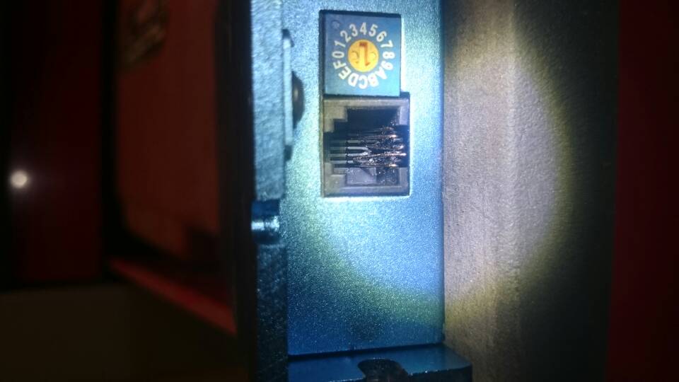

    ive been building a cnc plasma but cannot seem to get the speed up in Mach3
    The motors run super slow
    im using a dell 755
    wantai 3nm motors
    leadshine em503 drivers
    5 axis Bob off flebay
    24v Siemens psu
    1605 ball screws
    any help will be appreciated by myself and anyone else stuck with this problem
    i will post pics of my build so far
    but I've gave up on it for now till I can find more info
    thanks in advance
    lewis

    Sorry couldnt figure out how to upload images but ive got it now
    I think one of tje leadshine drivers are faulty as there is no power to 1 motor
    Hope I can find the problem with it being super super slow
