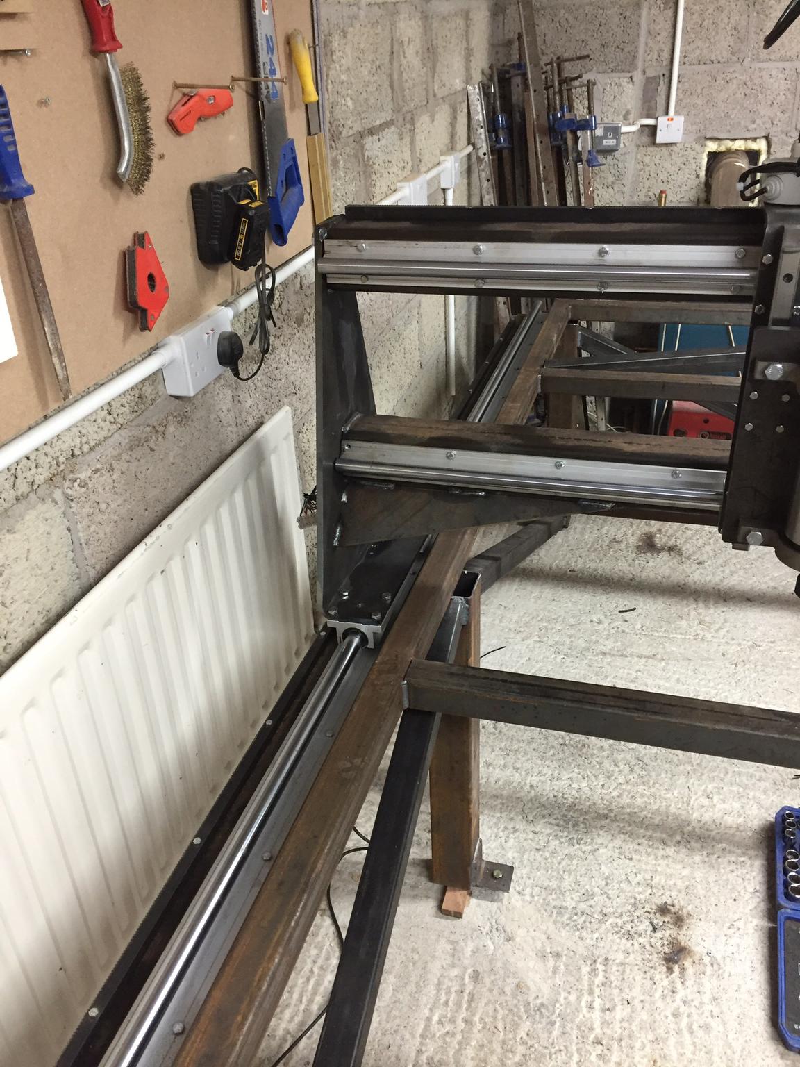

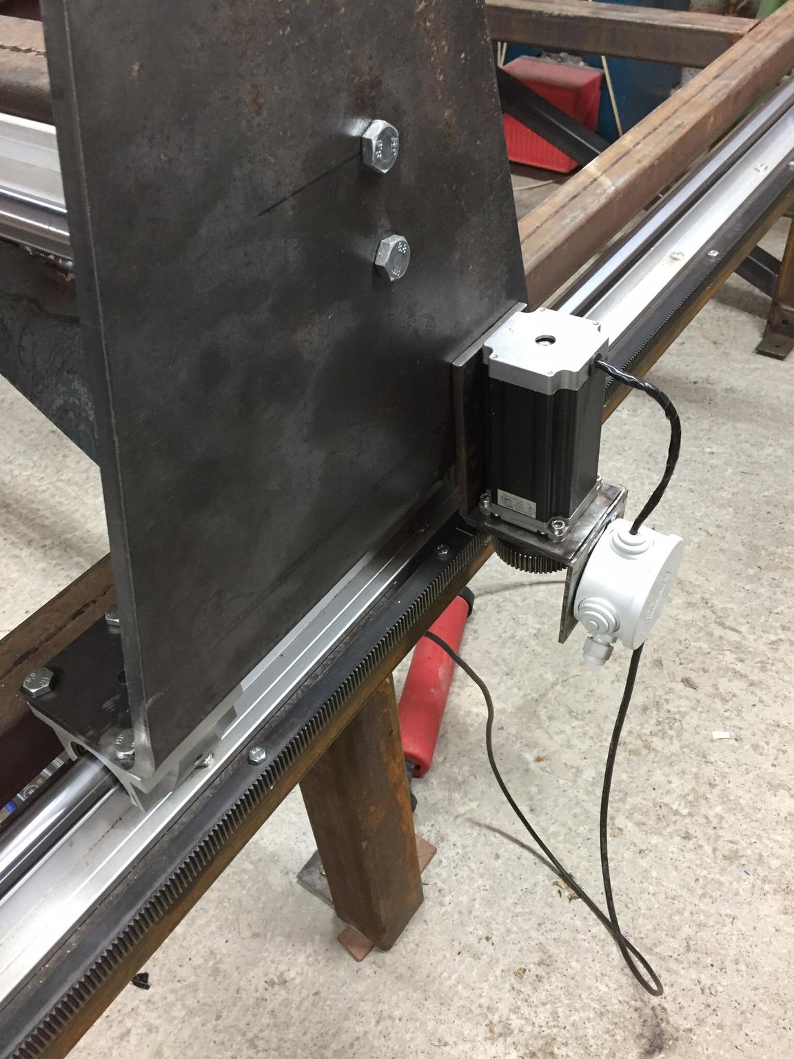

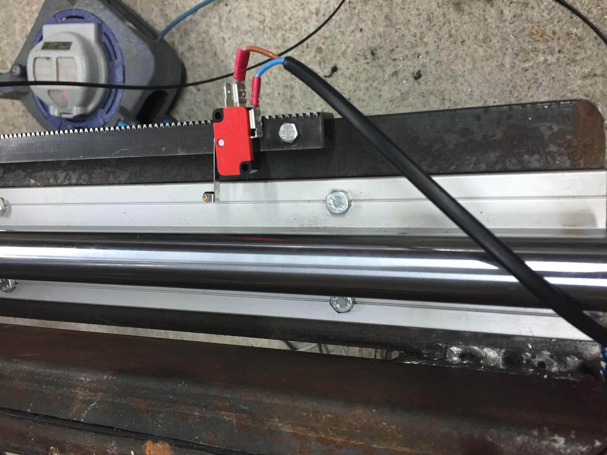

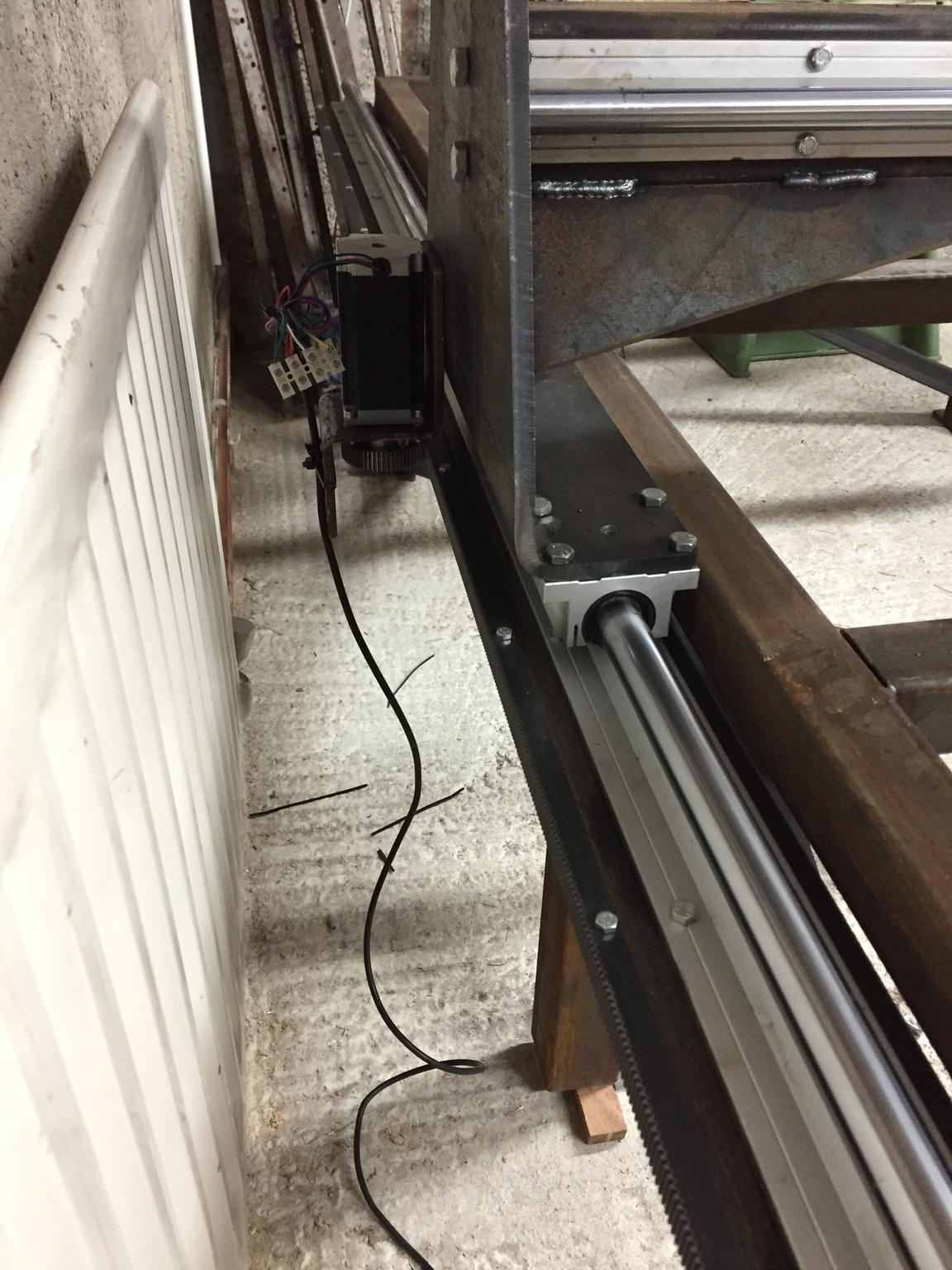

    Sorry about delay Clive.
    Pics of gantry motors and limit switches.
    Going to wire these on at the weekend, and see what happens from there

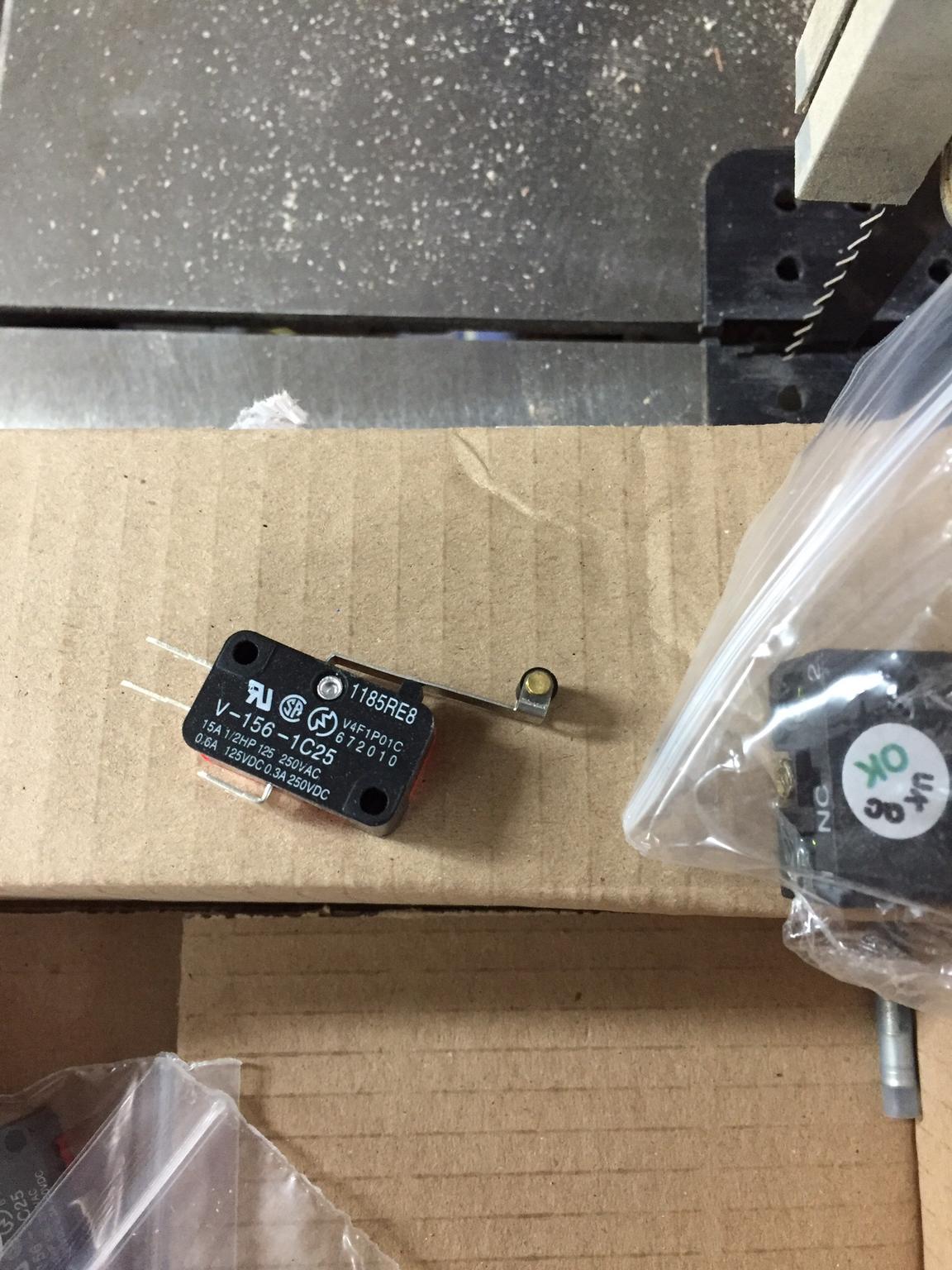

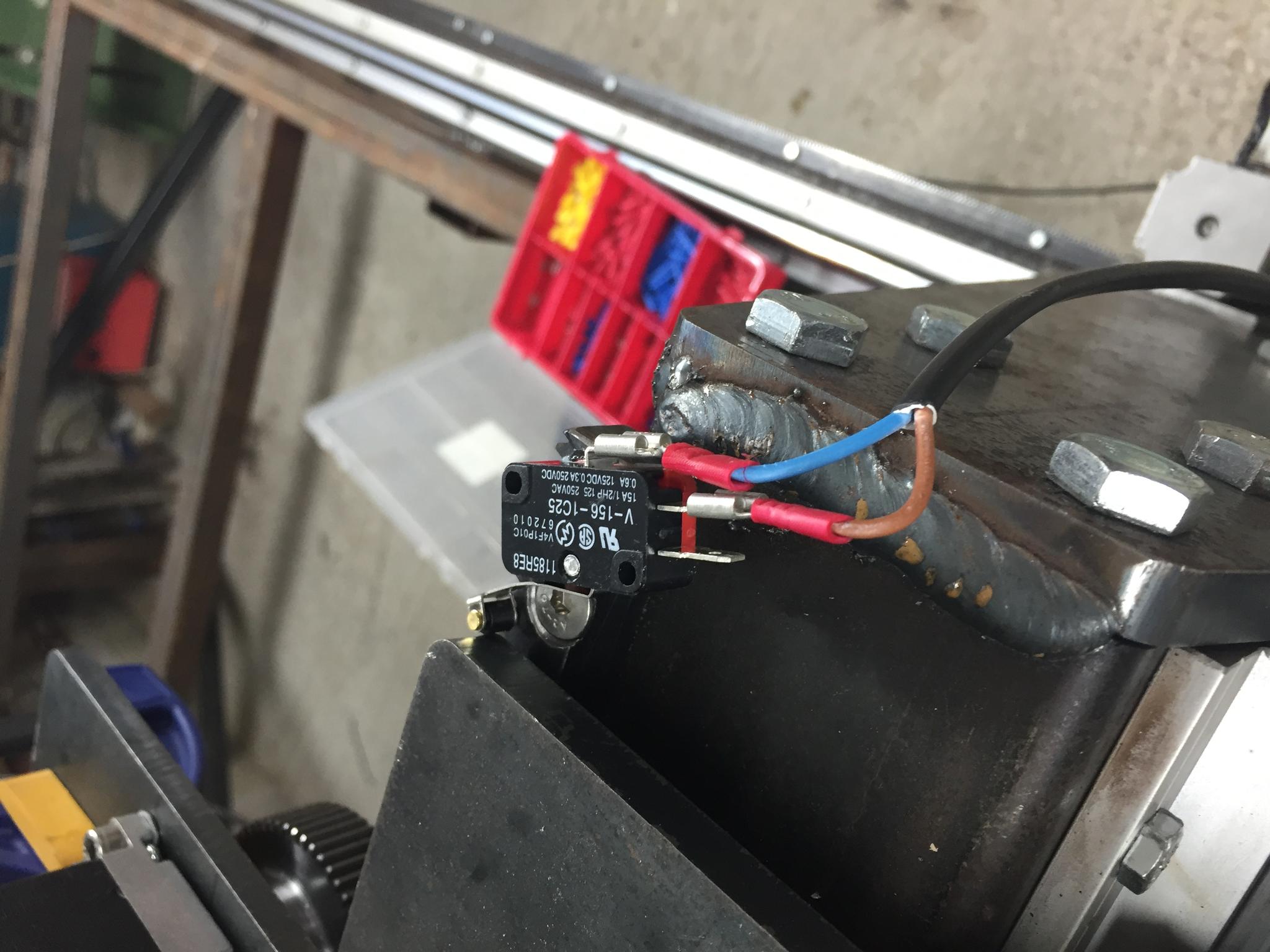

ID:	17334Got my home switches all on today but still no joy with my slave axis. Is there something other todo than choose it to be slaved with y in Mach ??

    How have you wired them ie have you used two different input pins on the bob and how have you set the slaved axis in Mach3 Also have you set the slaved axis say A or B to linear in Mach. Post a pic of your setup screen in Mach
