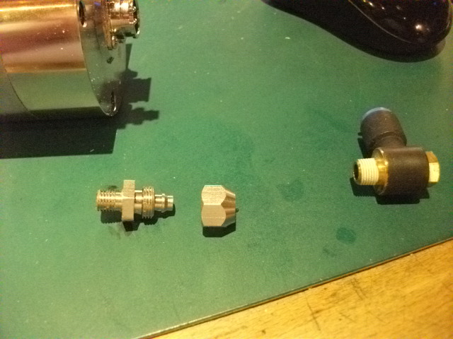

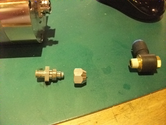

    Hi Guys,
    This thread reminded me that when I tried to fit the water pipe I could not get the collar to engage with the thread to clamp down the pipe. I put the problem to one side, to sort it out when I installed the spindle. Deans remark about changing the connectors to air hose ones made me think I might be able to use the push fit connectors as on the right of the picture. but the thread to the spindle body is not 1/8 NPT as it has an outside diameter of 7.5mm. Anybody got any suggestions as to what it might be ?
    Cheers,
    Rob

    If you can measure the TPI (threads per inch) of the thread it will make identification much easier - google a few thread charts such as :
    http://mdmetric.com/tech/tict.htm
    Can tell you exactly what it is. . . . . M8 x 1mm Fine thread.
    Spot on mate, I just went to the workshop and checked it with a M8 x 1.00 die. Well at least I can make some adapters, if I can't buy them.
    Cheers,
    Rob
