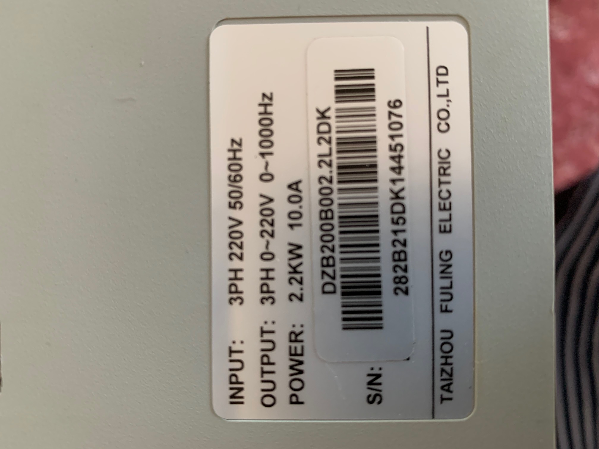

    Thanks, I've attached a photograph of the nameplate from the inverter the manual was downloaded from another forum Click image for larger version.
    Thanks Jazzcnc, I was getting a bit confused by the previous guys replies as the inverter was still fitted and wired into the BOB in the machine when I took delivery, the pervious owners had only disconnected the spindle.
    very much appreciated
    Ok I've just looked at the manual and I remember the parameter that sorted my issues was F1.0 I can't remember what it's set too but this was the game changer parameter so try changing it to 0 or 1 and see what happens. I think you need to restart the VFD for changes to take affect.
