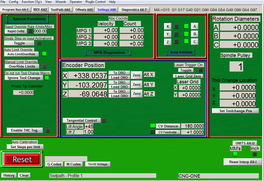

    I've designed a piece for a family member's wedding and this will be the first g code I created with aspire vectric. Also the first thing i have attempted to cut with the machine. I loaded the code and started the cycle but what I found was a stuttering and strain on the y and especially x axis when making small movements. The z was going up and down like a dream but this is on a screw where the x and y are on belts.
    I lowered the velocity and speed but this made it worse. Ive uploaded two videos at the different speeds at 1000v and 300a and then half of this on youtube the stuttering gets worse towards the end of the video. Also below I have uploaded the code created by aspire and some screenshots of the axis on mach screen.
    https://www.youtube.com/watch?v=QjiC_srqoO4
    https://www.youtube.com/watch?v=4AXxvEFkOA4
    The step motors are all set at 1600
    Thankyou for any help

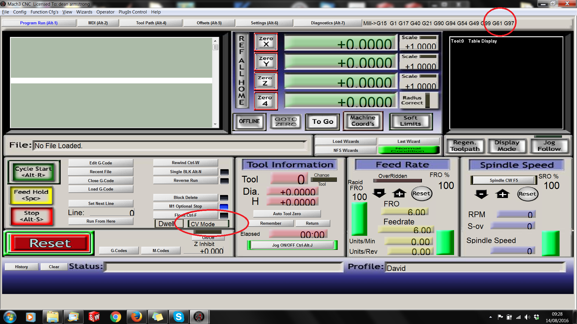

    You could have two issues working together here.?
    First one is that your in Exact stop mode. This is easy to tell by looking at the top bar to see if G61 also on lower right if CV button is Off (not lit blue)
    The other is the fact your G-code is using little lines to go around corners rather than creating arc's.
    Together the will give you this stuttering because Exact stop will do just that and stop for fraction sec at end of each little line.
    Try this again but first go to MDI and type G64 to make sure in Constant Velocity mode.
    To fix the G-code then you need Post that use Arc's. I think Aspire has post that say's mm/arc's.

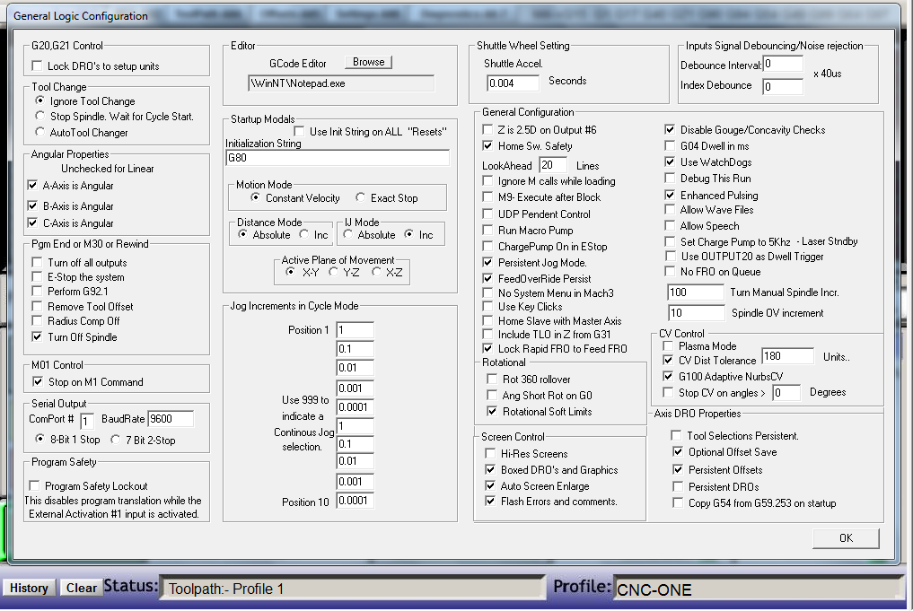

    Hi Jazz thank you for the fast response, I input the g64 and checked aspire and I saved the toolpath selecting 'mach2/3 arcs (mm)'. I still got the stuttering movement issue? I've uploaded the setting pages below if that gives a better insight to the issue.
