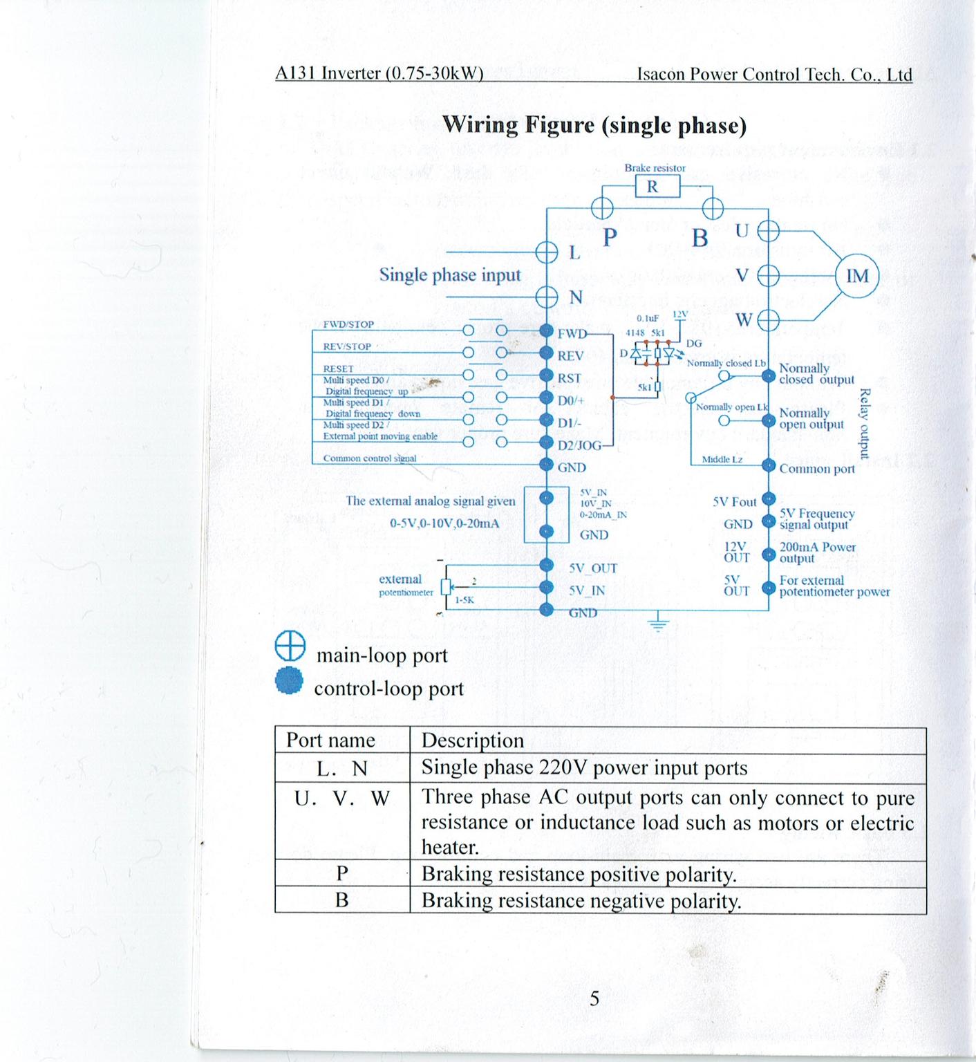

    Last night I had a couple hours free so I thought foolishly that I could get the VFD setup with mach 3 in this time. Anyway I followed the manual here http://www.omc-stepperonline.com/dow...ers_Manual.pdf but I wasnt entirely sure with the setup coming out of the VFD ASKPOWER A131 as all I could find were these instructions http://www.instructables.com/id/6-Ax...reak/?ALLSTEPS
    The spindles runs from the panel fine. All and any help is appreciated thank you in advance

    Ok this is easy to make happen but will require you changing some parameters in the VFD so you'll need the manual.
    If you can find the VFD manual I can describe how to do it. What you want to know is the Parmeter number for External frequency control for the Speed control. Also parameter for ON/OFF so can set to External control.
    On the Huanyang VFD's which this looks like but Isn't then it's parameter 01 & 02

    Hi Jazz on wiring I had FWD going to PIN 17 and and D2 JOG going to PIN 14 with 10V IN & GND going to the right hand side of the bob as shown in the linked BOB manual above. I've uploaded the VFD manual. Thanks for your help.
