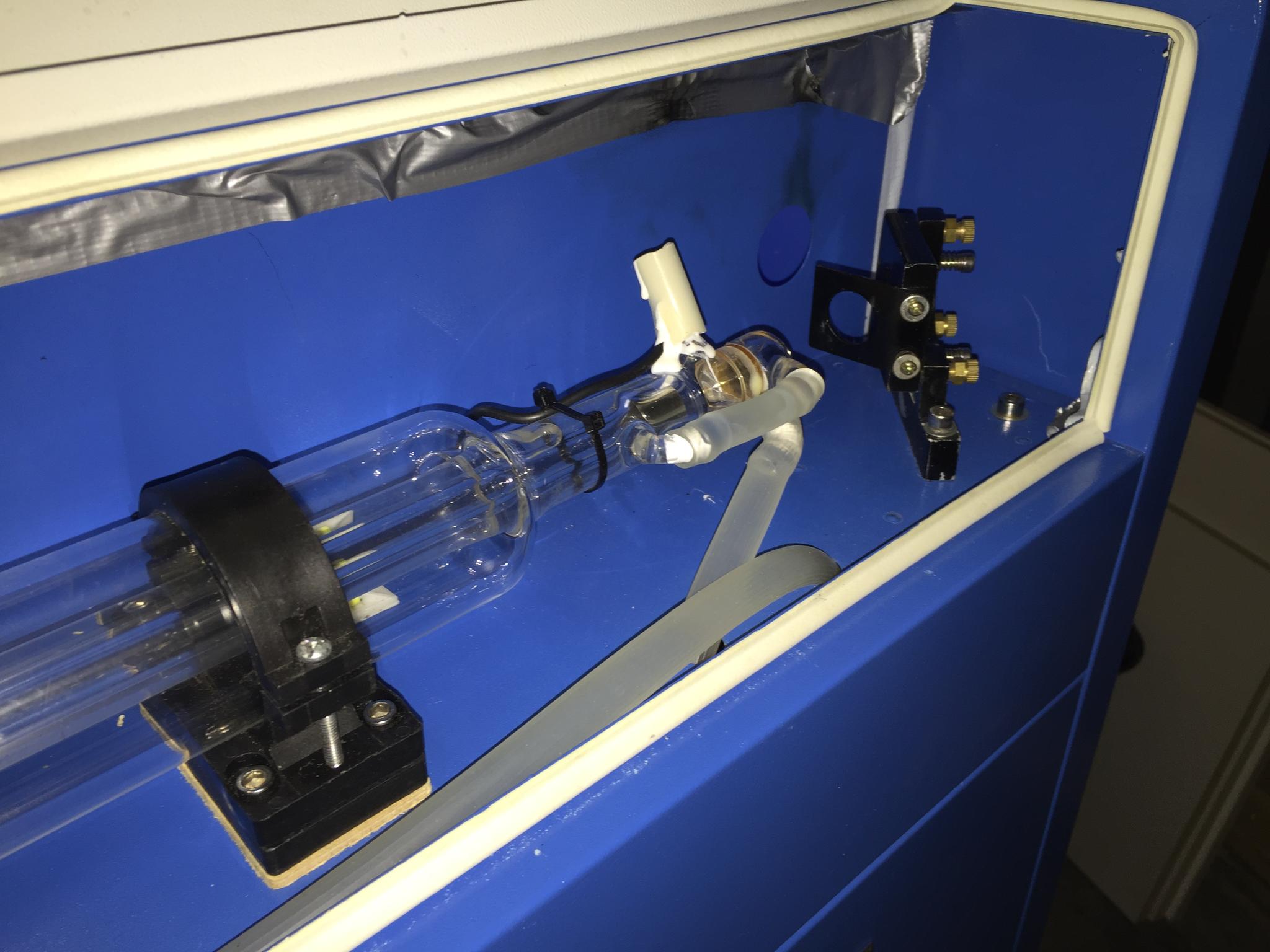

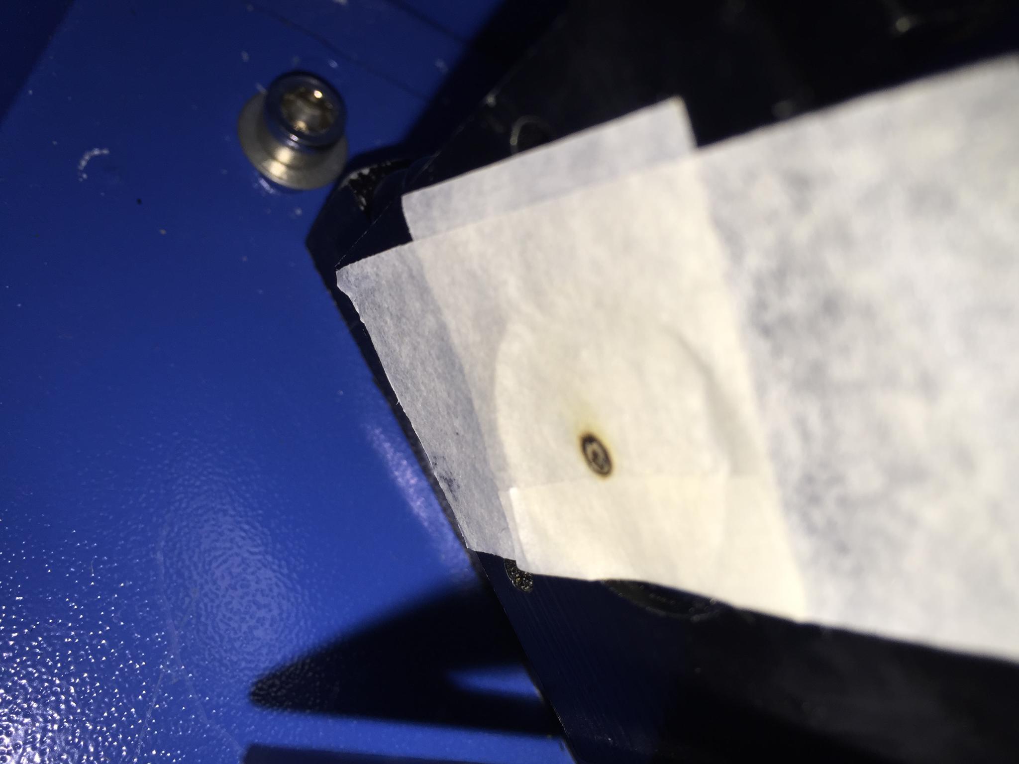

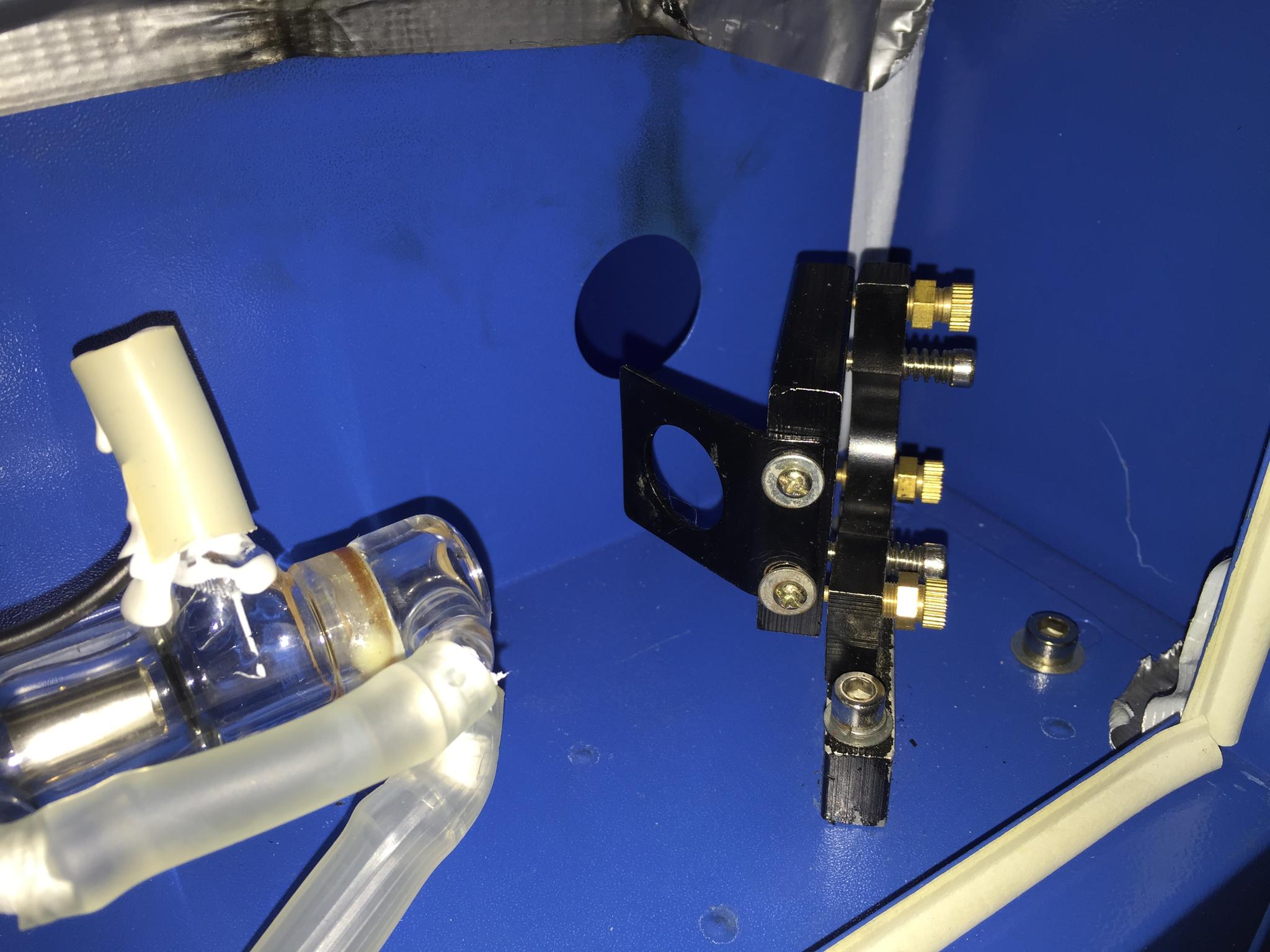

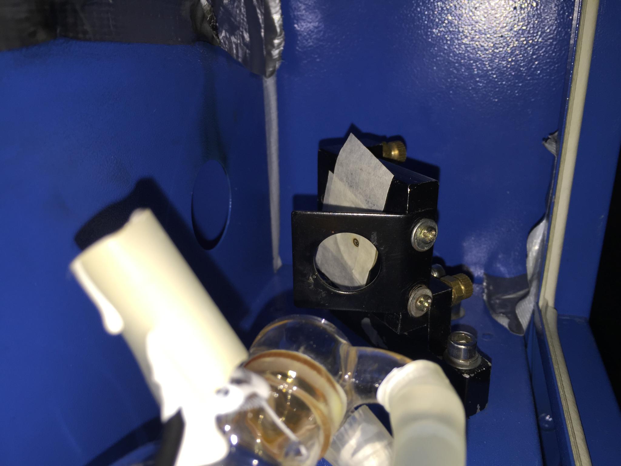

    It’s difficult to get the laser tube central on the first mirror (to high) then I just can’t seem to get the beam parallel on the second mirror with at least 5mm or so movement at each extremity of Y axis travel.

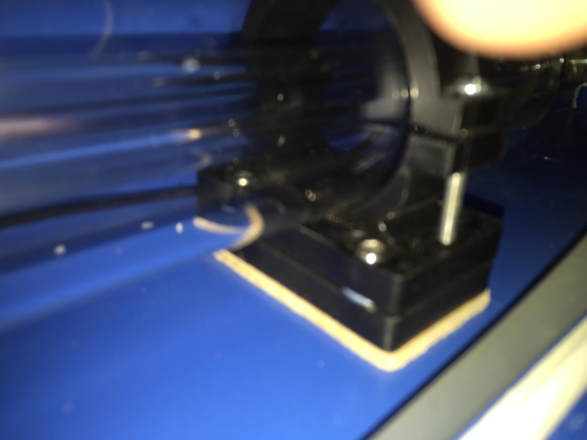

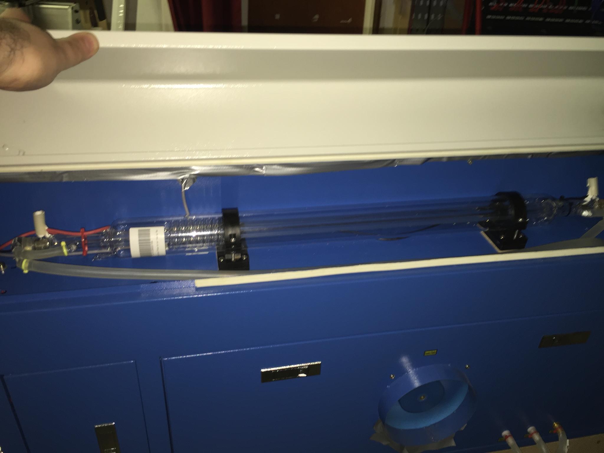

    I spent another 4 hours or so trying to nail the alignment but to no avail. I have make some mdf laser tube mounts to get the laser tube better centred on the first mirror but still have a lot of movement as the laser travels. I have uploaded a video to youtube and attached pictures.
    I must be doing something fundamentally wrong. I've not been able to use the laser for weeks now. :(

    Tilt the first mirror up.
    I had to print some new mounts for my laser tube, the originals were crap. I can probably find the .stl files but the only dry 3D printing plastic I have right now is marigold. Probably won't go with your Royal blue.
