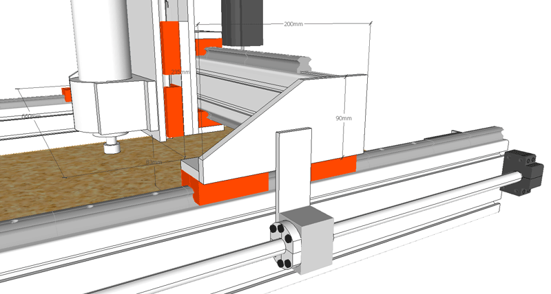

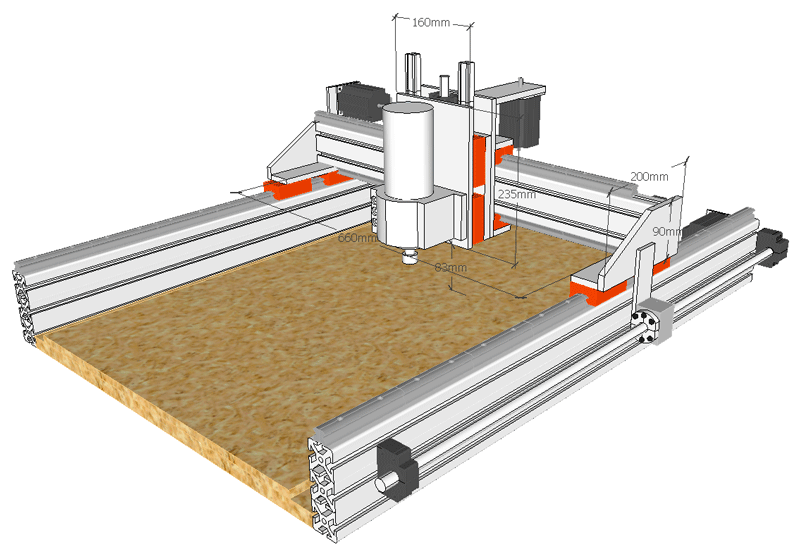

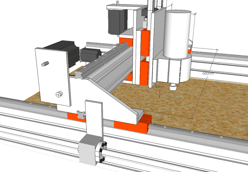

    Ok - had some time and re-designed it with square rails :)
    For the X, I'm thinking of using: 40x80 Heavy Duty Aluminium Extrusion (http://www.aluminium-profile.co.uk/a..._ITM02604.html)
    8mm Slot Ix = 26,87cm4, Iy = 101,19cm4, Wx = 13,44cm3, Wy = 29,29cm3
    The Y's, similar, but the 40x120 - Those will then get bolted down onto a lovely solid flat surface :) [Later to be upgraded to solid Steel table]
    Question 1: For the X, the rails will be 80mm apart (bottom of rails), is this ok? Or should I rather go for the 120mm on the X - which means bigger side plates etc.
    Question 2: I've gone for 10mm Aluminium all round (6mm to hold the motor on the Y, and attach the Ball nut housing) - thoughts ?
    [ Most of the 'bend' will be in the lateral movement for the Y, and the square rails will 'support' the 10mm... so see no need to go more. ]
    All Steppers 3.1Nm with pulleys, 1:1, and 1.5:1 for Y [Powered by 60V stepper drivers]
    RM1605 for Z, and RM1610 for X & Y. (ends or F, extended from 15mm to 30mm)
    BTS Automation will open end of Feb after their Chinese new year... hoping to order soon :)

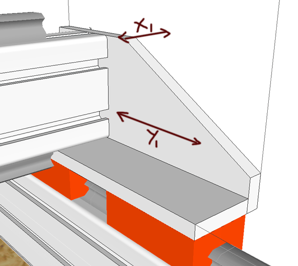

    When you say 10mm is too thin - I agree in some part, but let me try explain my thinking...
    On the Y Side plates, most of the "force" will be stopping the X beam flexing, and moving in the Y direction, so on Y1.
    The forces on X1 (if the X is bolted down on the bottom plate properly) will be minor.
    On the Z axis gantry, the back plate - I agree - 15 or 20mm. It will flex, although the blocks should support it, apart from the 30mm gap between them, so only "bend" that will apply will be on the small 30mm bit inbetween the blocks... Whats bend like on 30mm of 10mm plate?
    On the front Z plate, the plate will be bolted to the square rail. Surely the 20mm rails will stiffen up the 10mm plate?
    I don't want to put extra weight on it if I don't need to - but you guys know what works and what doesn't....

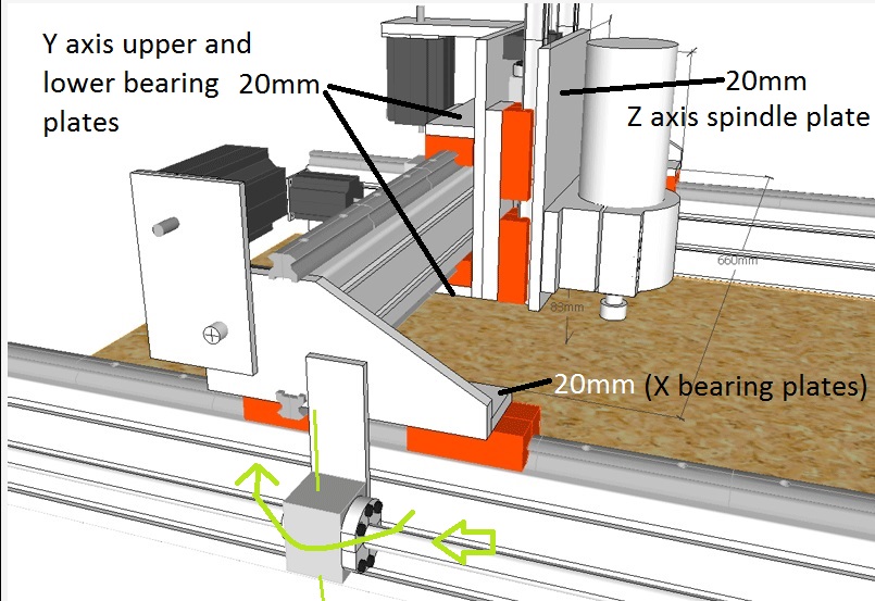

    As for 10mm vs 20mm I know aluminium is expensive so you are trying be economical so here are my suggestions on the minimum areas to use 20mm on, and why.
    Z plate
    as Dean says. Don't use the rails to add the stiffness. No worries about weight either - the steppers will lift more than you think once they are driving a ballscrew.
    Y axis upper and lower bearing plates
    Several reasons:
    1. If you use 10mm plate you will have to use very small bolts into the side to mount them to the Y plate. So could probably only fit say 6mm bolts to connect them and this is just not good enough. They will bend and you can't get much torque into them to get a good clamping load
    2. The 10mm plate has a small footprint onto the Y plate so is much more likely to bend up and down at the joint.
    X axis bearing plates
    1. They hold the gantry and stop it rotating. The triangular plate on the sides transfers this load down the outside to the bearing plate, but the X bearings are in the middle of the plate. This means that the unsupported corners on the inside will bend. Therefore they should be 20mm.
    You could add another triangular plate on the insides as well but it is a bit awkward to attach back to the gantry front face.
    2. You will need to counterbore the bolts which hold the X bearings onto the X bearing plate so that the gantry can sit flush. I'm guessing these are around M6 so need ~6mm of counterbore depth. In 10mm plate this leaves just 4mm of metal holding the bearing to the plate. This is a bit thin in my view, whereas 20mm still leaves 14mm of metal.
    3. The triangular plates on the side will bolt onto the edges of the 10mm X-bearing plate and you will have to use fairly small bolts (~6mm) which is a bit small.
    Finally . . .
    X ballscrew drive plates
    The strips which drop down to mount the X ballnut to are quite thin. They will twist when the load is applied as it is offset. A thicker plate with a pocket for the ballnut would be better, or at least some support, but it sounds like you have limited tools so you could build it like this and use the machine to make some beefier parts.
    Another finally . . !
    I don't think you can assemble the Y axis and Z axis can you? I think you've done the classic 'lock-out'. Walk through the steps of bolting it together in your mind and make sure it is possible and there is a build sequence.
    As you are using packing pieces to mount the Z bearings to I think you will have to extend them (and the Y axis plate) say 15mm below the level of the lower Y axis bearing plates to be able to bolt from the back. The top is OK as it already extends above the level of the upper Y axis bearing plate so you can bolt through from the back.
