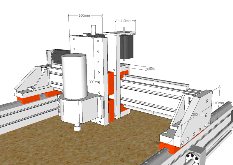

    Ok,
    Re-Designed so all plates are 20mm (except motor mounts, those I have at 6mm - might end up as 10mm...)
    I did what Clive suggested and put each piece together as I would.
    I should be able to get away by having recessed bolts for the entire Y/X axis, and being able to bolt everything without tapping :) [Y will need tapping]
    [ The bolts holding the X plates and bearing support (160mmx50mm) together, can be bolted from the back to the front ]
ID:	17541Click image for larger version.
    I 'think' I'm getting nearer to finally placing an order of exact lengths of components :)
    Thanks all!
    I can't take the credit for that I think it was routercnc.
    Not sure why you need the spacers on the Z plate as it would be better to recess the front plate and that would get the spindle nearer to the gantry.
    edit it looks like you have the BK bearing at the bottom end of the Z screw
  6. #25
    That would be the long term plan - but unless I grind out the recess.... I won't be able to do it now.
    Unless... I could rig up a temporary motor mount and bolt the linear rails to it and do it by hand.... hmmm...
    Another idea is to rig up something and do with the hand held router.
    Suggestions?
    For now, I've gone with mostly square cuts, (that's how they are supplied), and then once the machine is up and running, start cutting bits and then replacing them. Although, I will try do do most of it by hand with the router.
