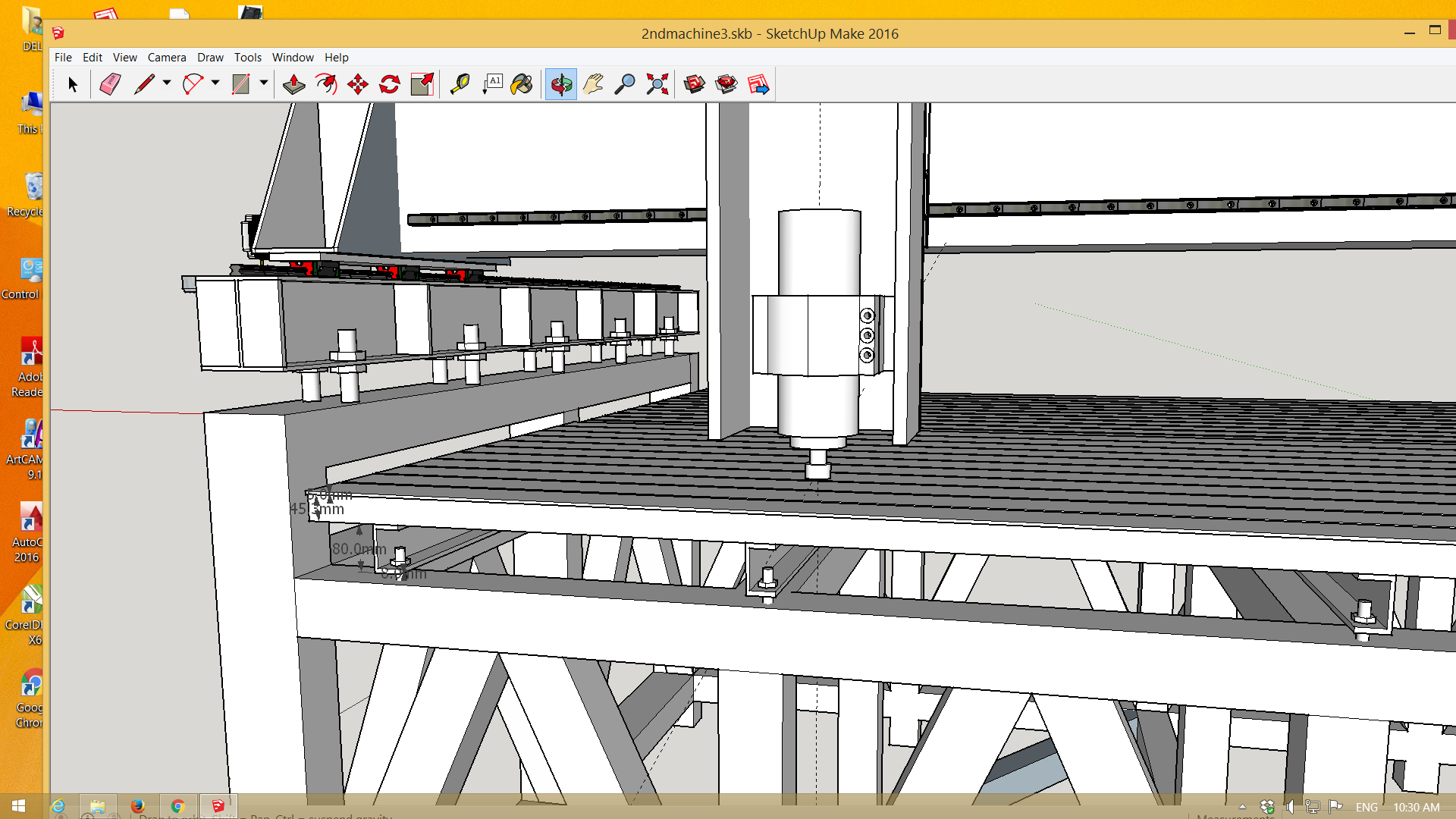

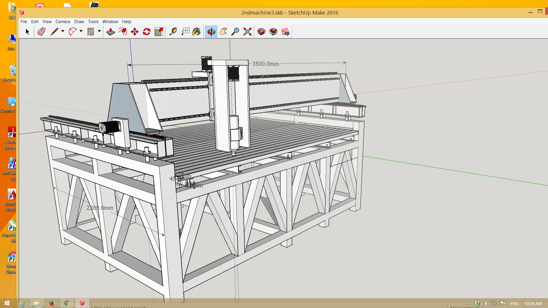

after reading a lot of threads i reached this as a startup design ..the machine will Click image for larger version.

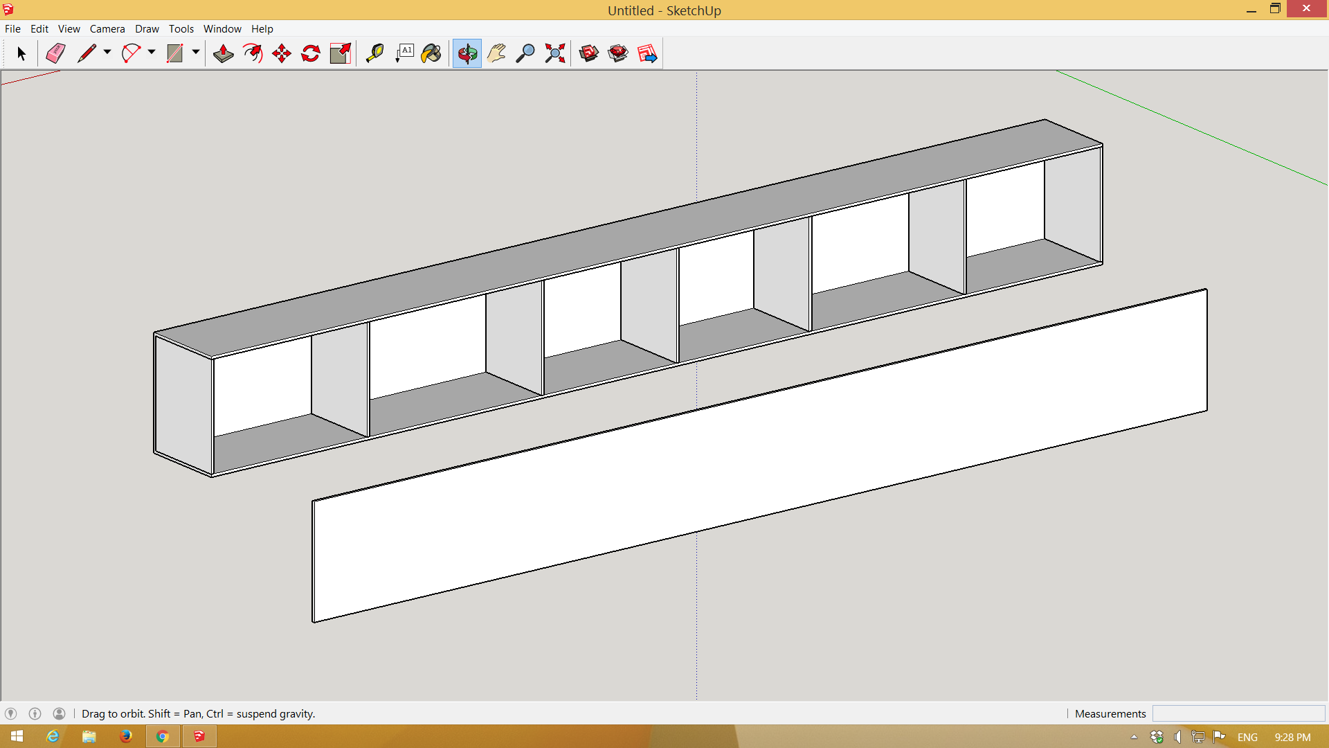

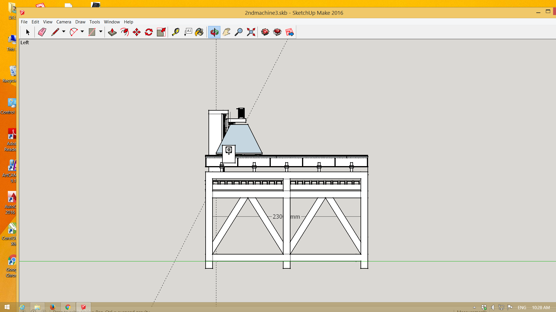

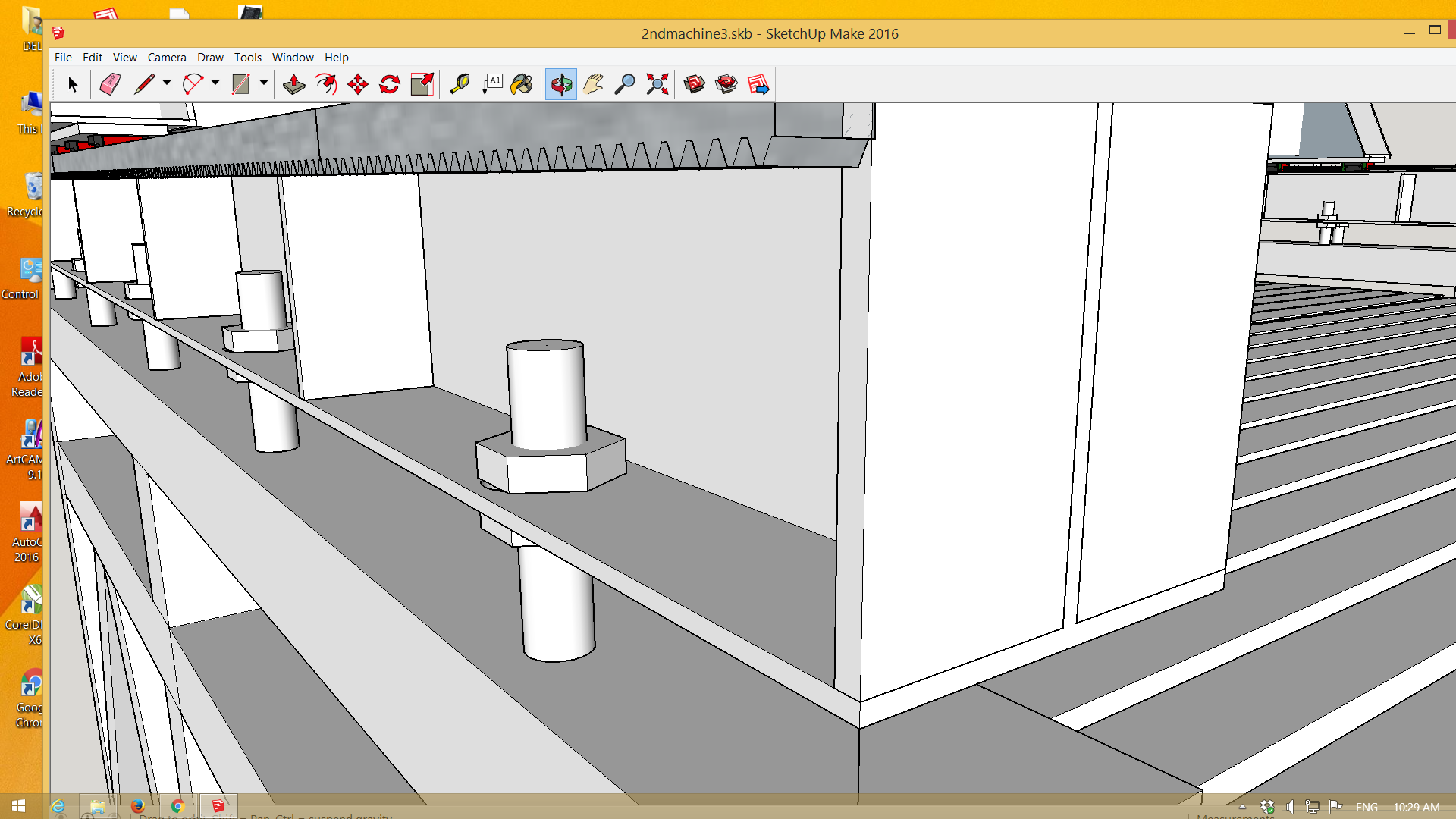

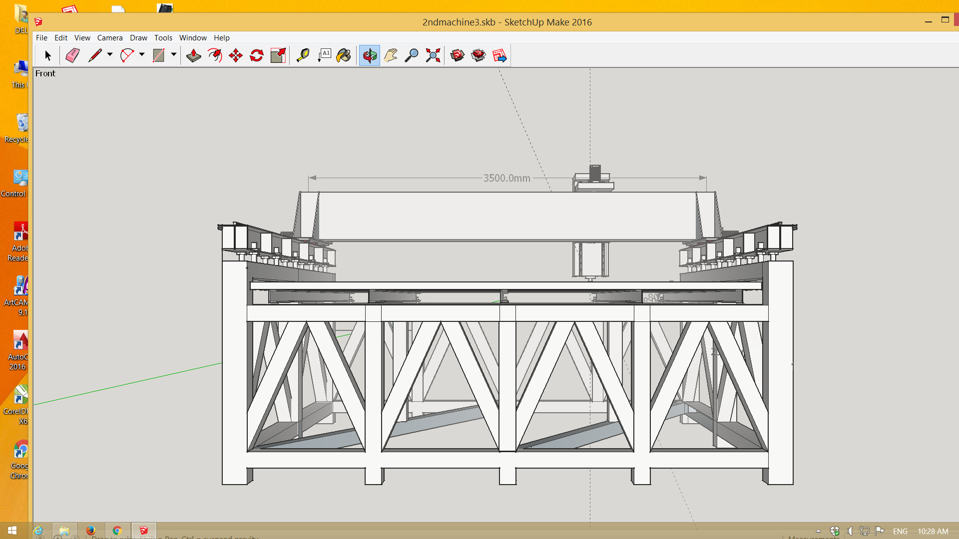

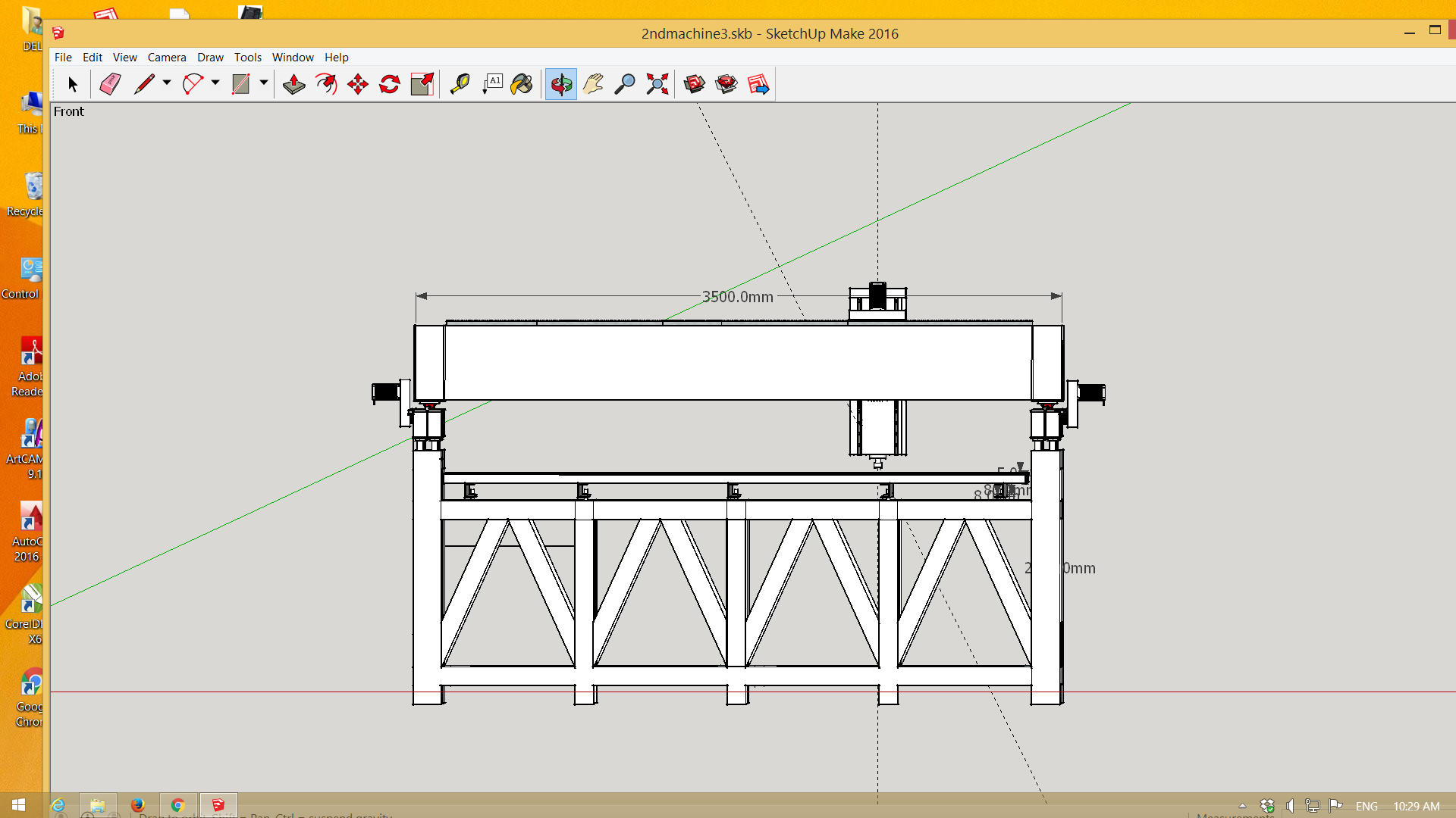

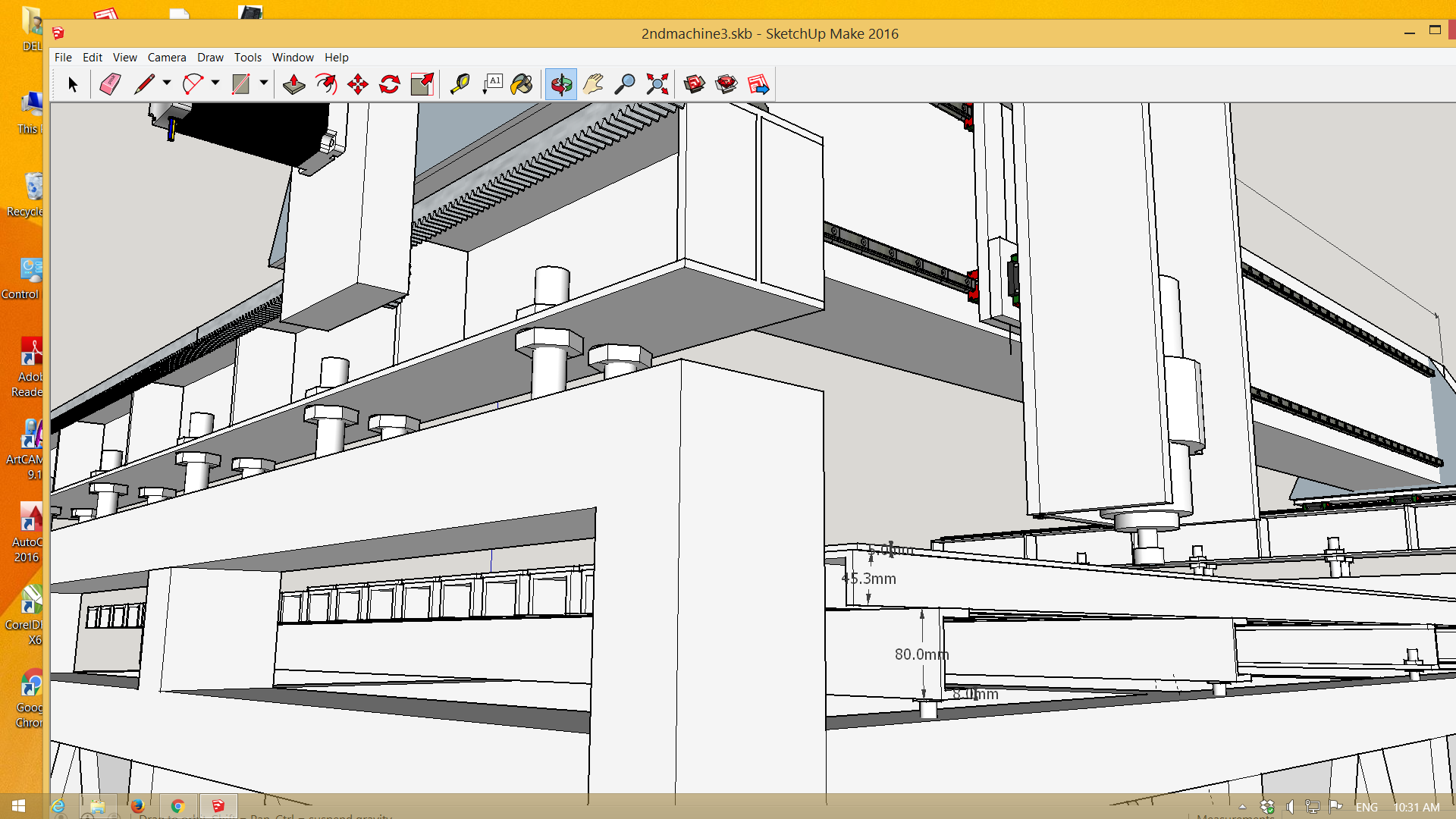

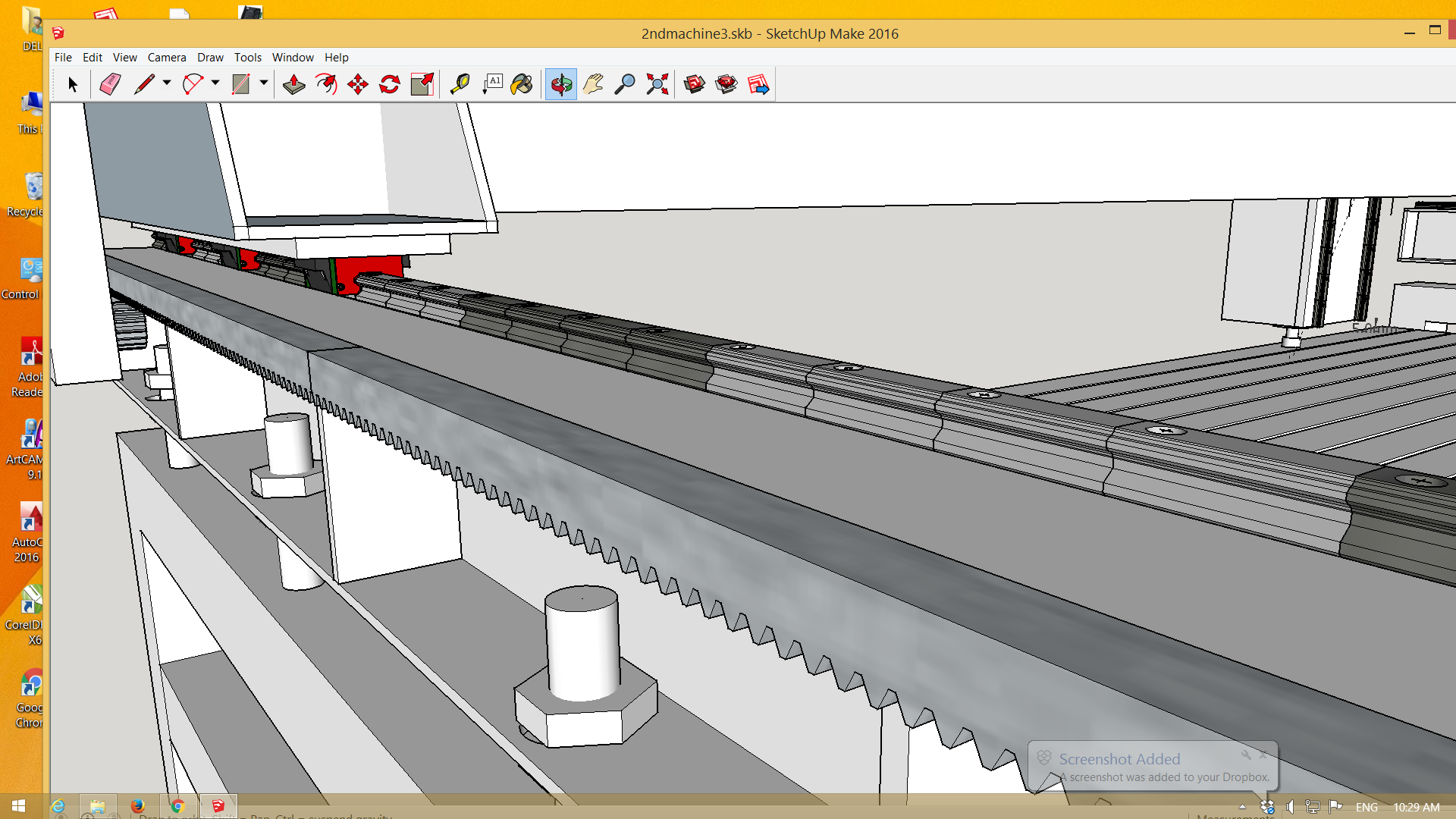

be used for engraving marble sheets (really heavy) ,for the y i will use 6mm steel sheets bent to form a cross section of 30cm *40cm,i will be using R&P sustem with gear reduction 1:5 for the steppers
waiting for your input ...thnx
