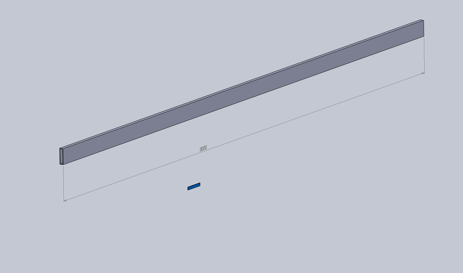

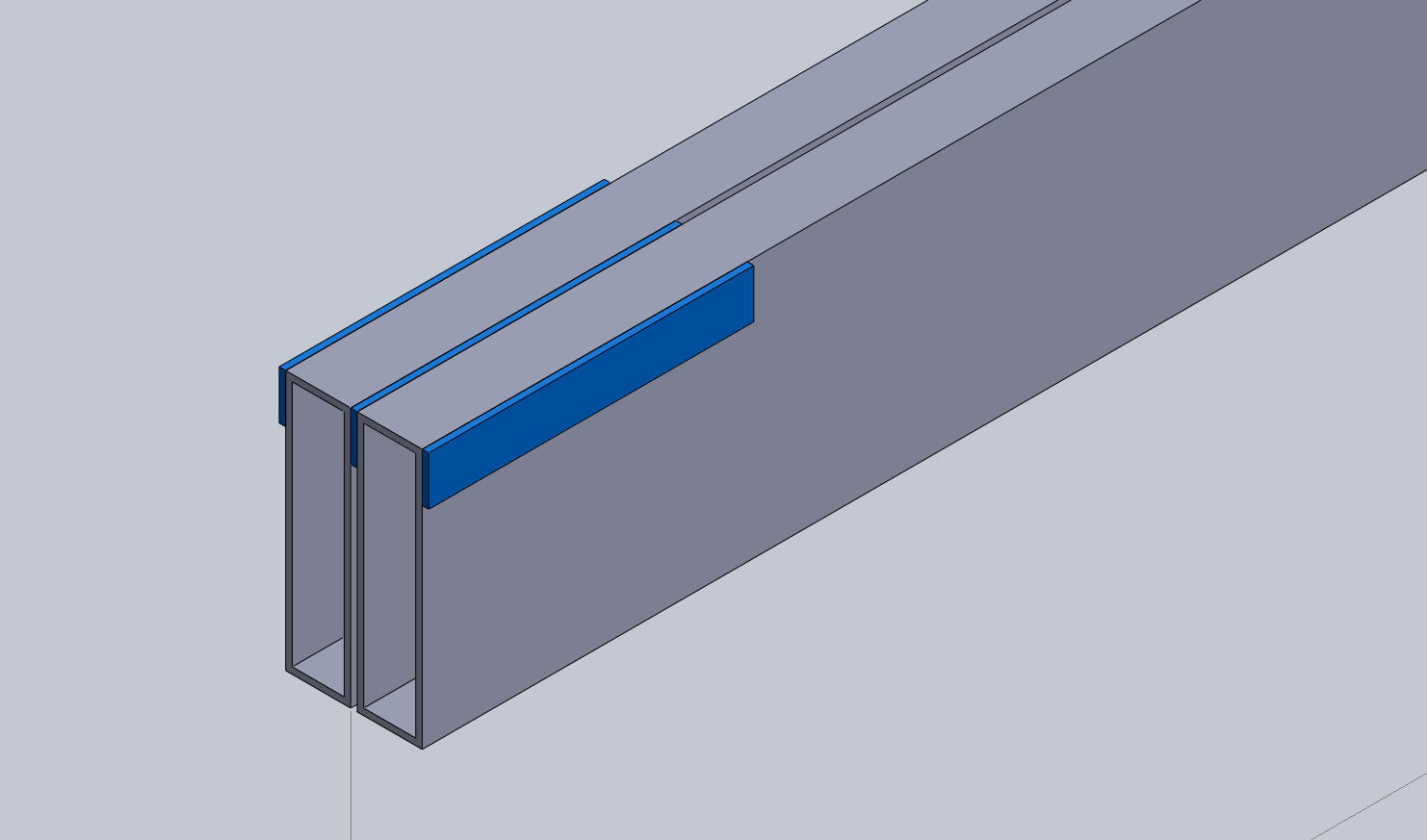

    As it is very possible to use epoxy level for my machine and I will use a small amount of epoxy ( that will finally go to thrash) for some tests. So I was thinking if it reasonable to make the tests using two aluminum rectangular tubes 80X20 as follows.
    We start with a 6 m long aluminum rectangular tube, cut into two pieces of 3m long each
Name:	straight edge 1.JPG

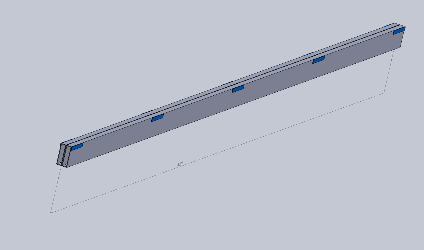

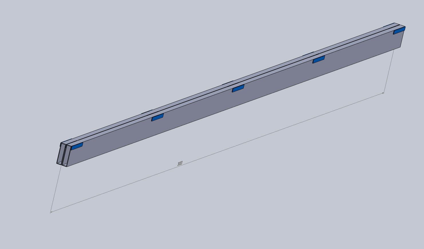

    We attach the two tubes with 2mm spacers( blue color)
Name:	straight edge spacers 2.JPG
ID:	17497Click image for larger version.
Name:	straight edge spacers.JPG

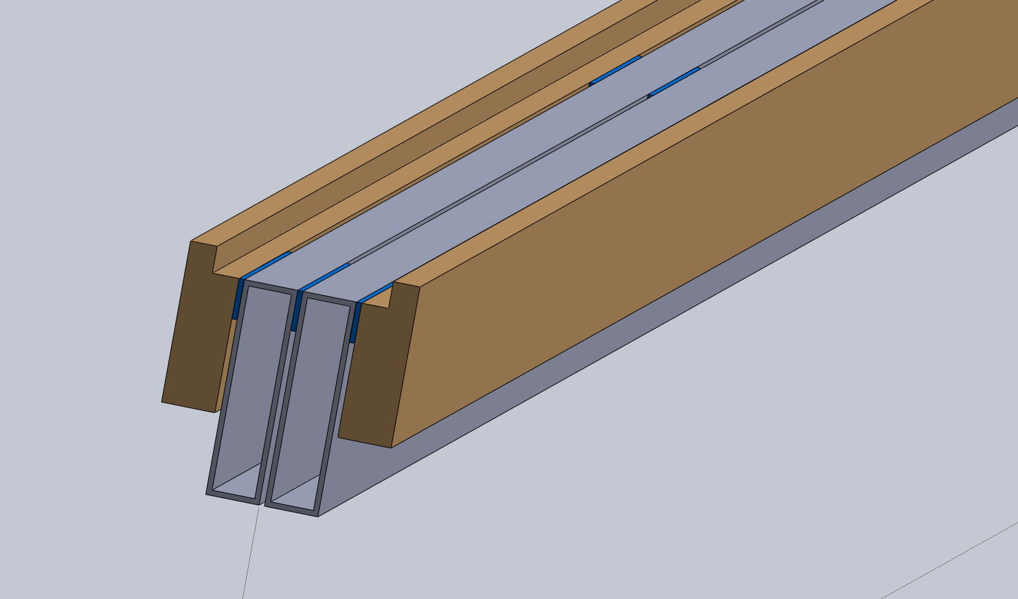

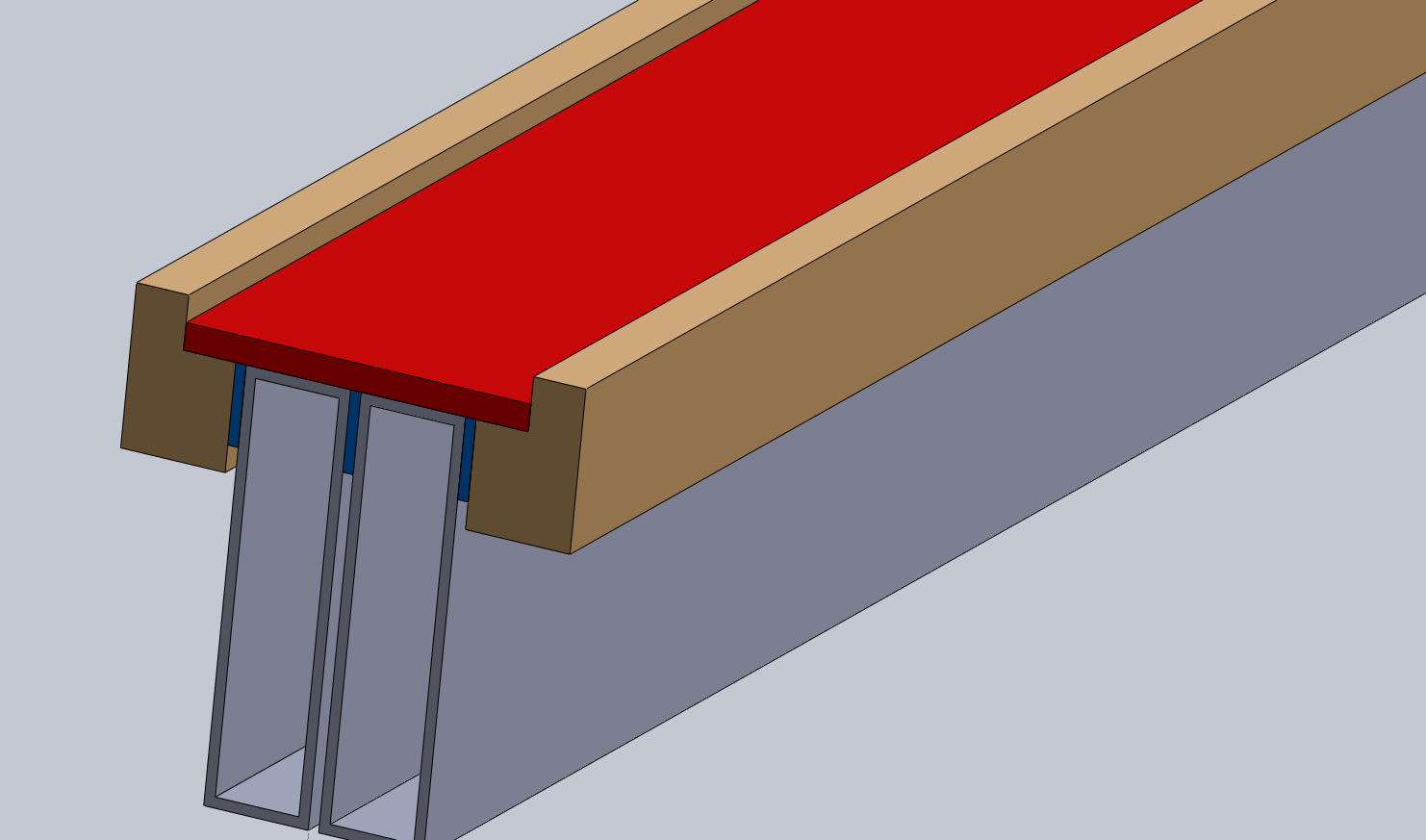

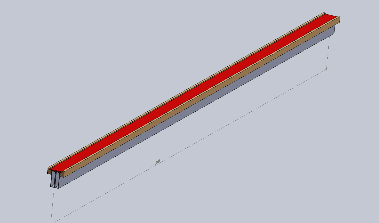

    At the edges we put two pieces of mdf as at the following pictures also with spacers between the mdf and aluminum profiles
    We put the spacers so that we can cut the epoxy after cure.

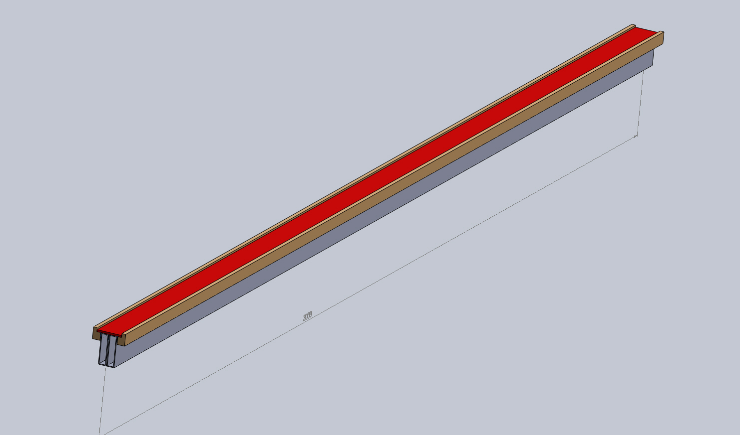

    Then we level the tubes, we fill with silicone the 2mm gap that the spacers will make and we pure epoxy.
Name:	straight edge mdf 1.JPG
ID:	17499Click image for larger version.
Name:	straight edge spacers epoxy.JPG
ID:	17501Click image for larger version.
Name:	straight edge spacers epoxy 2.JPG

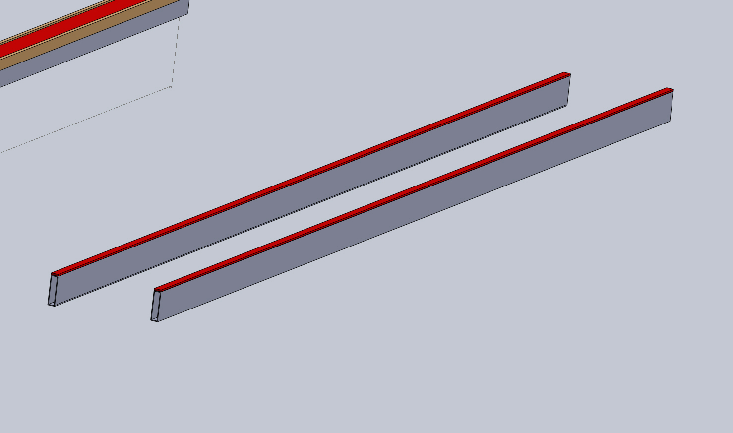

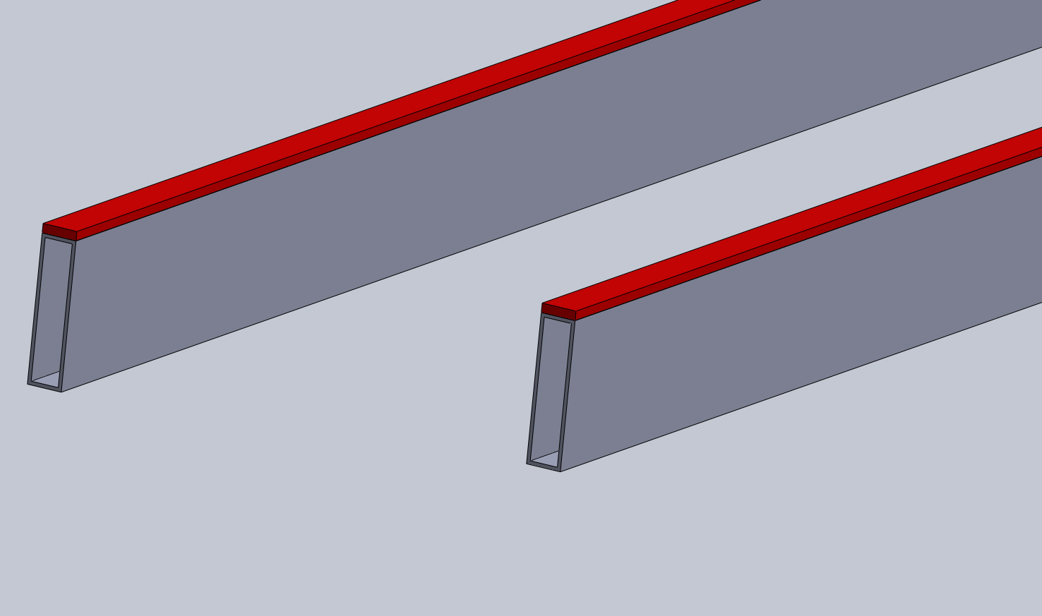

    After the epoxy get hard, we remove the spacers and we use a hacksaw blade to cut the epoxy
    We now have (or we don’t have ????)two pieces of aluminum profile with a true surface.

    MDF offsets are used to “absorb” the meniscus
    We will need nearly 0.5*6.6*300=990ml of epoxy ( for this length )

    What is your opinion?
    Does it worth to try?

    Then what are you going to do with them? You will end up with two rails that will bend when you move them.
    One of the reasons for using epoxy is so that the rails that are fixed to the frame will be on the same plane.
    Imagine a trough on the top of your rails that you fill with water it will be level in all planes it does not matter if the frame was twisted a little or out of level with the opposite rail.

    Hi Don't see much of a problem here, you say width of rails 1160 so your straight edge will span that distance, to ensure the 1800 rail is straight set the master rail onto the grout leveled frame member and lightly clamp both ends, drill and tap the frame for the hole in the centre of the rail, work your way from the centre of the rail to the ends drilling tapping correcting and fixing the rail as you go, you will have a section of rail that can be verified straight with the straight edge, all you have to do is extend the straight edge 200mm each end to set the remaining portions of rail. the second rail can be set using a fixture with carriages set on the master rail and on the one your trying to bring into spec, most find that using the gantry works OK.
    Regarding drilling and tapping you need a couple of jigs that will align in the countersunk holes of your rail, one to align the drill and one to keep the tap vertical.
