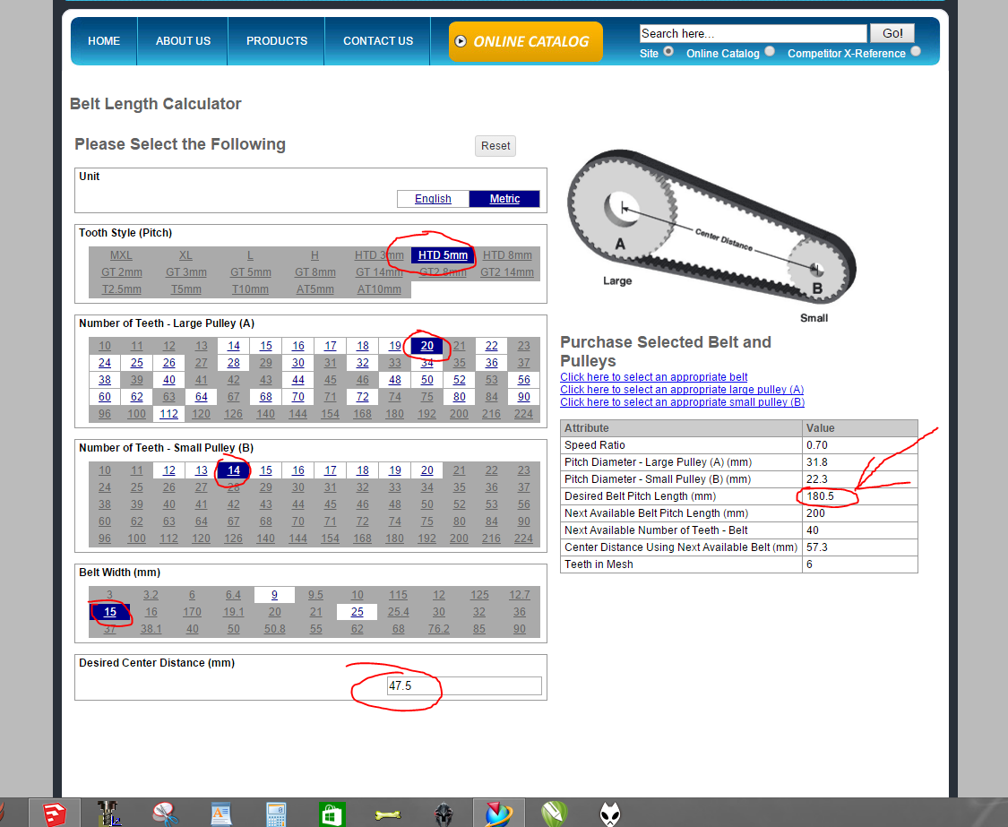

    so I just need some recommendations on two toothed pulleys with matching belt to fit a centre distance of 47.5mm

    simply Google "toothed belt pulley calculator" and plug in your numbers, all the major suppliers seem to have one,

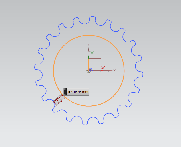

    So then you are stuck with min size pulley HTD 5m 20 teeth having in mind 20mm bore:

    Then we go to the belt calculator, play a little with it and find that voilaa, if i am not wrong you have a hit.

    we search the web for the 180mm HTD 5m belt and find that indeed there is one existing in this size:

    So more or less problem solved. Pulleys from belting online, contact them if they have the belt if not search and buy. its a good idea to pay them to bore the pulley as they do it well and wall thickness will be alright at 3mm as per drawing above.
    So problem solved? Right? if you want to mill them or to do them i could pass you a dxf drawing of any tooth count you need for HTD5 pulleys
    that is perfect, thank you very much.not sure I understand it all but I will contact them with this detail and buy a bits.many many thanks
