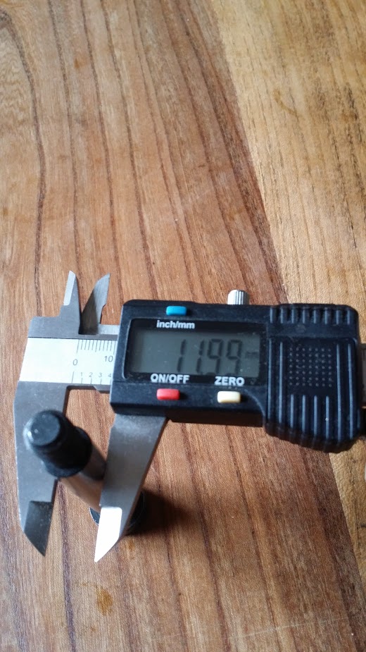

  10. #30
    Quote Originally Posted by reefy86 View Post
    just in general i was checking ebay out for the shoulder screws
    http://www.ebay.co.uk/itm/10mm-M8-SO...DKYqt_xV0EeV8A
    states nothing about tolerance just simple dimensions ect.
    Ash
    Shoulder screws are ground to specs, so a 12mm shaft shoulder screw is 12.00mm, see picture below. So i just drill a 12mm hole with a good new Dormer drill bit.
Name:	shoulder screw.jpg
