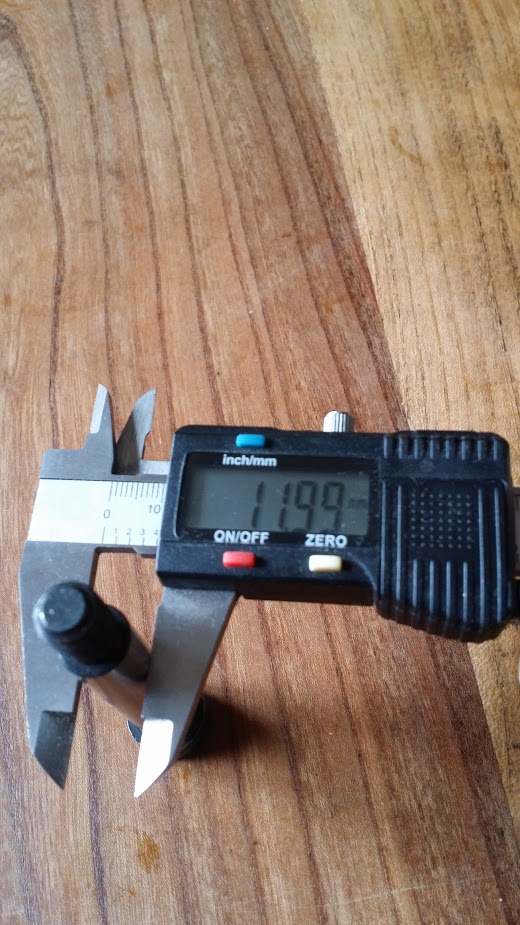

    just a quick one. if im using shoulder screws do i do the through holes 10mm which is what the shoulder screw is or do i make it slightly bigger like 10.1mm. dont want to make a mistake of inserting 10mm shoulder into 10mm hole and it gets stuck ect
  8. #28
    Ok, shoulder bolts are ground to specific tolerances on the shank. Depending where you get them from, there will be a tolerance class to them like h8 or something. That will tell you what hole size and tolerance you should specify depending on the tightness of the fit you want. Give us a link to the bolts.

  9. #29
    just in general i was checking ebay out for the shoulder screws
    http://www.ebay.co.uk/itm/10mm-M8-SO...DKYqt_xV0EeV8A
    states nothing about tolerance just simple dimensions ect. although here it has more technical info but £3.44 per screw jesus lol.
    http://www.shoulder-screws.co.uk/?gc...LnEaAskt8P8HAQ

  10. #30
    Quote Originally Posted by reefy86 View Post
    Ash
    Shoulder screws are ground to specs, so a 12mm shaft shoulder screw is 12.00mm, see picture below. So i just drill a 12mm hole with a good new Dormer drill bit.
Name:	shoulder screw.jpg
