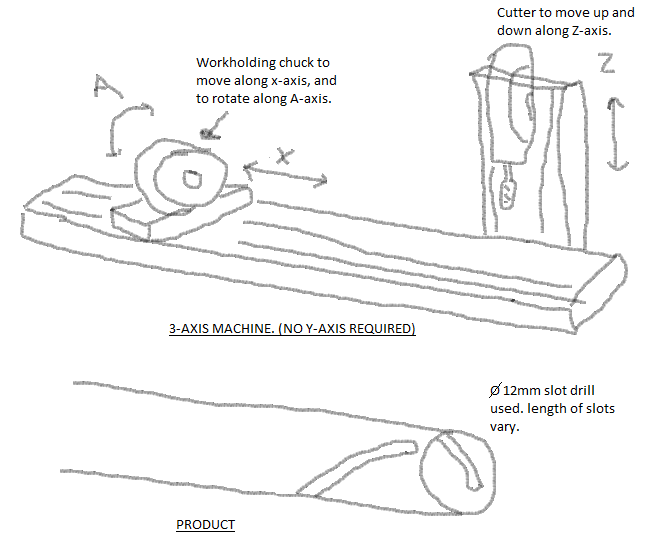

    Basically I have a scenario where I would need to build my own cnc milling machine with selective requirements.
    These are the requirements of the machined product:
    - The slot will be 12mm diameter, with varying lengths.
    - The material will be 5mm thick mild steel with a varying O.D. of 48mm to 114mm CHS.
    - The length of material will be in the range of 1400mm to 3000mm.
    The requirements of the machine so far will be:
    - able to cut 5mm thick mild steel
    - able to rotate along A axis of 0-359? degrees.
    - able to work on material diameters of 48 OD chs to 114 OD chs
    - able to work on material lengths of 1000mm to 3000mm.
    - 3 axis (X,Z,A) (note: I will not need Y axis as I plan to keep the cutting tool centralised above the CHS at all times and let the X axis and rotational A axis do all the movement. the Z axis is simply for varying material diameters and for the cutting depth.)
    - Would need to be cost effective.
    - would need to be reliable. (the intention is to machine hundreds of these parts so reliability is a major factor)
    - and finally, accuracy could be +/- 1mm.

    As for the product, it is something I prefer to keep as tight-lipped about as possible. But the slot will be of spiral shape (or helical?). It will cover no less than 90 degrees of the work piece and will be mirrored on the opposite side.
    Yes apologies, width would be the right term. (I think I said diameter because currently I have to drill two 12mm holes and link them up by using a cutting disc.)
    It is a one OR two man operation, of course depending on the size of the material needing slotted.
    I have decided I will be using a 12mm slot drill so the start of the slot will always be 9mm away from the edge of the material, regardless of length or diameter. (15mm to the centre of the first cut)
    I am on a really tight budget which is why I have listed my requirements to build a DIY machine solely for this purpose.
    I am a fabricator by trade, so any structures would be easily rattled together. Its more the motors, electrics etc etc that pickle my head.
    Steeki.

    The slot will be a maximum of 300mm from the end of the tube and no more. so that is the basic cutting area.

    its thru slots mate. Ive decided to use a 12mm slot drill to mill these slots out. Im guessing here, but maybe it would be cheaper to put together than plasma? Also running cost maybe cheaper? All I need is my machine set to a constant speed and feed rate as the material will never change, nor will the thickness.
    I will try and draw something up to explain it better. Im sure we could all understand a few drawings
    Apologies for the very basic drawing using MS Paint. But it should show what I have in mind regarding the machine, and what is required for the product.

  10. I agree with Jazz. With a slot drill you'll need a couple of fixed steadies either side of the cutter and you would have to traverse a 6m bed, to machine a 3m length, which would have to be extremely rigid over its full length.
    With plasma the work holding is much simpler, the workpiece is static in X supported on some v-rollers which are easy to fabricate, the lightweight plasma head moves in X along a 3m rail, probably using rack and pinion drive, so relatively easy and cheap to build.
