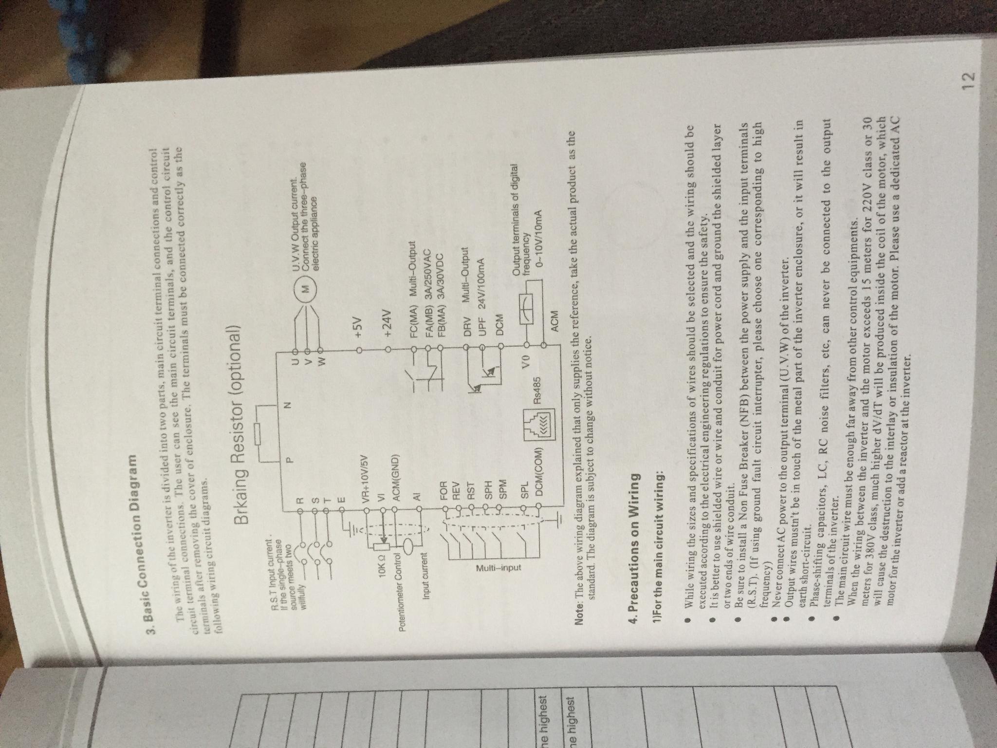

    Thanks Clive, yeah I've tried that don't suppose anyone has a diagram do they? I asked Bert but he says that it's best to look in the Hanyan VFD manual
    I have HY 2,2 book here what are you after what model is yours according to book PD160 needs to be set to 1 to enable 1-10v control
    page belowClick image for larger version.

    I need to know what I need to connect to in order to ramp up the speed and decrease
    2 mins will get pages up for youClick image for larger version.
