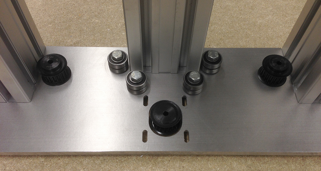

    Inside of the front plate (maybe the back, not sure yet) idler bearings to shift the belt path...

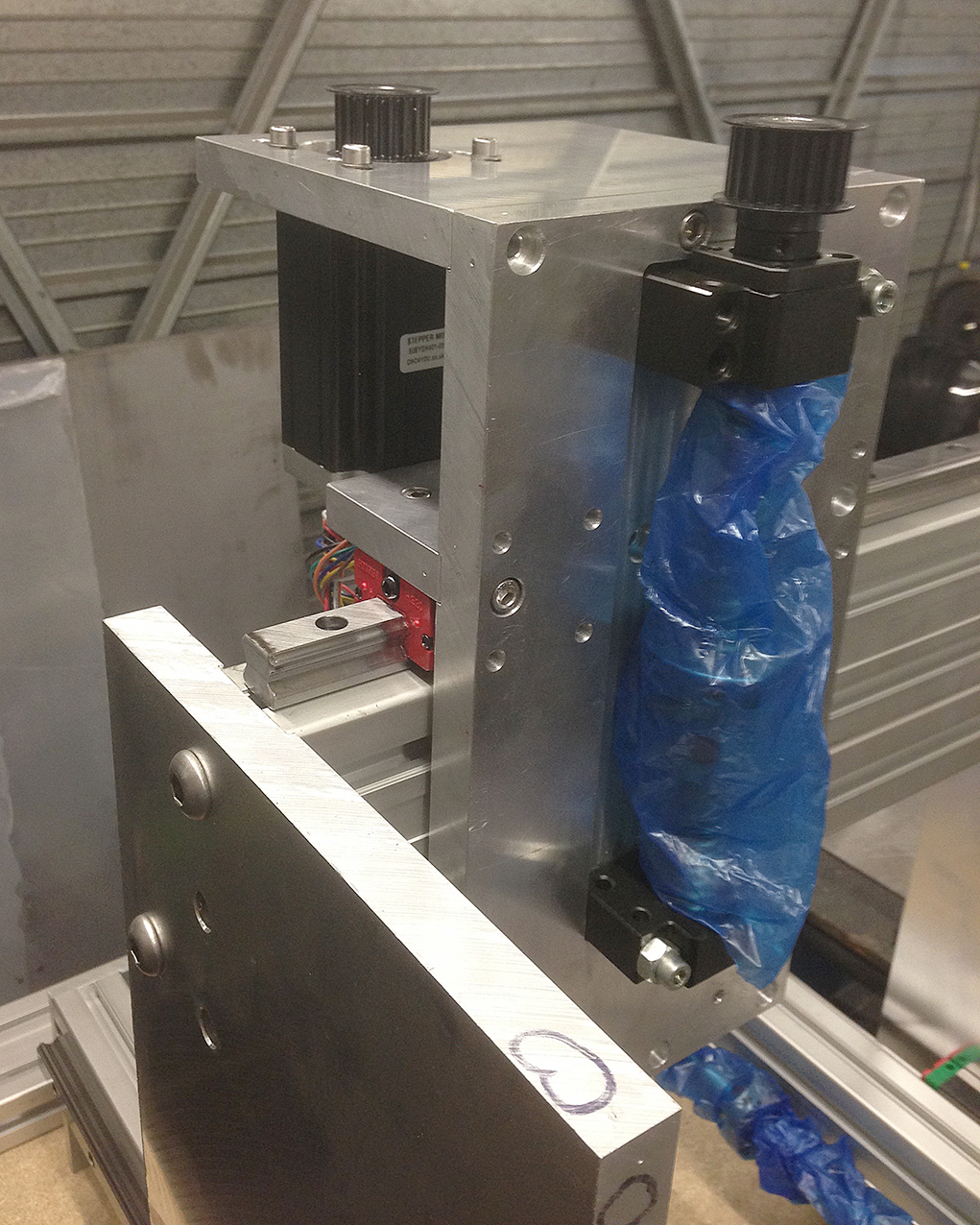

    The Z axis in place...
    Z axis lifter screw and motor fitted...
    So far, my CAD efforts have been 100% perfect, every single part drawn has fitted just where it should be Torsionally, the gantry is very stiff - pushing on one side brings an immediate response from the other which is good, the Z axis looks like it will be just as tight.

    Slight boo-boo uncovered tonight, the belts arrived and the teeth were bigger than i allowed for in my serpentine arrangement, this caused the opposing sides of the belt to rub against each other at the idlers...
    First option for fixing it was to order up some smaller diameter bearings, should work ok.
