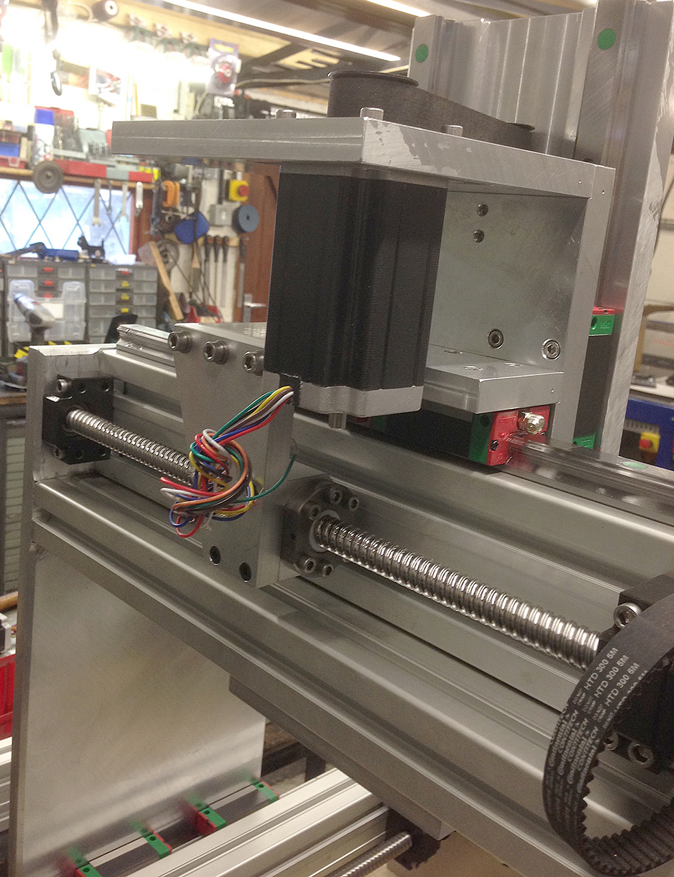

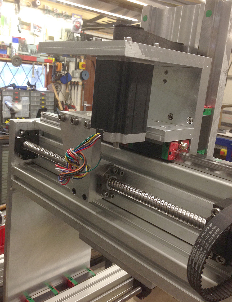

  6. #26
    Got some motion assembled today, final fitting takes a lot of time...
    Next up is making the bracket for the X axis motor. Then i might remove the grease nipples on the lower X carriages as they are costing me 20mm of travel by hitting the side frames.
    A little more fiddling here and there and we should be ok to start planning wiring runs etc.
