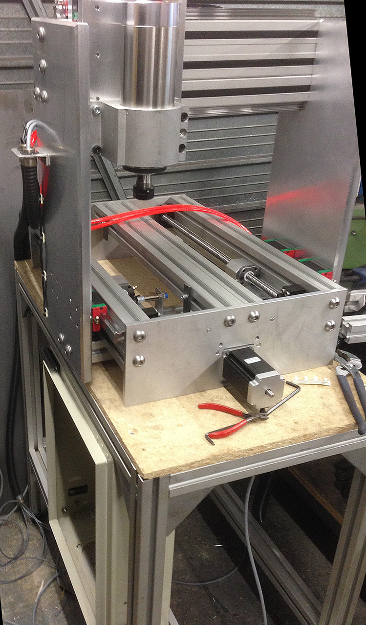

    Things are progressing...
    Leaving it on the little bench i made to build it, fits well and the electrics will fit underneath nicely.
    Since the picture was taken I have fully wired the panel and tested the safety circuit etc, this is now in the cabinet and waiting connection. The VFD is mounted behind the cabinet so i can see it from under the table, this keeps it safe from flying chips etc and away from the drive electronics.
    I have the E-stop circuit controlling the VFD and cooling pump supplies, it also has a connection to the BOB to tell Mach3 that it's in E-Stop, this circuit also functions as a No-Volt-Release system to stop the spindle restarting after a power loss.
    The pump supply and misting system solenoid is controlled from a relay board driven by the VFD internal relay so they come on and off as the VFD does, the misting supply also has a front panel switch so i can leave it off when cutting wood etc.
    Tomorrow will be wiring, testing and making the bed and fitting it hopefully.

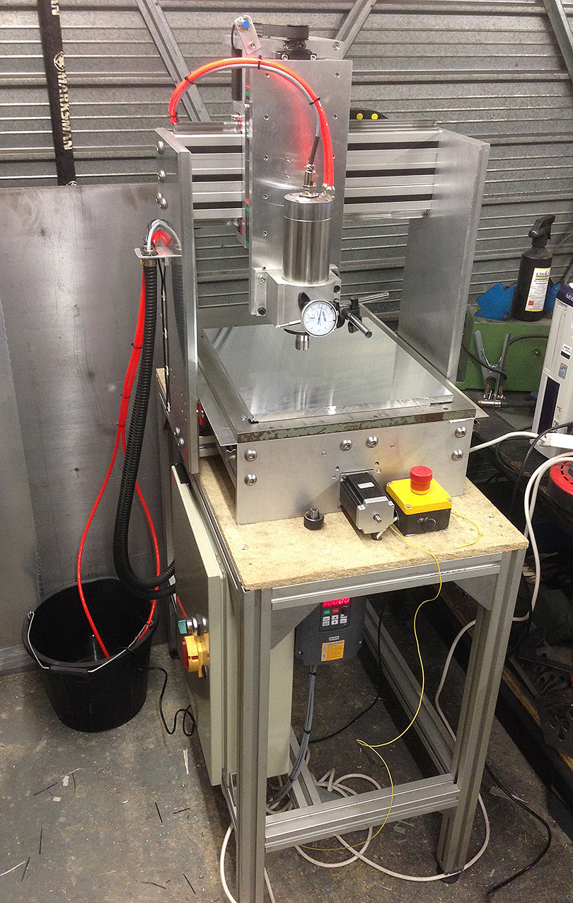

  9. #78
    Thats enough for one day ;)
    Got the main bed plate on, aluminium top-bed needs to be drilled and tapped for hold-downs etc, thats tomorrows job.
    Coming along :)

    I might have to re-visit my linear rail parallel setting - something appears to have moved slightly during build as the top-right corner of my bed seems about 0.3mm high compared to the other three which are relatively true. As you can see in the pic, I have mounted a DTI on my spindle clamp and was measuring the bed while jogging around.
    Its a bit of a pain as it means almost full strip-down, not sure i can shim the bed that much to get it happy, will have another look tomorrow.
