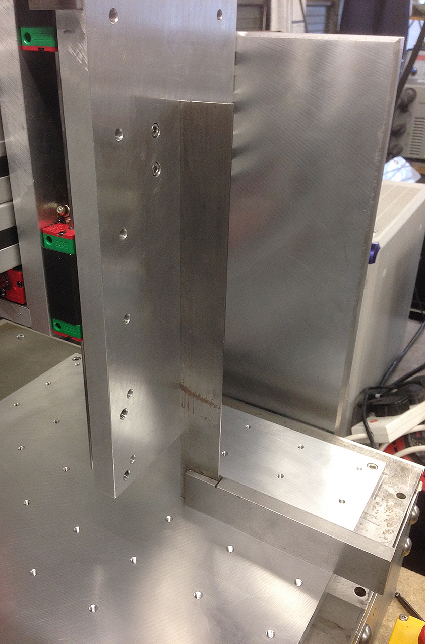

    She's done! (well just about )
    This was encouraging - A 300mm square placed on the bed and against the face of the Z axis tool mount - perfectly square, I was impressed with this little fact

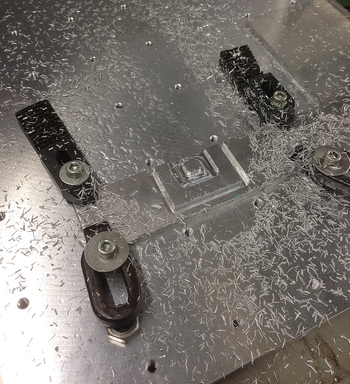

    The fixed tool-change plate for the 2010 screen-set was hastily made up from a length of nylon with an M8 bolt in the top that had the face ground flat, it lives in the top R/H corner of my bed.
    The movable plate was a simple bit of unused copper PCB.
    The tool change and probing routine took a bit of getting used to, as will the initial set-up for new materials etc, its all totally alien form my experience in plasma cutting, lots to learn.
    A lump of junk alu was then clamped down with overkill clamps and a further half an hour expended trying to figure out the correct probing routine for a new job
    The G-code i prepared was too big for the scrap so thats why it got cut off, I was running out of time :)
    I used the WD40 in one hand and the blow gun in the other, a pretty intense minute or so followed as she cut her first metal.

    Messy or what ?
    Anyway, the result was excellent, expecting a broken tool I threw in an older 5mm HSS three-flute and tweaked the g-code down from carbide speeds, this ended up at 12000rpm and 800mm/min cut with 500mm/min ramp. Ramped in to 3mm deep on the pocket and 5mm deep on the outside.
    I'm pretty stoked at the result, a simple feat but nerve-wrecking when not used a CNC before, coming from manual milling it feels odd having the control of feed and speed taken away from you!
    BTW, I removed the bed and refitted it, with minor shimming I got the variation corner-corner down to below 0.1mm which i think bearing in mind the way these machines are constructed is pretty good.

    Looking good dave and nice to see a proper Chip not dust. .
  3. #83
    I don't baby my tools, causes more trouble than needed, need a good chip to carry the heat away.
    As the scrap was smaller than the code, it ramped down mostly in air and slammed into the side of the part at full depth, didn't bother it all :)
    It was a tense moment though I must admit ;)
