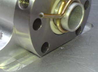

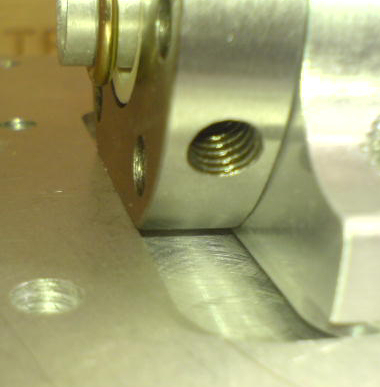

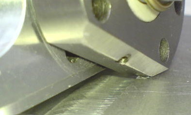

    Still trying to work out the specifics for attaching the nuts to the zoidial whilst incorporating backlash dampening. The idea i have at the moment is to use the old faithful chopping board melted into a mold around the screw but attached to the nut.
    Tip here - cut it up into chips, use a metal mold and heat that with a paint stripping gun and not the plastic, it melts wonderfully
    She cant do anything wrong in my Eye's, tonight she pulled up a chair next to me and watched me Nipping a flat on a ballnut with a bench grinder:

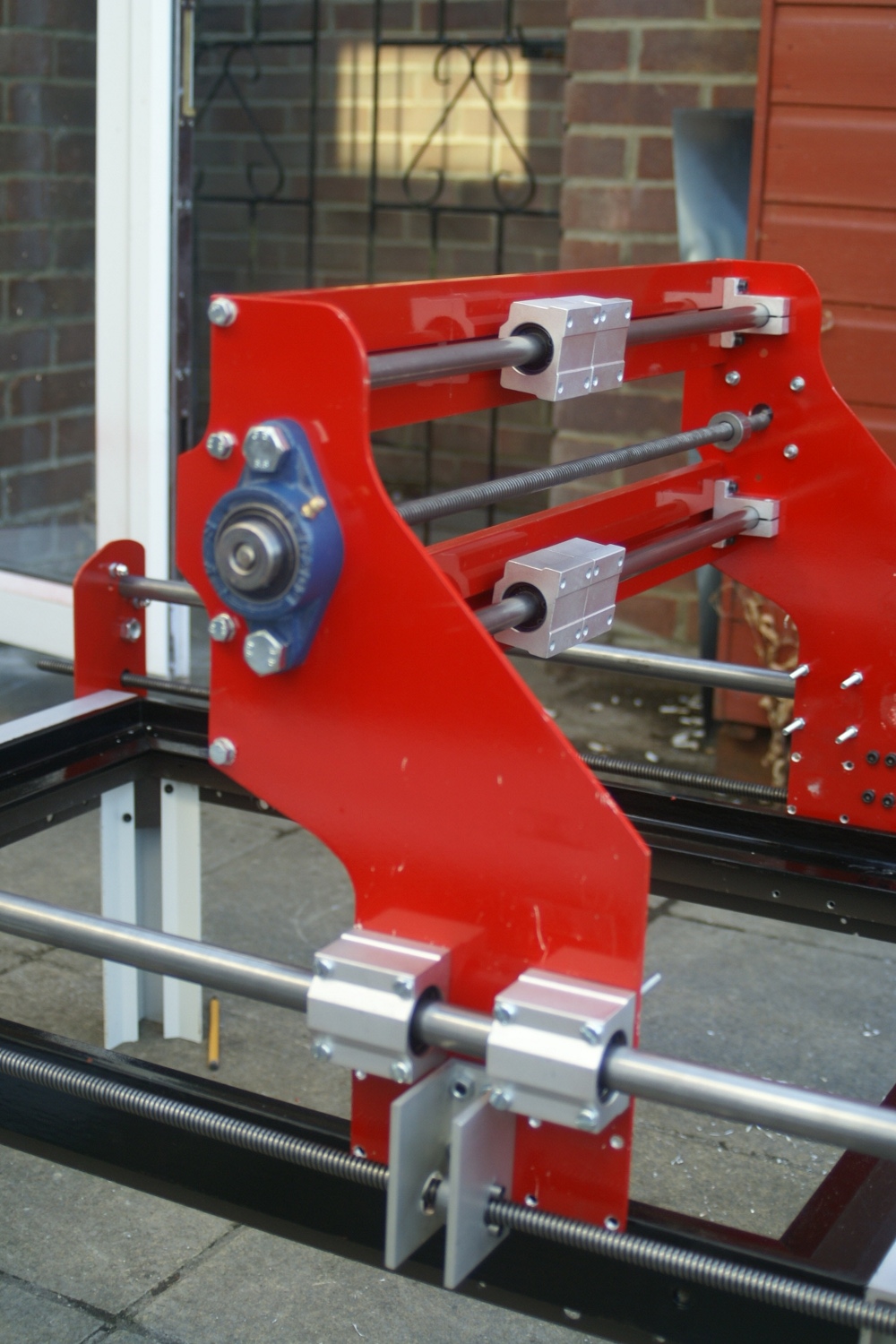

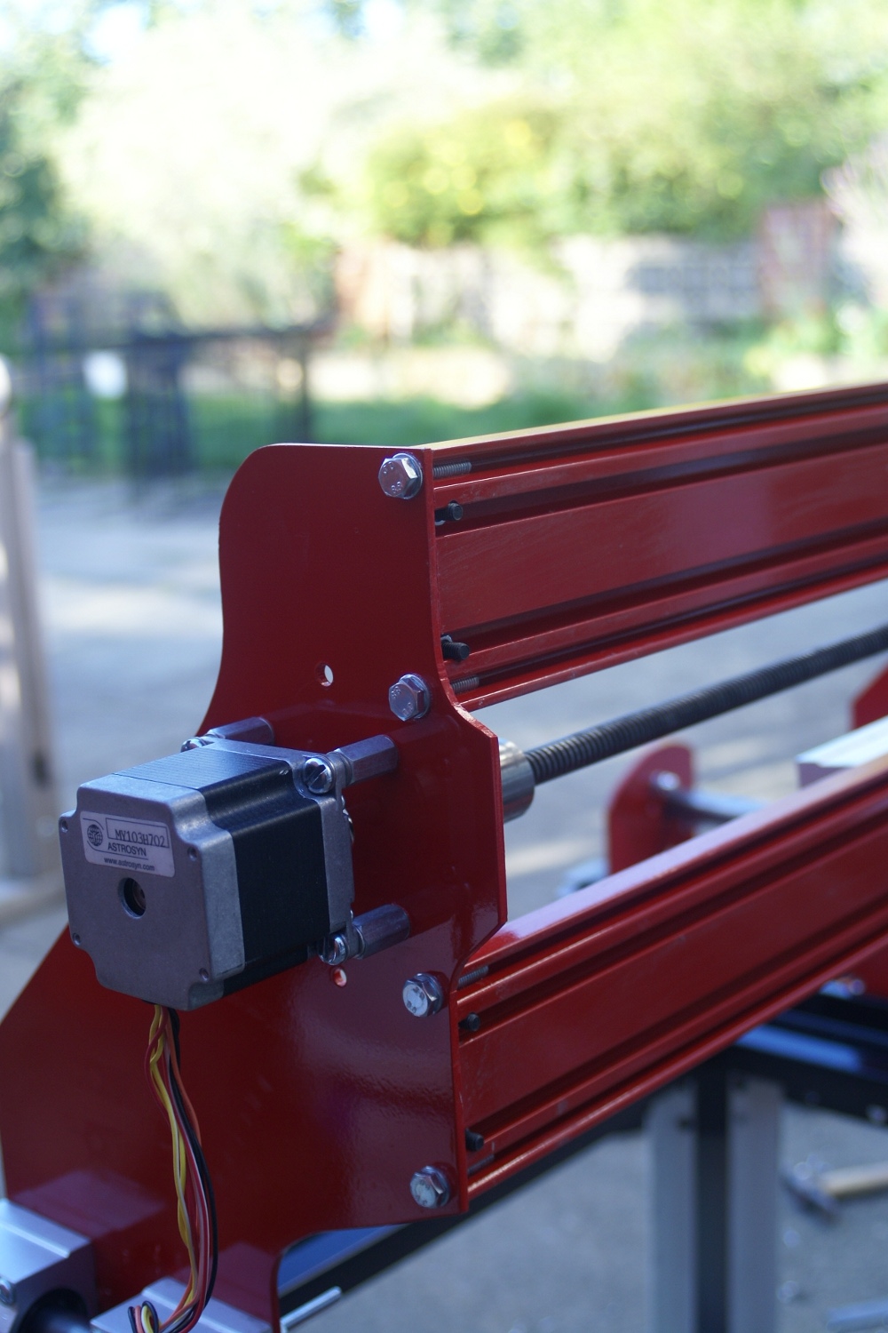

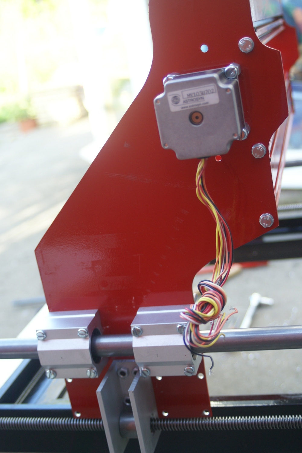

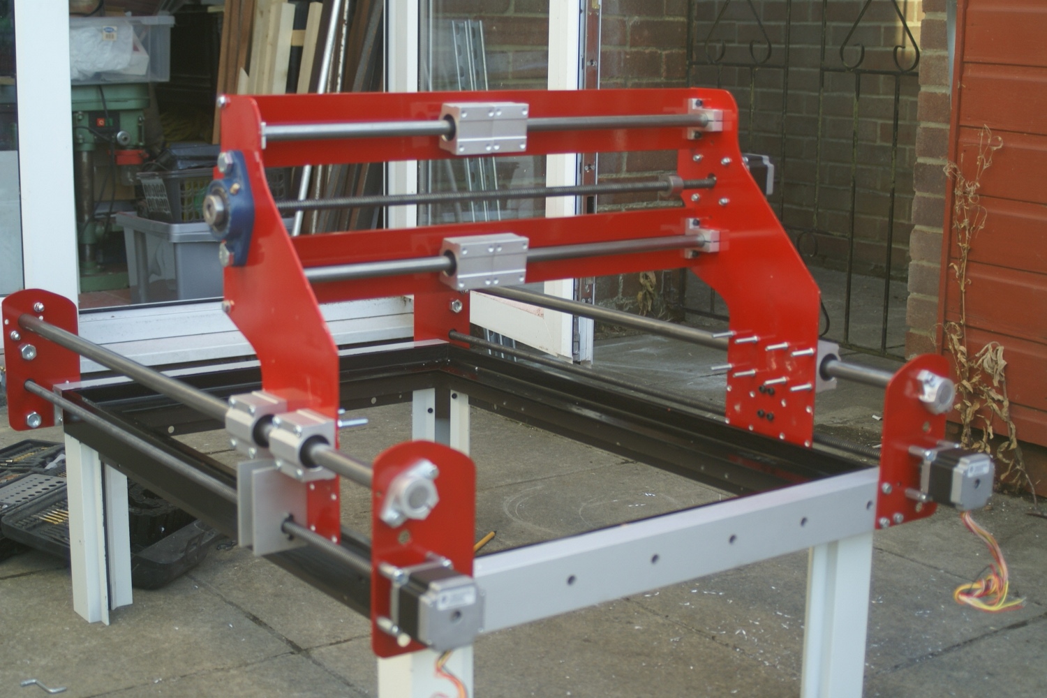

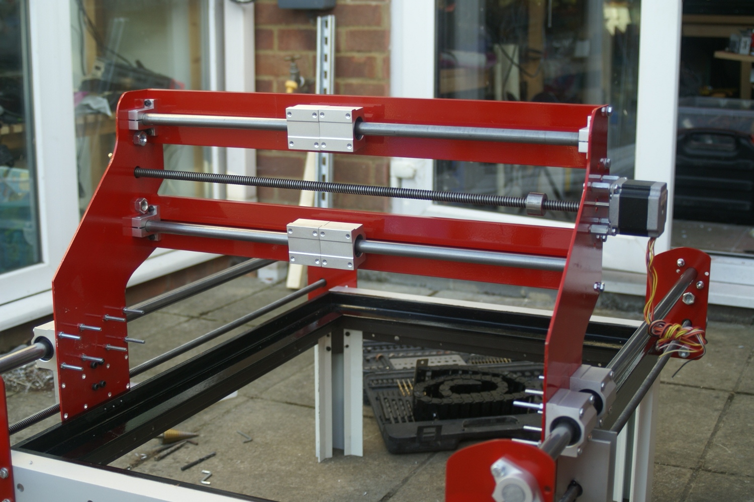

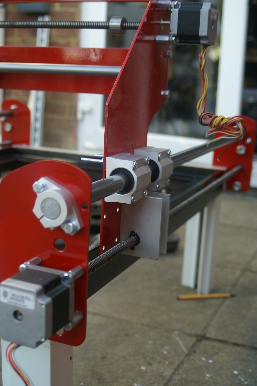

    Well i made back out into the garage this weekend and was very please with the work. Got some paint on, x axis done, y axis done and i started the z.. Will probably do some more during the week.

    I nearly painted it British racing green only because i has some paint in the garage but decided to splash out. Shame its all scratched to buggery already.

    Right i am really hacked off...:evil: only had a bit of time today to get on with build. The Z axis is causing me the most grief. Tried a couple of different things this week with the plan on completing it today. All i have done is gone back to square 1. Arghhhhhhhhhhhhhhh! does everybody get to this point in the same mood???? I suppose this is what happens when you don't do it from a plan:nope:
  8. #18
    I'm sure we have at some point, if you would like to elaborate some more im sure we can help :)
  9. #19
    Hi Lee.....Not so much as a problem just lack of material and not to mention this would be an ideal time to have another cnc machine to cut you parts if you know what i mean
  10. #20
    oo late for some pics tonight.....I was aiming for the slide to be no wider than 110mm, i have 16mm rail on the same type bearings i used for the rest. the main problem is using 4mm ali sheet (bad idea). These imported bearings are spot on except the mounting holes. I was also trying to use the same type of rail supports i used for the Y. im thinking now finish it of in MDF and make the parts afterwards when i can get me hands on some more material. Does that sound more sensible???
