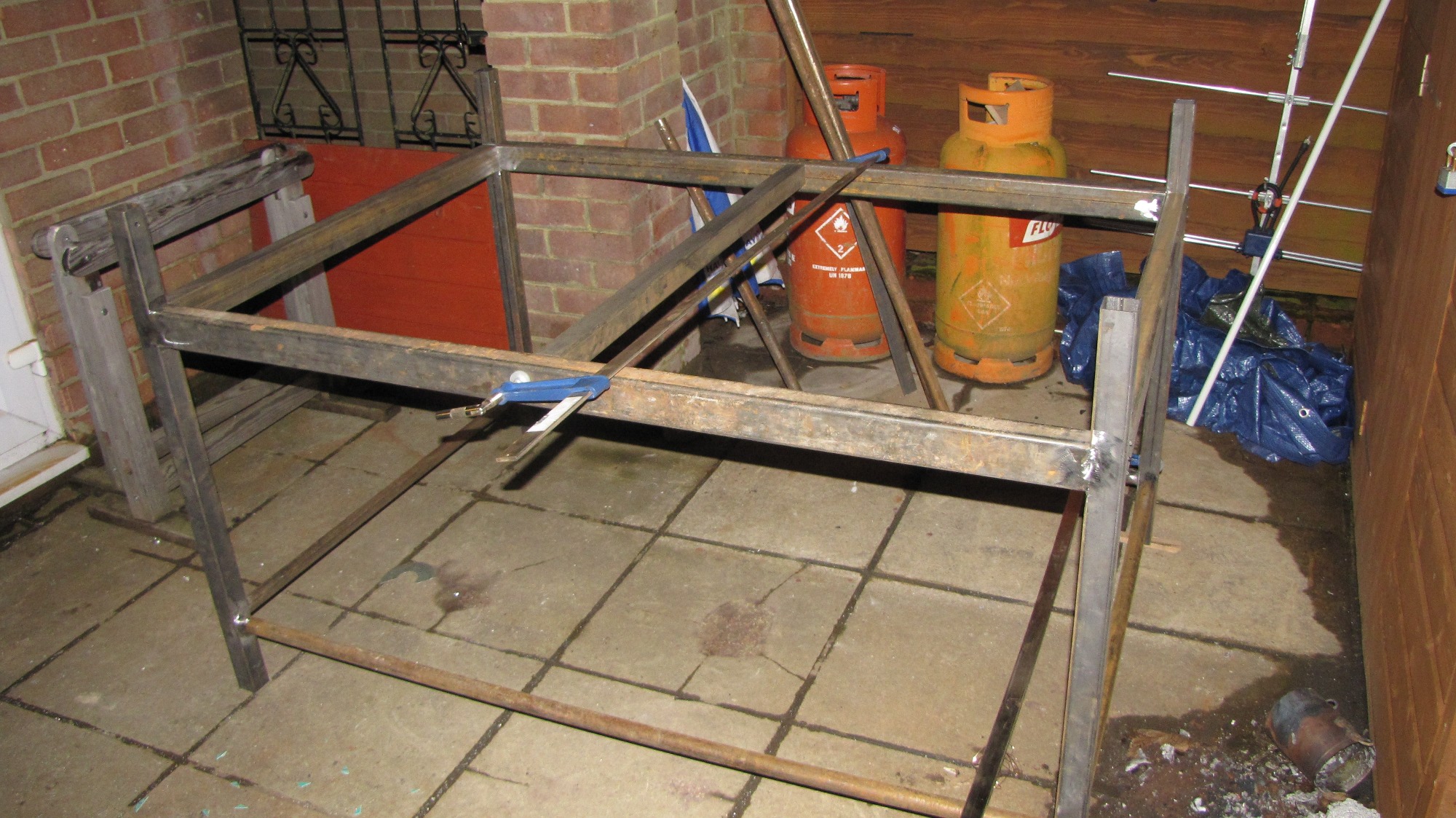

    No games this time Lee, been following every thread going on belt drive and i believe i have taken the best bits and formulated a reasonable design of my own. Already purchased 30mm X rails, 25mm Y rails and 16mm Z rails with perspective linear bearings. Have 50mm box section and angle in place to build the table. Just trying to source 10mm Ali plates for the Y sides Z faces. Its going to fun trying to drill and tap out the ends of the rails on my little lathe??? One thing for sure this is going to be a heavy little beast.

    Dont get too exited about size, the rail entghs are only 1.4m for the 30mm and 1m for the 25mm. The spec is to be able to cut half sheets (4'x2'). This is realistic as to what i can fit into my workshop (garage), i'm also going to experiment with a home built spindle model based round a straight shank ER32 collt chuck. That 500w fern hole saw is just way tooooooo noisey.
    Been very busy today and managed to get the frame built, run out of welding wire 3/4 way through and had to go out and get more. There is always something to interrupt the flow, what was more bloody annoying was the welder not working properly after changing the wire???? anyway i will get the frame top finished tomorrow and maybe some paint, shave a bit off the X rails and grab a beer

    Anybody recommend a good brush on paint that does not streak? goint to have to do this paint ob outside due to limited room the workshop to spray it :-(

    Hammerite! or smoothrite....
    Brilliant stuff, i'd eat it for breakfast as well as paint metalwork with it if I could....
    Looking forward to this thread, planning a wee build of my own, not just as big, particularly interested in the pulleys, belts and motors being used.
    Not sure about the hammerite?? was hoping for something a bit better as even that leaves streaks...as for the belt system well we will have to wait and see how that turns out, buying the right type of belt can work out just as expensive as leadscrews.
