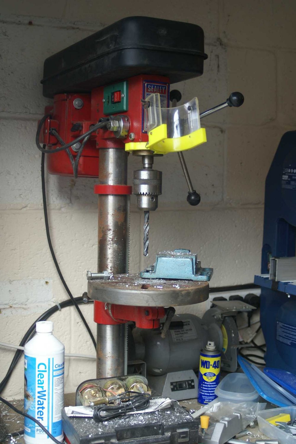

    As promised - some pics of it so far and some of my favorite toys. The gantry sides for Y i cut again after doing some measuring (this helps). The best toy in the shop is the metal chop saw, it has one huge motor for a nice slow torquey cut. By the way they say never work with kids and animals.

    that was in the plan until i fitted what i had then decided against it. It is a lot sturdier than it looks. i might beef up the gantry sides with an mdf skeleton doubler?
