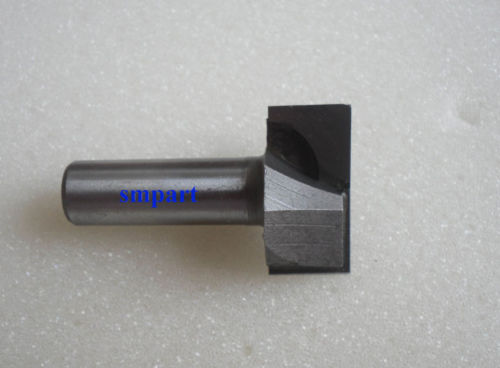

    -you may need a dedicated surfacing bit at least 1", where 2" is the maximum for the type of your holder and spindle power. There are expensive ones and cheap ones as bellow
