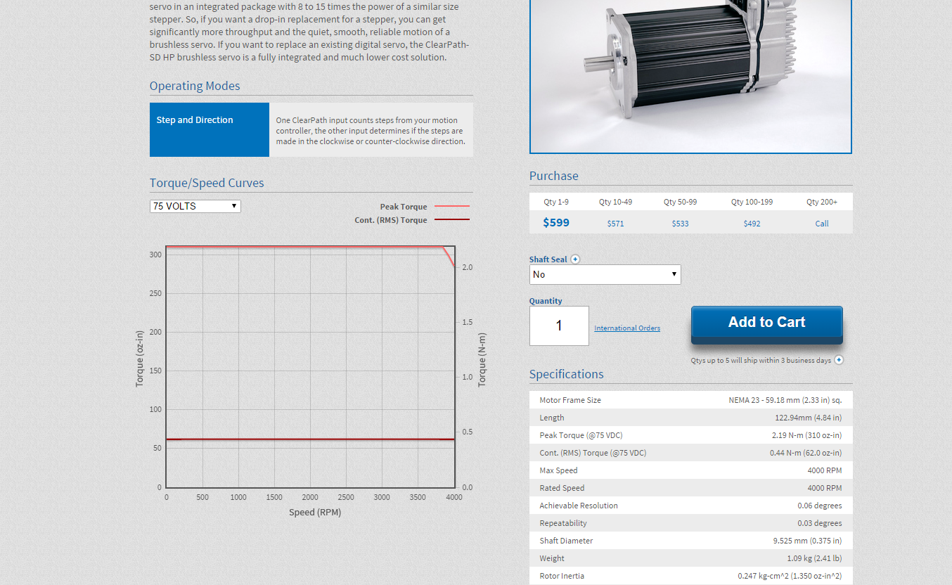

    I was speaking about their so called "Stepper Killer" :
Name:	stepper killer.PNG

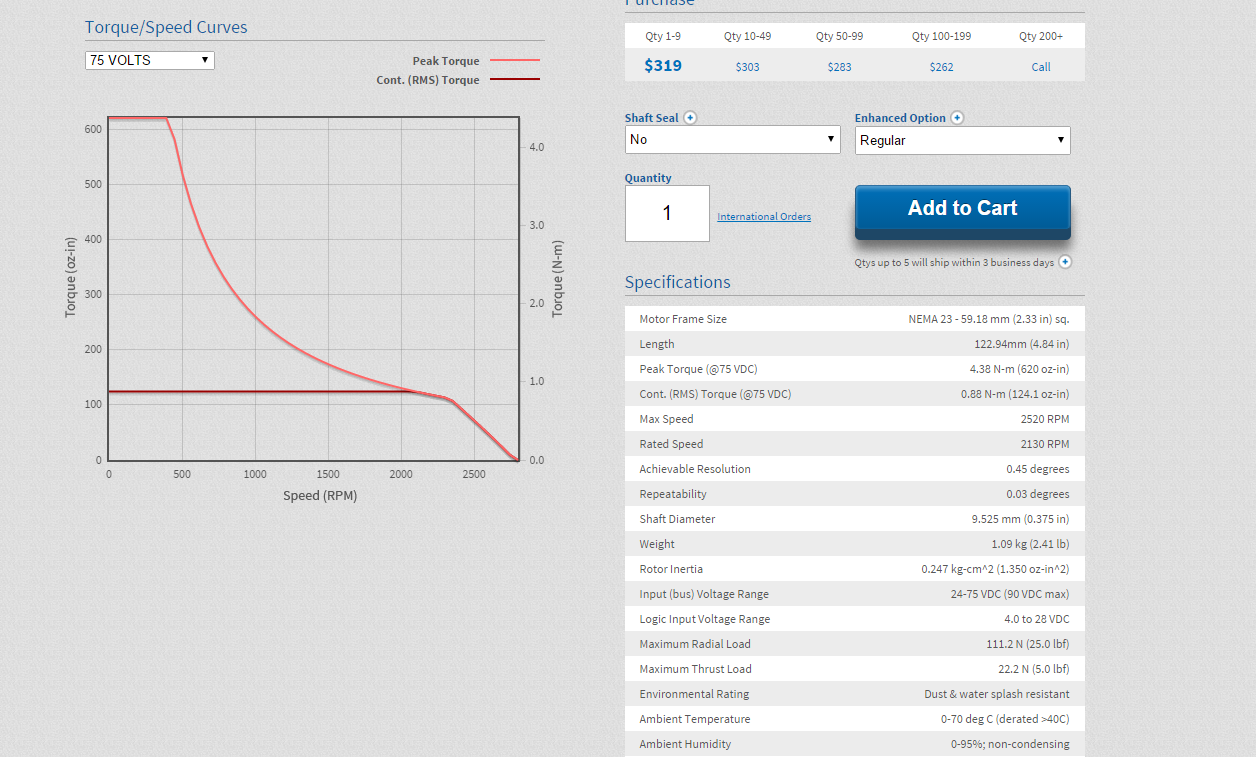

    it seems the true servo is their so called " High Power"
Name:	stepper killer 2.PNG

    Def are not Steppers. They are DC servo motors just of lower rating to the higher power version.
    check this out which is I believe the exact motor you have been looking at. Listen then tell me if thats a Stepper.. or not.!!
    You are absolutely right. I was wrong. This could not be stepper motor. They move absolutely nicely for sure. Its like music to my ears
