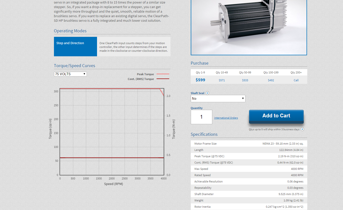

    I looked around, while they may seem right for Americans, i doubt their value for us. The "stepper killer" seems not a true servo but a closed loop stepper motor, judging from torque at speeds, prices from >300$,
    No they are proper DC servo motor and light years better than stepper system. Plus the question was if money wasn't a concern.
    You can't possibly compare them to cheap chinese servos because the quality of these would be like comparing to high end Yaskawa or Mitsubishi. It Would be like comparing Apples with oranges.!!

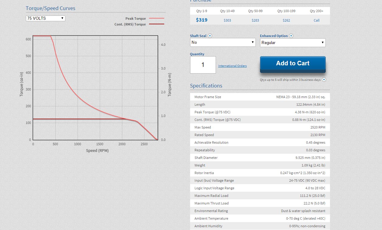

    Still not sure about that. Just look at torque curve and encoder count so you would see thats the case. Bellow compared the strongest nema 23 from both series. All same as Lead shine, which also make integrated motors
    I was speaking about their so called "Stepper Killer" :
Name:	stepper killer.PNG
    it seems the true servo is their so called " High Power"
Name:	stepper killer 2.PNG
    Def are not Steppers. They are DC servo motors just of lower rating to the higher power version.
    check this out which is I believe the exact motor you have been looking at. Listen then tell me if thats a Stepper.. or not.!!
    You are absolutely right. I was wrong. This could not be stepper motor. They move absolutely nicely for sure. Its like music to my ears
