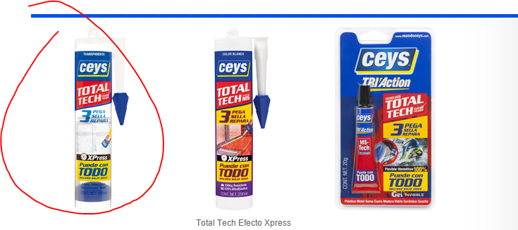

    We don't have that in the UK. It looks like 'PinkGrip' but maybe it's differnt? http://www.everbuild.co.uk/pinkgrip/pinkgrip-1
    I wonder what the technical name of this adhesive is?

    No, what i am saying is maybe some kind of polyurethane or silicone, what you say is polyester type glue, similar to what they use to fit doors and windows at houses, very easy to spot, look at sheet and when you see that " Do not use on polystyrene/Styrofoam/expanded polyurethane "

    While searching for other glue, i found this one, that seems it will definetely do the job:
    PU18 Black Flexible Polyurethane Adhesive
