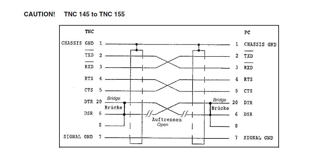

    ...this is where i need help, i have no idea where to start when linking the computer to the machine and transfering the programme. I have a rs232 cable & serial adaptor which i have had much success with on a harrison alpha lathe, does anyone know of a step by step guide to linking a 145? I've read a lot about 151's but cant seem to find much for the 145.

    I had the same issue with distance between machine and computer - commercial wireless duplex RS232 units are a silly price and I eliminated them on cost. I did experiment with Bluetooth devices, but it just wasn't reliable enough - there are enough issues feeding the controller without having to worry about the integrity of the data ! So I made up a long lead - it's not difficult.

    c/ Cable wiring needs to be correct - see that link - standard cables rarely work, they need customising.
    d/ The TNC needs setting up for correct baud rate etc

    Yeah i think it sounds like the cable, i've been told pin layout will be different on the one i have... So ive just been to maplins for the bits to make up a new one :).

    Wired cable up 2-2, 3-3, 5-7 and still no joy. Will try with 4-8 6-4 7-5 and 20-6 aswell and see how we get on (wiring from post on cnczone).

    There is a Heidenhain publication called
    Data Interfaces
    of HEIDENHAIN Devices
    Service Manual
    Google it and down load - if you can't find it pm me your email address and I'll send you a copy.
    It describes all the parameters and setting for the various controllers for RS232 comms - this is a small extract that is probably in your manual anyway but it has far more detail
