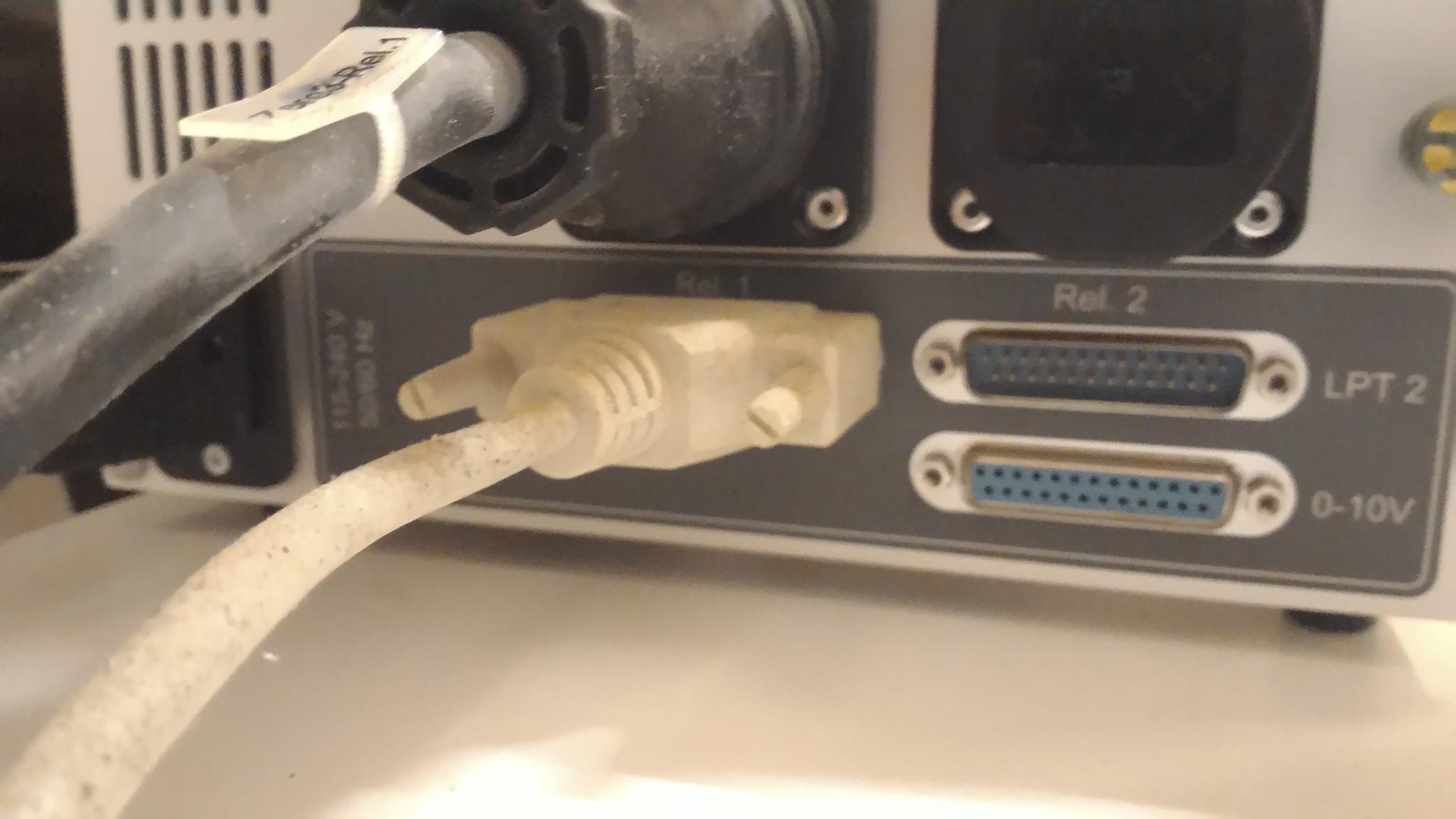

    In advance of receiving a new Zero3 controller to replace my damaged Zero2 on my S1000-T, I have been trying to figure out how to connect my new Huanyung VFD spindle to it. According to the literature it is compatible and I have spoken to Heiz, but I just don't understand what they mean and I'm feeling rather stupid .

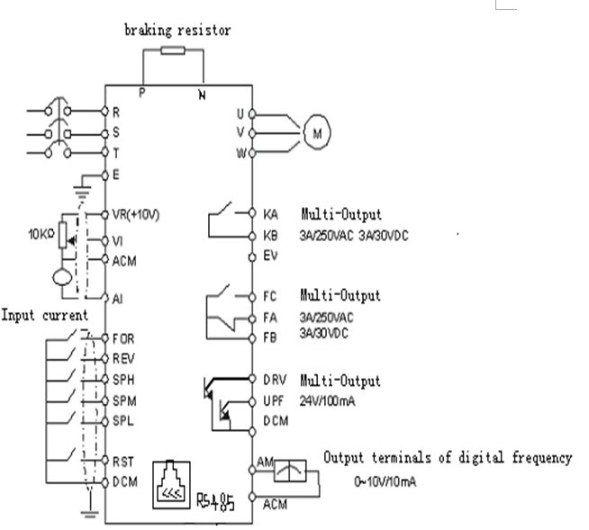

    I know I need to connect FOR to DCM on the VFD and also that I need to feed 0-10V between VI and ACM, but I'm unsure which ports & pins these are and what common grounds to use. It's the LPT2 & 0-10V ports that are doing it for me. Heiz tell me that I connect the VFD to both?

    On the VFd side typically VI is +, so are you sure about that schematics? Typically on any VFD i have seen VI is + and from diagram ACM must be the common, so double check that. Read manual cause may be depends if you have changed somewhere parameter "sinking" and "sourcing" and that changes. Depending on what region is set the VFD i mean that could change and be oposite, so take care and set it for EU. Cause maybe line HZ and voltage input is also not set right.

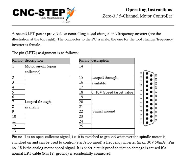

    The controller is a complete unit so it incorporates the breakout board as such, LPT1 input. I know that they have added an analogue 0-10V output for the VFD somewhere in the other 2 ports (LPT2 & 0-10V) but I don't understand what to connect. To me it looked like LPT2 is for a second command cable from the PC, but then there are no pin diagrams for the 0-10V port. Heiz have told me to 'connect the Inverter to the Port 0-10V and to the LPT2 port'. Am I just being stupid?
    The VI is a +ve voltage okay and I have the VFD running on it's own by jumping FOR & DCM and a 10k pot on ACM, VI & +10V. It's just the control from the controller that's causing me a headache.

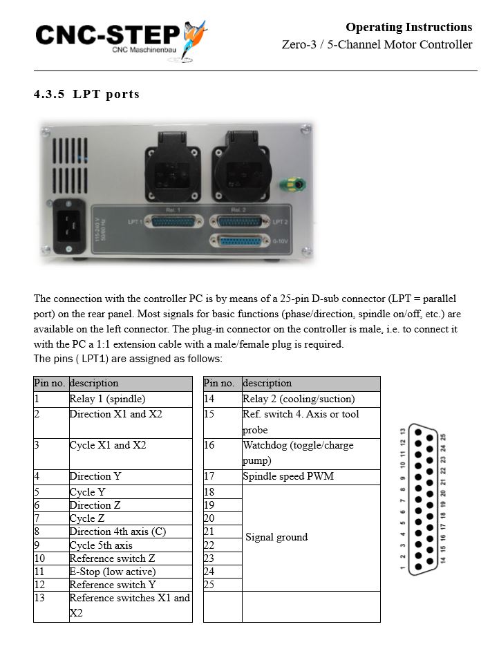

    I read again what they say. So it seems from LPT2 pin 18 is the +10VDC, but you have to ask them again , where to take the - from.
    That can not be right the breakout board and spindle control to have same common ground and power supply. But maybe they made it like that.

    That was my worry. They are two separate units and don't have a common ground. Added to that one is a digital common ground for the start forward and one is an analogue ground for speed, so different I presume?
    I haven't received the CNC controller yet so I can't probe any ports at the moment. I'm still trying to figure out what the lower 25 pin 0-10V port is for

    Hey, i missed that. They must not have a common ground or connections to current from other circuits. They must be isolated. I speak for the 0-10VDC. Not for the ground of the box and the VFD ground. Thats why usually they are on separate PSU, the spindle speed control i mean. Assuming that they have that integrated, you only need to know wher to take + and - from. Nothing more.
    In fact you must measure with multimeter to check continuity between spindle control - / 0-10VDC/ and VFD - input/ for the speed control/. There must be none.
    Start forward on spindle, typically is implemented on VFD by closing a contact. usually the VFD provides the 24VDC and from breakout board side just a relay has to be closed, then the VFD knows to start. Once the relay is off, the VFD stops the motor. Look at the picture of your VFD schematics and you will see it. Anything different from that would be very strange.

    This is the schematics for the VFD.
    Should I connect pin 18 of 0-10V port to AI and GND to any of the pins 19-25 for speed control?
    To turn on the spindle do I need a relay? I guess I can't use the open collector output because it shares the same ground in zero3 but not on the VFD?
    How should I accomplish this? Use relay connected to any free ports? Which coil voltage should I use then?
