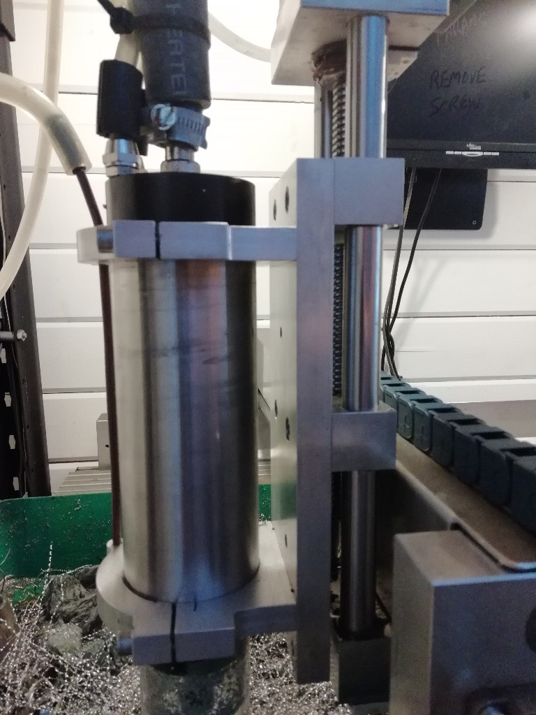

    It was an easy enough install but you will need to make mounts for the new spindle to attach to the HEIZ. This is my effort:

    It's the 1.5Kw water cooled spindle that I bought with the body dia. of 65mm. I used a standard LPT cable for LPT2 and built a separate control panel.

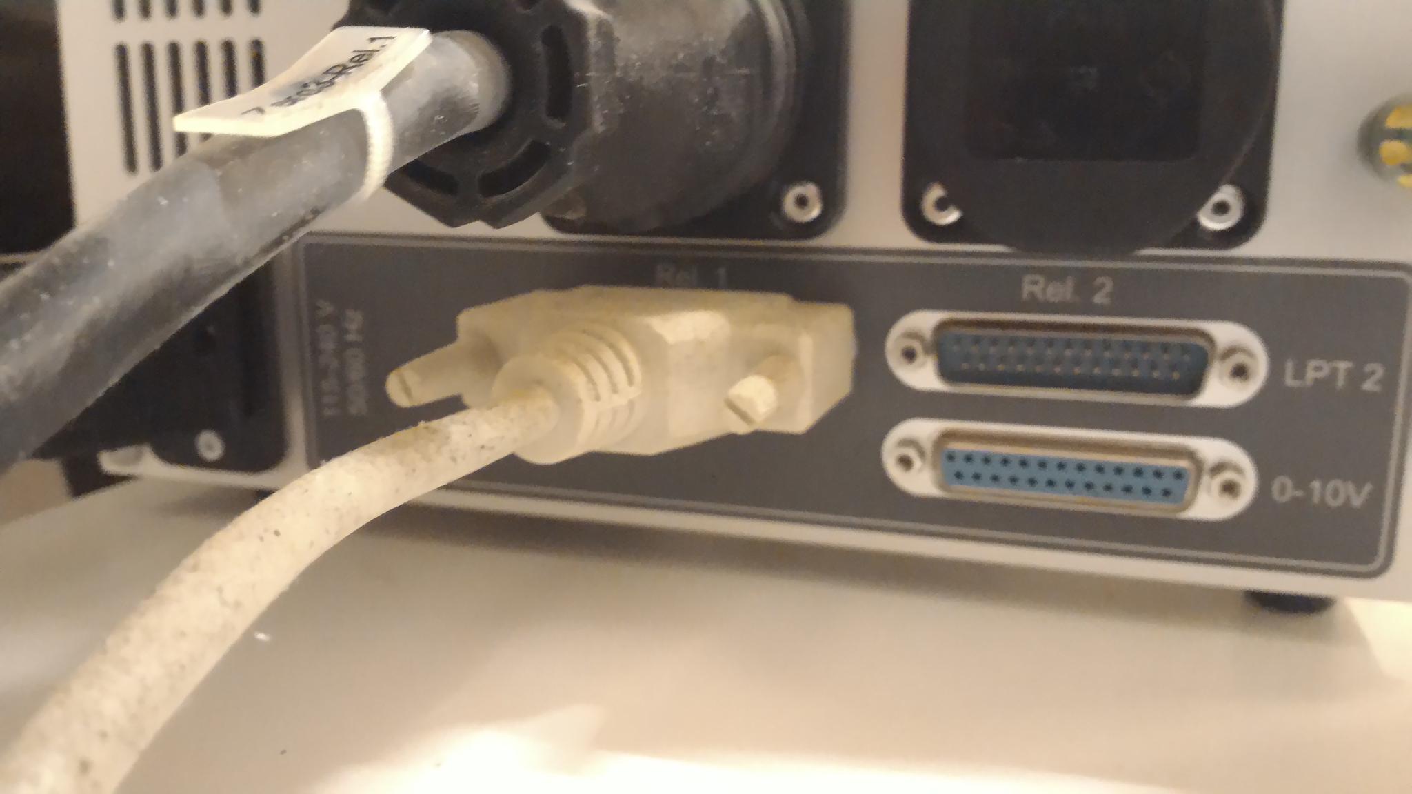

    Well i've noticed that my Zero3 controller has an extra output, under LPT2, they don't have any documentation about it. Is it an output for the VFD?

    Hello all,
    I'm in the same situation. I've ordered a Chinese HQD 2.2kw spindle with sunfar vfd.
    I don't understand the logic in zero3 controller. I use cncpod2 and kinetic NC together with zero3 controller.
    This is the schematics for the VFD.
    Should I connect pin 18 of 0-10V port to AI and GND to any of the pins 19-25 for speed control?
    To turn on the spindle do I need a relay? I guess I can't use the open collector output because it shares the same ground in zero3 but not on the VFD?
    How should I accomplish this? Use relay connected to any free ports? Which coil voltage should I use then?
    Sorry about all the questions.
    Thanks in advance.
    Br
    Anders
    Skickat från min LYA-L29 via Tapatalk
