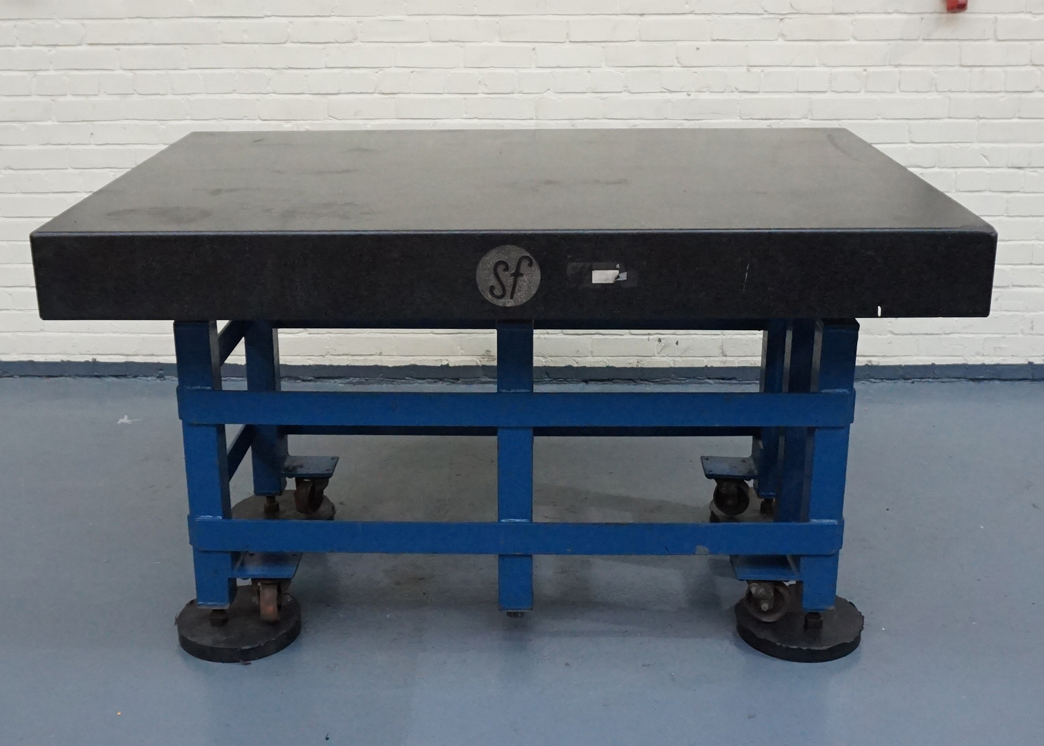

    Done on one of these Click image for larger version.

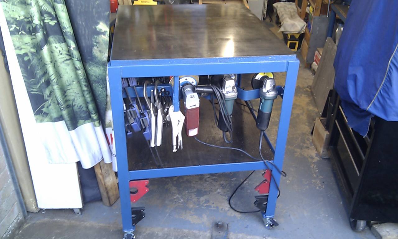

    I have cast iron one 275kg. This help me a lot with my weldingClick image for larger version.
Name:	My welding table.jpg
  6. #156
    These lovely welding benches :)
    How do you keep spatter off of them?
  7. #157
    Dave the one I linked to is 150mm granite so the splatter does not stick
