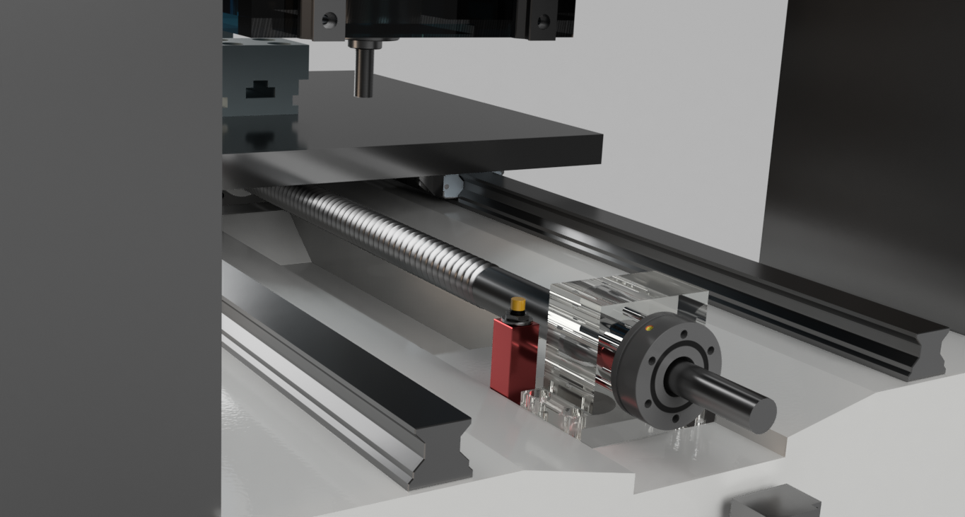

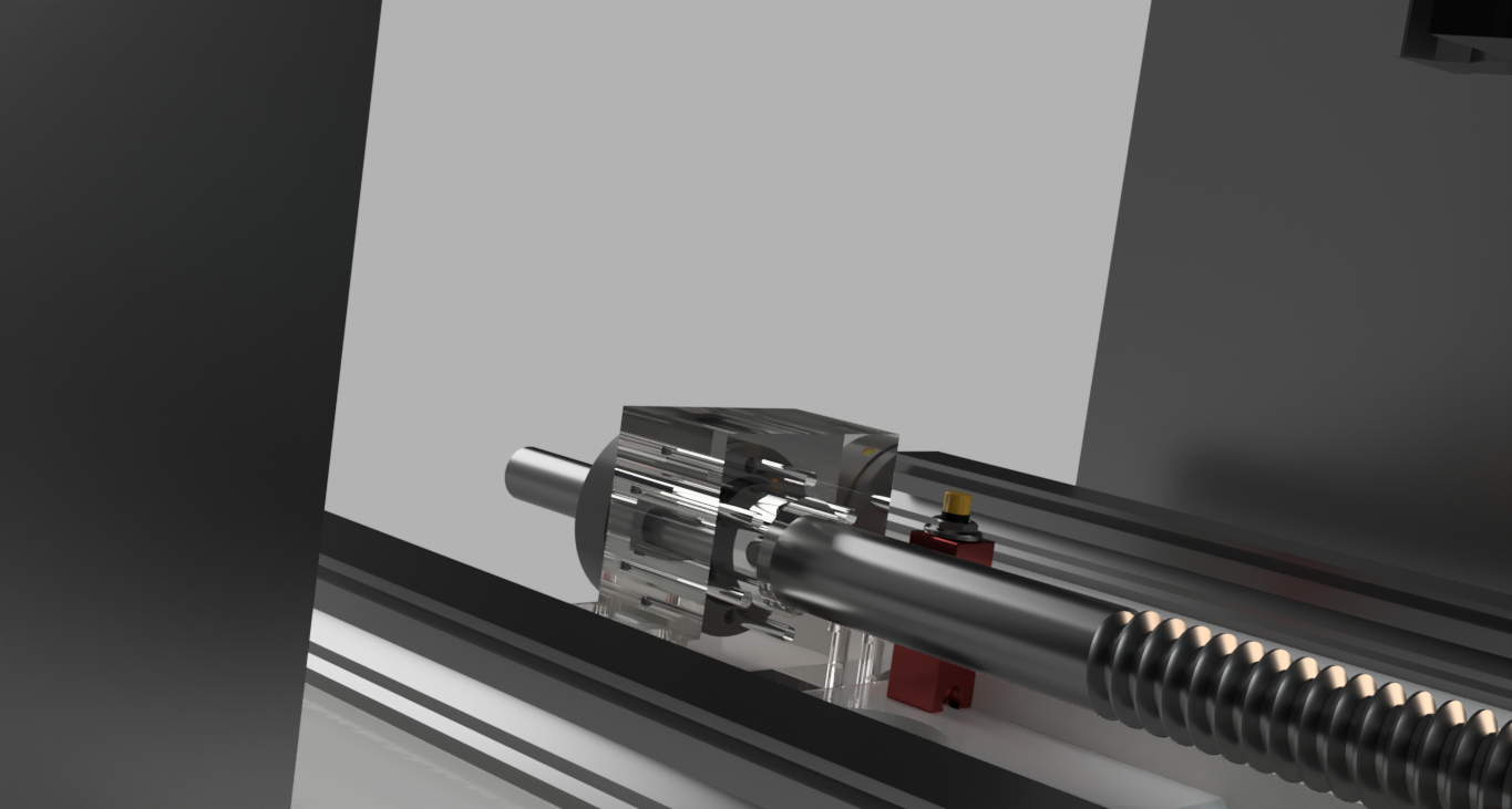

    Some update after a long absence (and winter).
    Gantry is now epoxied to the main structure. Waiting for the epoxy to harden fully before taking away the jacks / hoist to see if it holds the estimated 700 kg gantry.
    Busy drawing up the proxy mount parts and did some testing with them.
    Id like to add limit switches, can I use proxy switches in series or best to go mechanical for these? I want to use all in series going to a single input in CS Labs / Mach 3.
