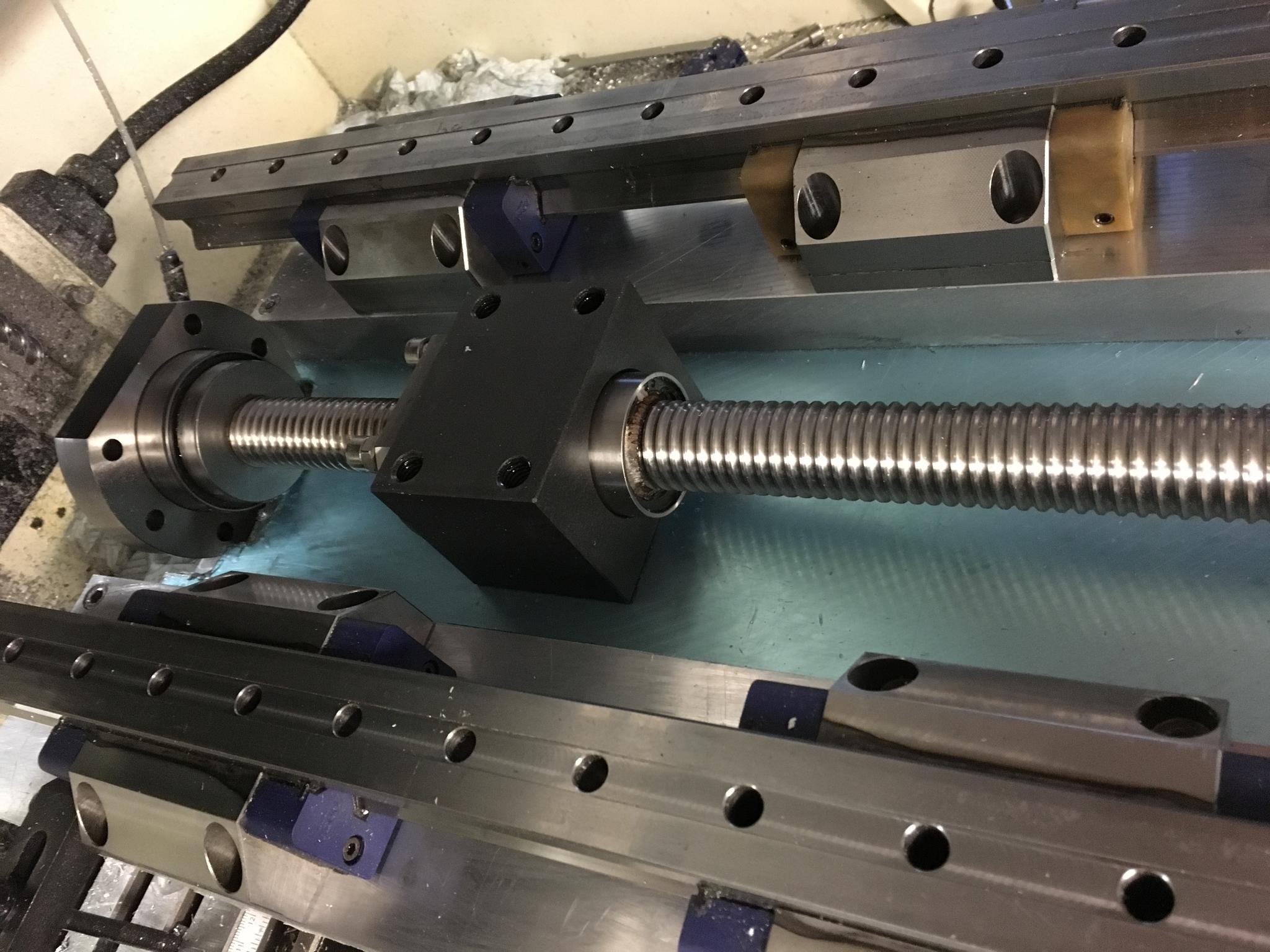

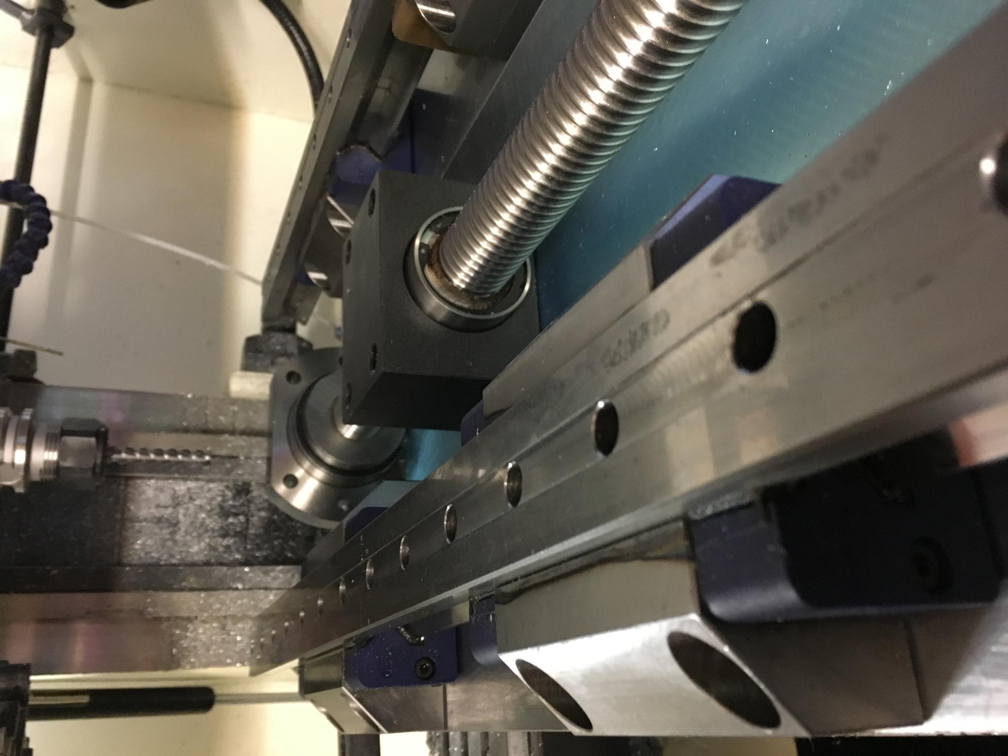

    X Rails - Bosch Rexroth 45mm rails, 1180mm long using high preload roller bearing carts.
    Y Rails - as above.
    Z Rails - INA 25mm rails, 346mm long (I'm trying to source 500mm rails) with roller bearing carts.
    Ballscrews, well, I have a selection. For X and Y I have 6 leadscrews, all 40mm with dual preloaded ballnuts and different pitch options from 10 to 20 mm.
    For Z, I have some Eisenmann screws, 32mm, 5mm Lead, dual preload ballnut.
    Motorwise, I may have jumped the gun a bit but I am hoping that with all the different options of screws (all use 3080 mounting bearing) that Ill find something that works well in terms of pulley ratios.
    I have gone for Panasonic Servos, A4 range. 1.5KW for Y, 750W for X and Z. All of this will be controlled with the CS Labs IP-A unit.

    I forgot to add pics of the hardware.
    Below, my hand for scale / size. I can now understand why the shipment was 200 kg :-)
