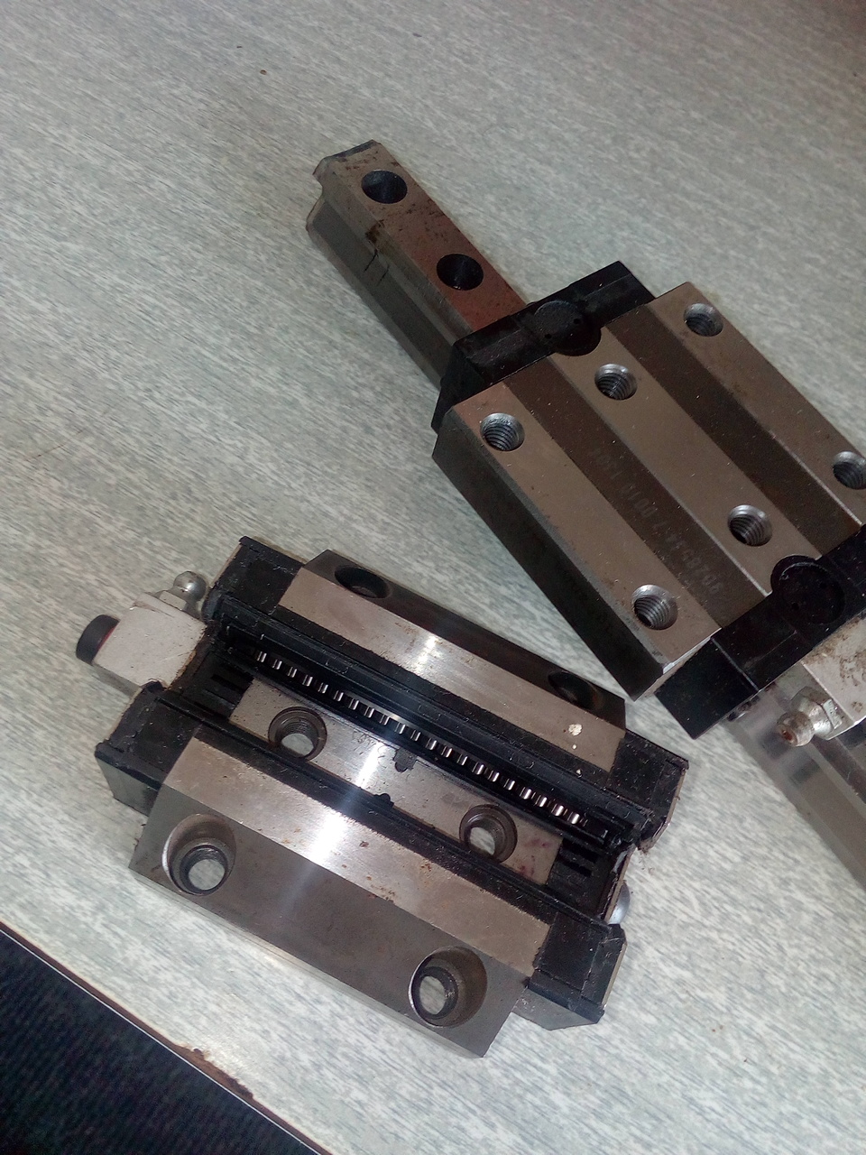

    Hi, I just read the whole thread from the beginning amazing work but I have one question where did you get your rails?
    these are my carriages, look familiar lol trying to source the rail. Looking at yours I think I have the baby version (20mm rail)

    Thanks. They look to be Bosch or Rosa. I can put you in touch with my supplier, he deals in 2nd hand stuff and may be able to source for you. Let me know.

    Looking very very good ;) I just love CNC machined aluminum it's like a work of art all on it's own!
    I hadn't appreciated how big your ballscrews were lol! How big are your rails? I'm guessing 35mm+
    I hadn't appreciated how big your ballscrews were lol! How big are your rails? I'm guessing 25mm+
    My rails are 40 and if I recall 35 for the smaller ones.
    The ballscrews are 40 and 25 from memory.
    LOL you beat me to it I meant to write 35mm by the time I edited it you already posted lol, looking at the pic of your hand against them damn they're big.
    If you don't mind me asking how much were the ballscrews and rails? I assume they're not cheap lol.

    I need to check, I bought two sets of components from my supplier, I think all in for 4 x 1180mm 45 Bosch rails plus carts plus around 6 different ballscrews (longer length) and 2 shorter length ones plus the a short set of rails and the Rosa ones being used on my Z Axis (700mm) was around €2500 or 3000. Not cheap but the 'list' price on a Bosch 45 Rexroth with rollerbearings and a set of carts is around €1K per set.
    That seems reasonable I was thinking it would be even more! Amazing how being into cnc changes your perspective of reasonable lol.
    So glad I only want to do aluminium and wood. This is definitely the most interesting (Read loony toons) cnc build I've ever seen if only for it's grandeur.
