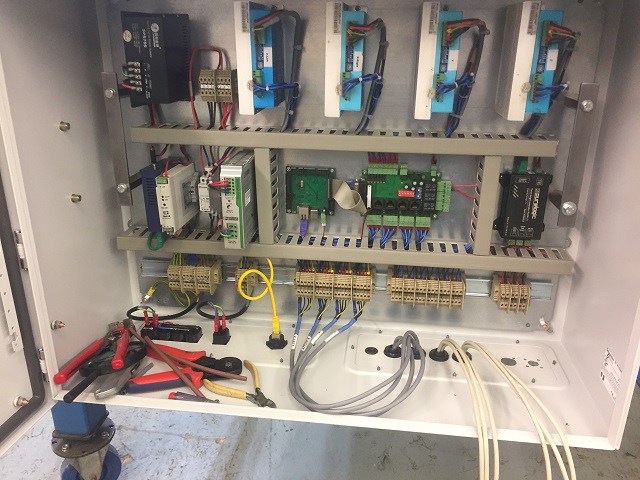

    SY in the 4 core / 6 core / 0.75 mm CSA and 1.0. mm CSA sizes works fine for me in energy chain on my CNC Plasma
    Here it is being installed:

    Chas As Andrew has stated. Here is a link to see the difference http://www.control-cables.co.uk/. But if you are ordering you can get 3 core 0.5mm will be fine as there is hardly any current to worry about in limit and signal circuits. Everybody will have their own opinion of course but these have been tried and tested by many.
