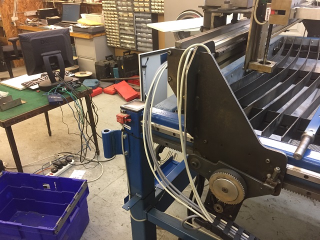

  10. #319
    SY in the 4 core / 6 core / 0.75 mm CSA and 1.0. mm CSA sizes works fine for me in energy chain on my CNC Plasma
    Here it is being installed:
