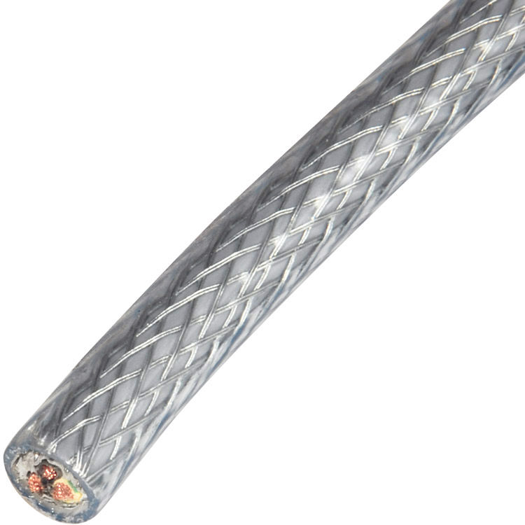

    SY in the 4 core / 6 core / 0.75 mm CSA and 1.0. mm CSA sizes works fine for me in energy chain on my CNC Plasma

    This is what I know as SY cable Click image for larger version.
ID:	21878 metal braided armoured cable it really doesn't bend much.
    This is not what's in your energy chain is it?
