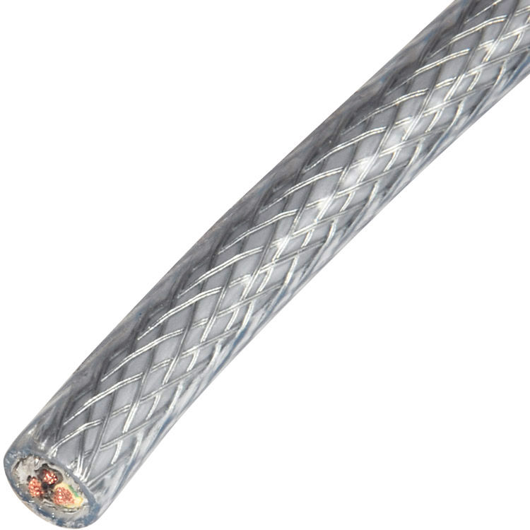

    Quote Originally Posted by AndrewMawson View Post
    SY in the 4 core / 6 core / 0.75 mm CSA and 1.0. mm CSA sizes works fine for me in energy chain on my CNC Plasma
    Here it is being installed:
    Attachment 21875
    Attachment 21876
    Attachment 21877
    That's a lovely machine I'm interested in why the z ballscrew/lead screw is so big?
    This is what I know as SY cable Click image for larger version.
ID:	21878 metal braided armoured cable it really doesn't bend much.
    This is not what's in your energy chain is it?
