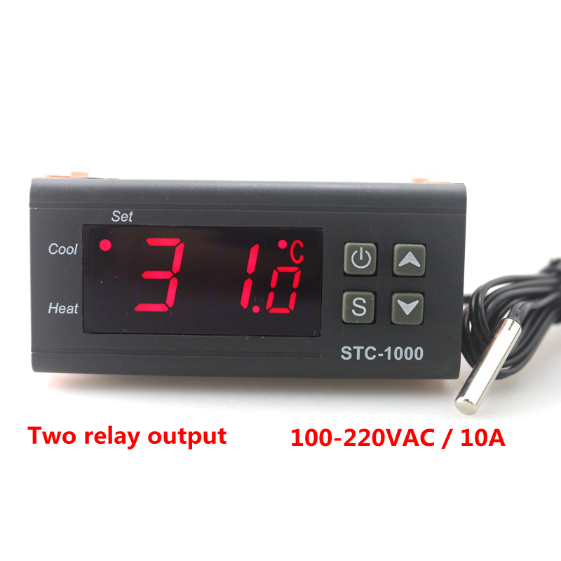

    I would add a 2nd pump to circulate through the spindle then hook the chiller to a thermostat like this
Name:	Two-Relay-Output-LED-font-b-Digital-b-font-Temperature-Controller-font-b-Thermostat-b-font.jpg
    A pond style water pump will work fine I have a box of 20 of them I can send you one for free if you want and will use less electricity than the pump in the chiller.
    With a reasonable size res of 20l's the chiller will only need to run a few minutes in an hour and I bet that water pump in the chiller uses quite a bit of juice.
