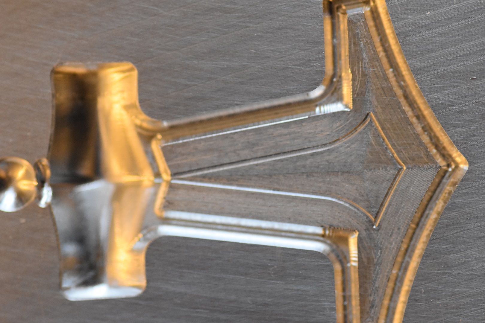

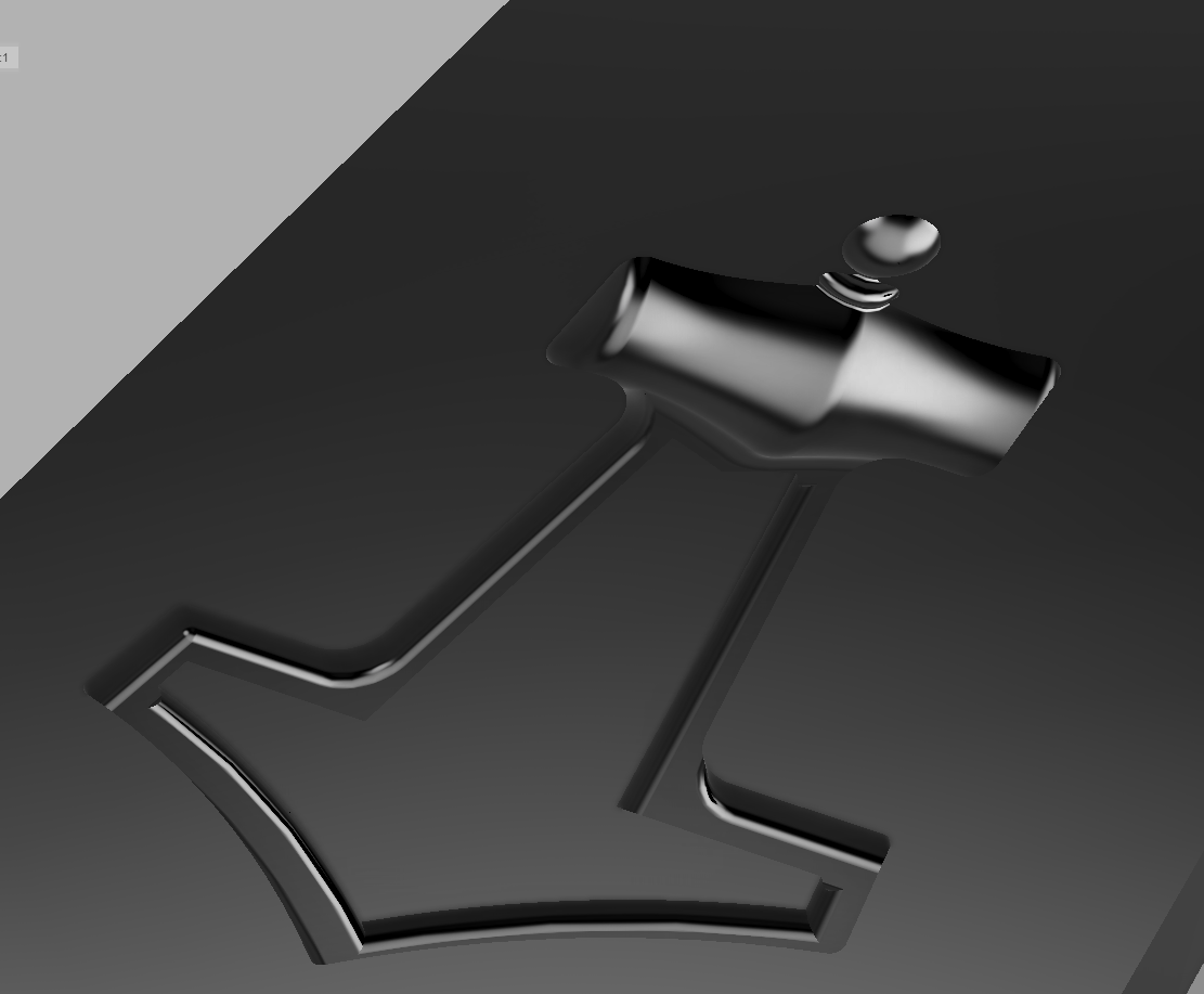

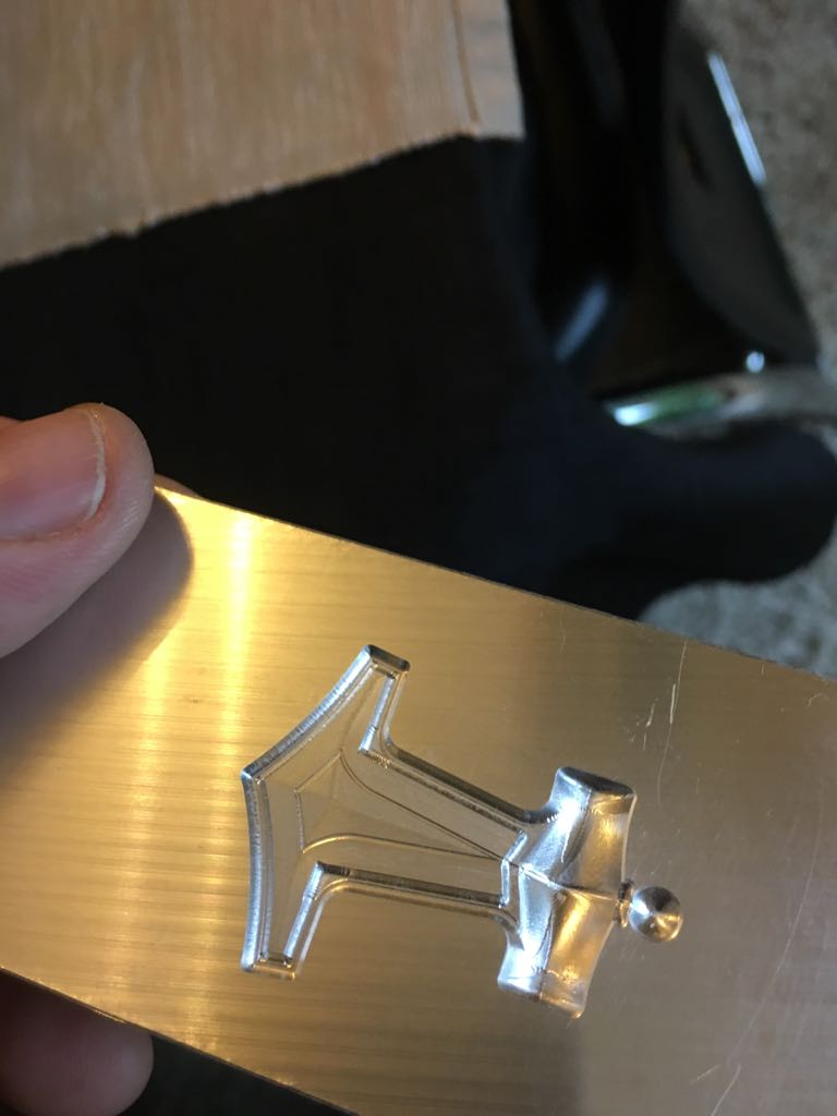

    So Ive finally gotten around to doing something 3D. Took Thor's hammer (Mjolnir) and then cut in half and milled it out. Looks like an anchor unfortunately.
    However .....
    1.5mm ballend mill, 24K RPM, 0.1mm stepover, scallop operation in Fusion 360, around 25 mins.
    Normal camera pic and then two high res macro pics to show warts and all. From the naked eye the part looks good. Polishing / Finishing will improve it even further.

    Thanks for taking the time to take and share the macro shots, its nice to see exactly what the finish is like from different machines.
