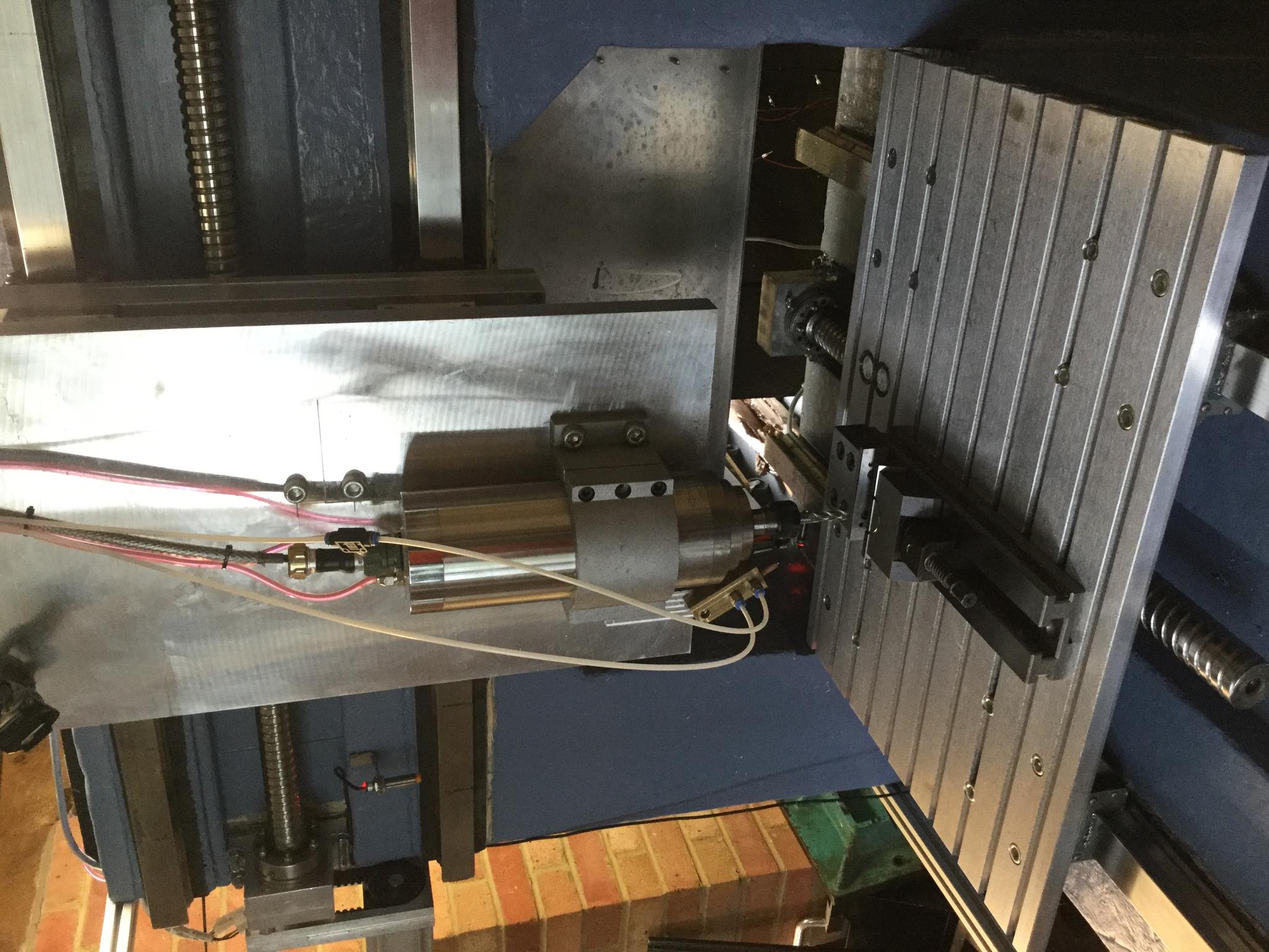

    Yea I was going to suggest the RapidTurn unit to you as I also follow Cliffs channel, I would imagine your best bet would be to use some real hard stops you can then "bump" into for locating, as you say implementation on Thor is tricky because you dont want those fixtures to get in the way for other jobs.
    Thanks for taking the time to take and share the macro shots, its nice to see exactly what the finish is like from different machines.
    No problem, Ill do more of it as I do more machining and work out the good / bad / ugly of the machine's ability.
    The macro shot makes the part look fairly horrible however in reality, its not. Its 'as it comes' and can easily be polished up.

    Some update pics of Thor. Need to finish the enclosure and 4th axis / lathe setup.Click image for larger version.
