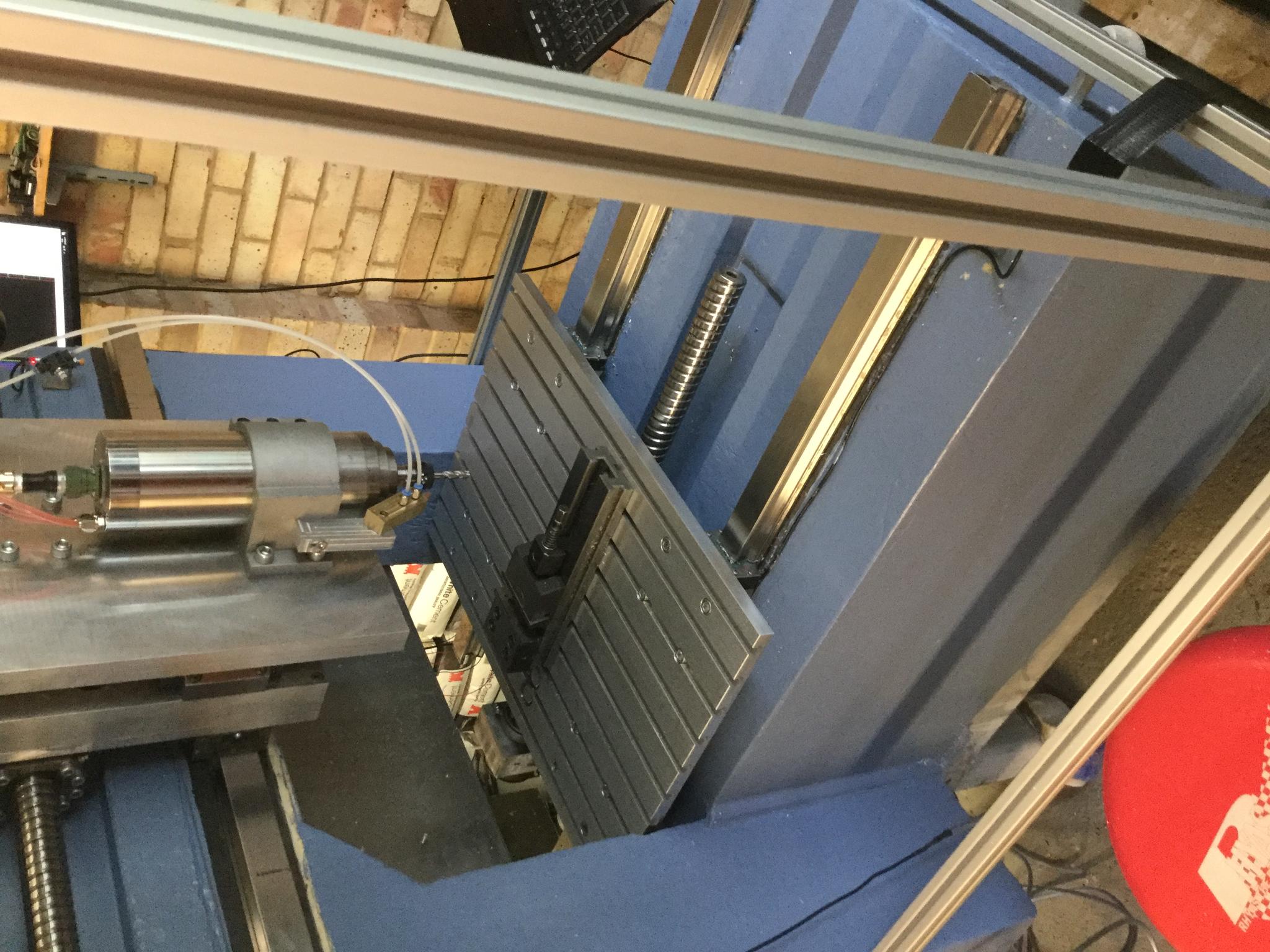

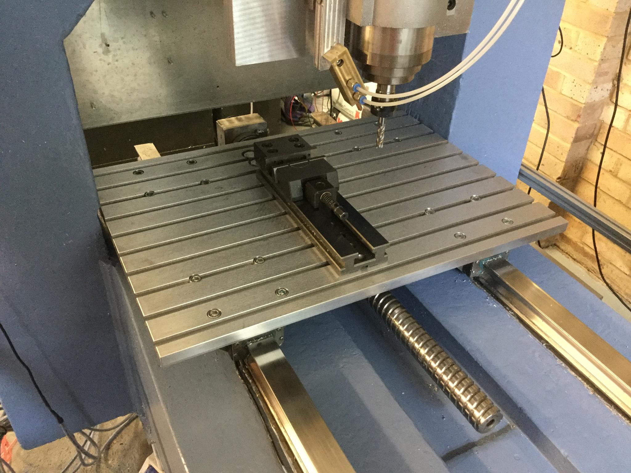

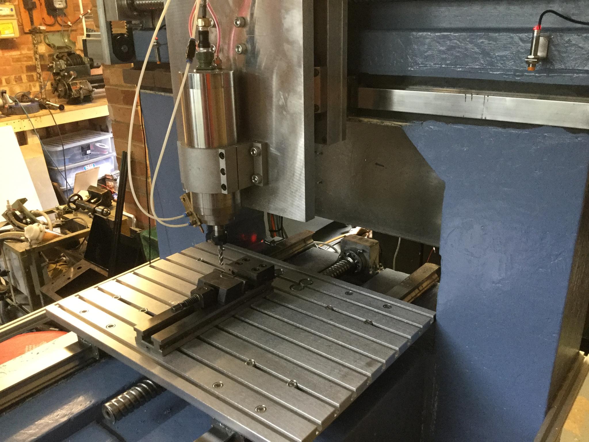

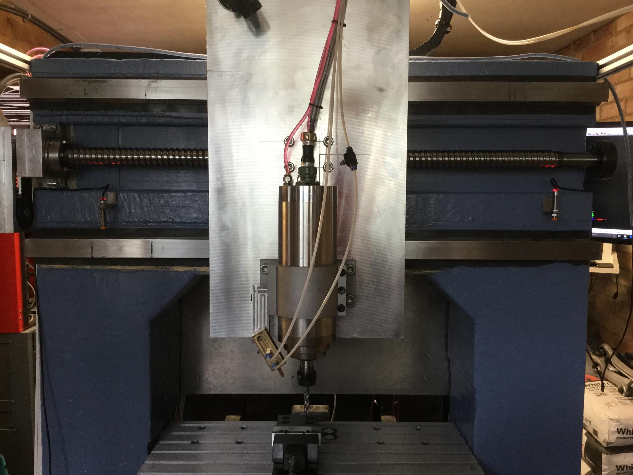

    Some update pics of Thor. Need to finish the enclosure and 4th axis / lathe setup.Click image for larger version.
ID:	22346Click image for larger version.
ID:	22347Click image for larger version.
ID:	22348Click image for larger version.
ID:	22349Click image for larger version.
ID:	22350Click image for larger version.
