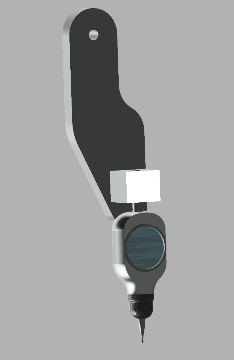

    So Ive bit the bullet and bought a 'proper' probe. Its mechanical, not electrical and I want to make an arm for it like the Datron has that comes down, probes and I can then move it back in the 'up' position when not needed. Thinking to use some form of offsets to make this work.
    How do I manage with an arm to rotate 180 degrees? Arduino Uno and servo? Id need a fairly strong servo me thinks ....
    Thoughts?

    Do you think it is possible to rotate about a hole/pin and get the repeatability ? How about sliding the arm up and down with a piece of spring steel to hold it against a ground edge? Could have a slot in the middle with a fixed dowel pin to give top and bottom end stops. Then add detents for top and bottom position. Manually move it up and down as required or drive it via a motor with a cam?
    Well, I'm bad with this type of thinking. Datron have this on their machines (it pivots 180 down), so there must be a way but im not against it going up / down instead, anything I can look at on Youtube for inspiration?
