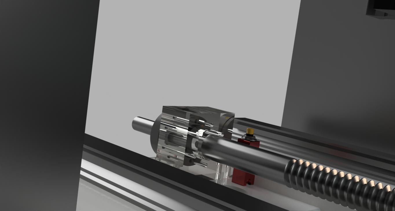

    Some update after a long absence (and winter).
    Gantry is now epoxied to the main structure. Waiting for the epoxy to harden fully before taking away the jacks / hoist to see if it holds the estimated 700 kg gantry.
    Busy drawing up the proxy mount parts and did some testing with them.
    Id like to add limit switches, can I use proxy switches in series or best to go mechanical for these? I want to use all in series going to a single input in CS Labs / Mach 3.

    So, an update.
    I managed to epoxy the gantry to the main body. Scary stuff this. Will some 'glue' hold an estimated 750 kg weight? Seem it does.
    Next step was to rotate the mass and remove the table as I needed access to the rails.
    Ignore the loose rails in the middle of the lower part.
    I then, with a lot of effort, lift my 300 kg 'reference' onto the rails, align and mount so that I can use this to get the epoxy set against the gantry.
    The nett result is that I have something that moves forwards and backwards that is aligned to the bottom rails and should therefore be square once moulded. I should be doing the epoxy pouring this weekend.
